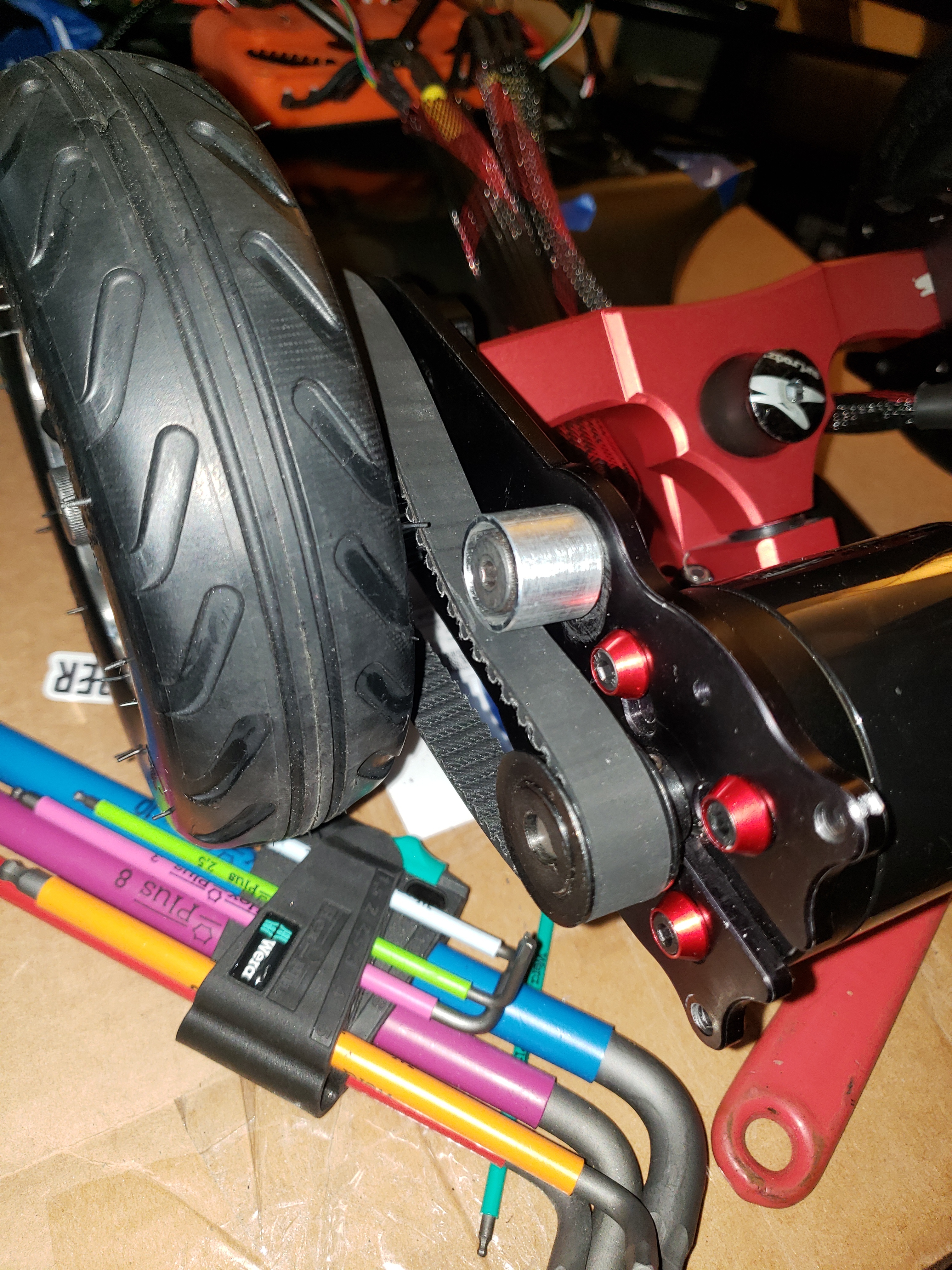

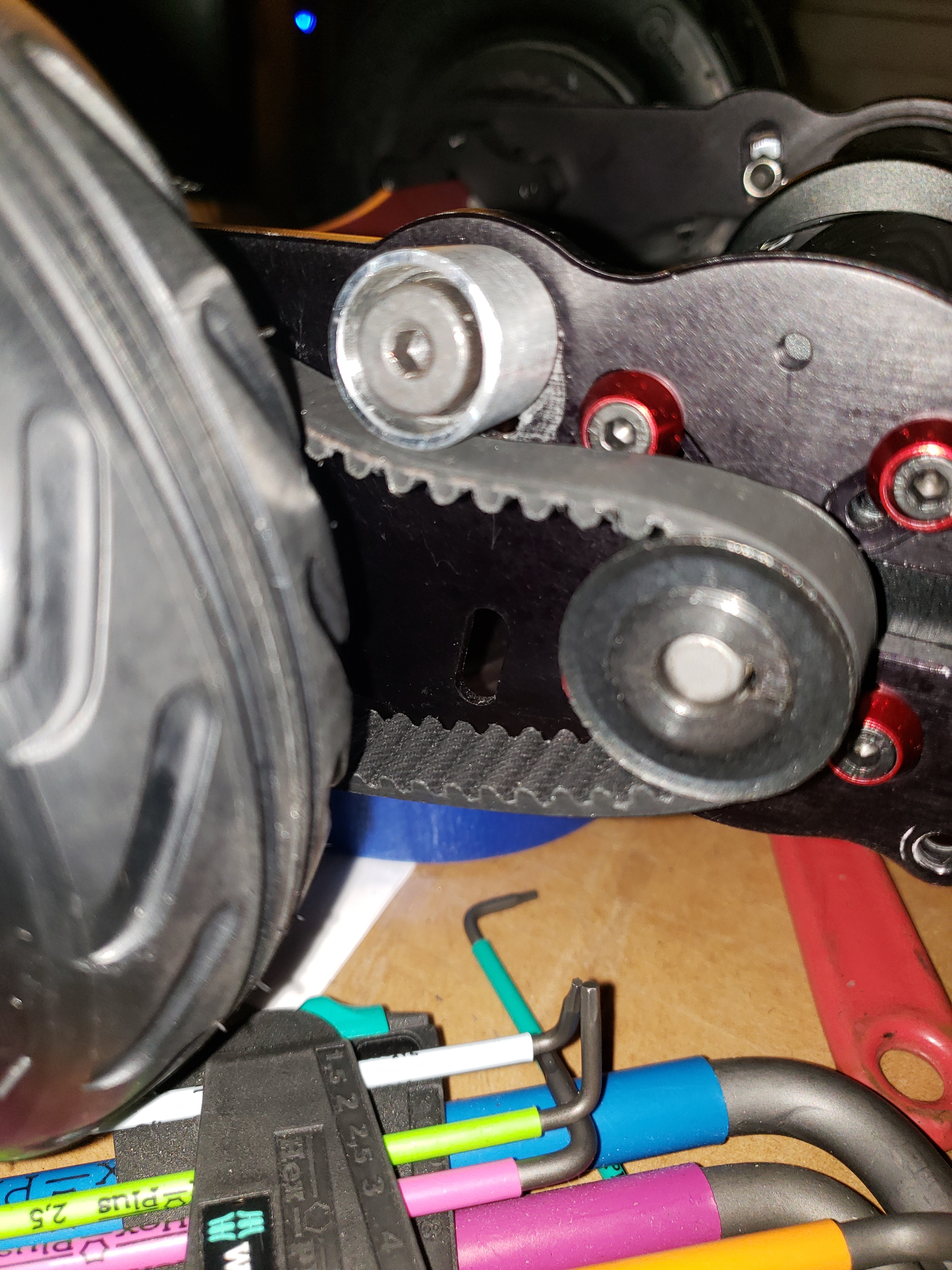

Got my belts now I have to play the alighnment game. Center pulley to center pulley is like 111mm is that bad. I read its suppose to be like 60mm.
Belts way too lose and the angle of the belt to idler is off. Maybe picture angles but looks wrong.
The idea of an idler bearing is to make more teeth on the pulleys engage in a normal rotation so that idler needs to move down from its position. Alignment is not a drama if you make sure that both pulleys have the exact same clearance from the motor plate. By that I mean that the teeth not the shoulder on both pulleys are the same distance from the flat plane of the plate. I use 2mm as a benchmark but I reverse my shoulder pulleys to make it easier to judge. Basically the thicker side out on the motor pulley.
You often tell if a belt is aligned properly by rolling the wheel forwards with your hand about 10 turns – then rolling the wheel backwards with your hand about 10 turns – then rolling the wheel forwards with your hand about 10 turns. If the belt moves left or right depending on the direction you spin it, it’s probably not aligned perfectly. If it moves to the same spot regardless of direction, it’s probably perfectly aligned – or off by a lot. It doesn’t need to be perfectly aligned, but it helps.
I take the speed washers off the inside of the wheel bearings then mount the motor plate so it’s flush up against the wheel pulley and touching it. Once you get the motor plate secured in the right place, and straight with the pulley, then just take the wheel off and add a single 1mm speed washer for clearance.
Ok, thx. That helped with my belt size problem as well.
Lol, oh yeah Have not tightened things up yet. Thx
