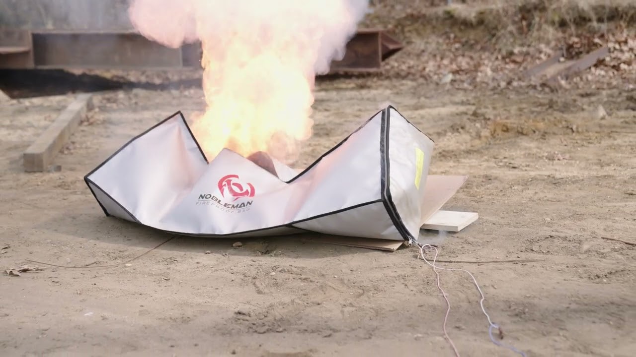

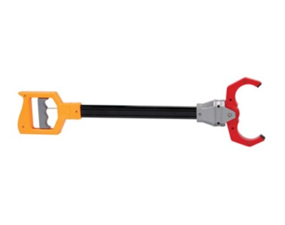

If a fire broke out what would y’all do? I know a extinguisher is pretty useless except for the things in the surrounding area and that I should pretty much let it burn out. I’m thinking a fire blanket might help to isolate it and maybe a pole to be able to pull the board out of the house, thoughts?
I was going to say, my first thought is getting it out of the house. A pole with some type of grabber makes sense. Otherwise, definitely a fire extinguisher to prevent the spread… I like your fire blanket idea too. Might be able to cover it and drag it outside in a pinch.
Problem solved
I was thinking some sort of metal pole and a wired coat hangar. I already have the grab handle so should be able to pull it pretty easily. Yeah blanket to cover and contain the flame. Downside to the blanket is that it keeps the heat in, and I’ve read with these types of fires trying to cool it down as fast as possible is key. Maybe pull it off once isolated outside?
