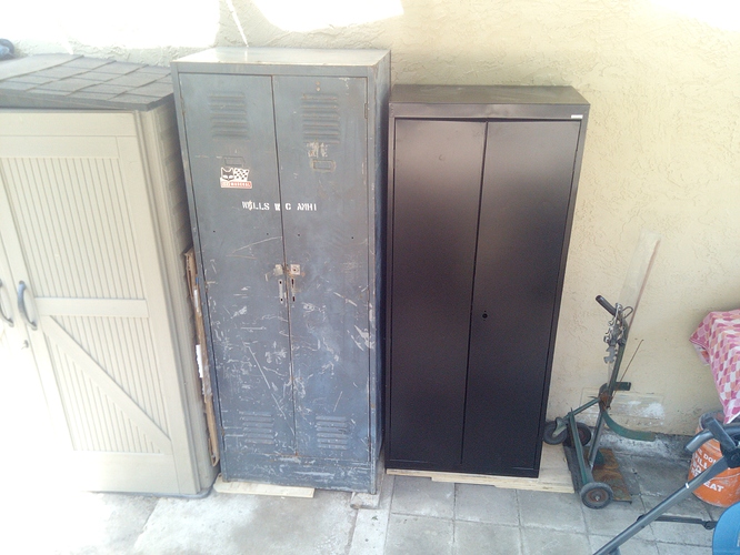

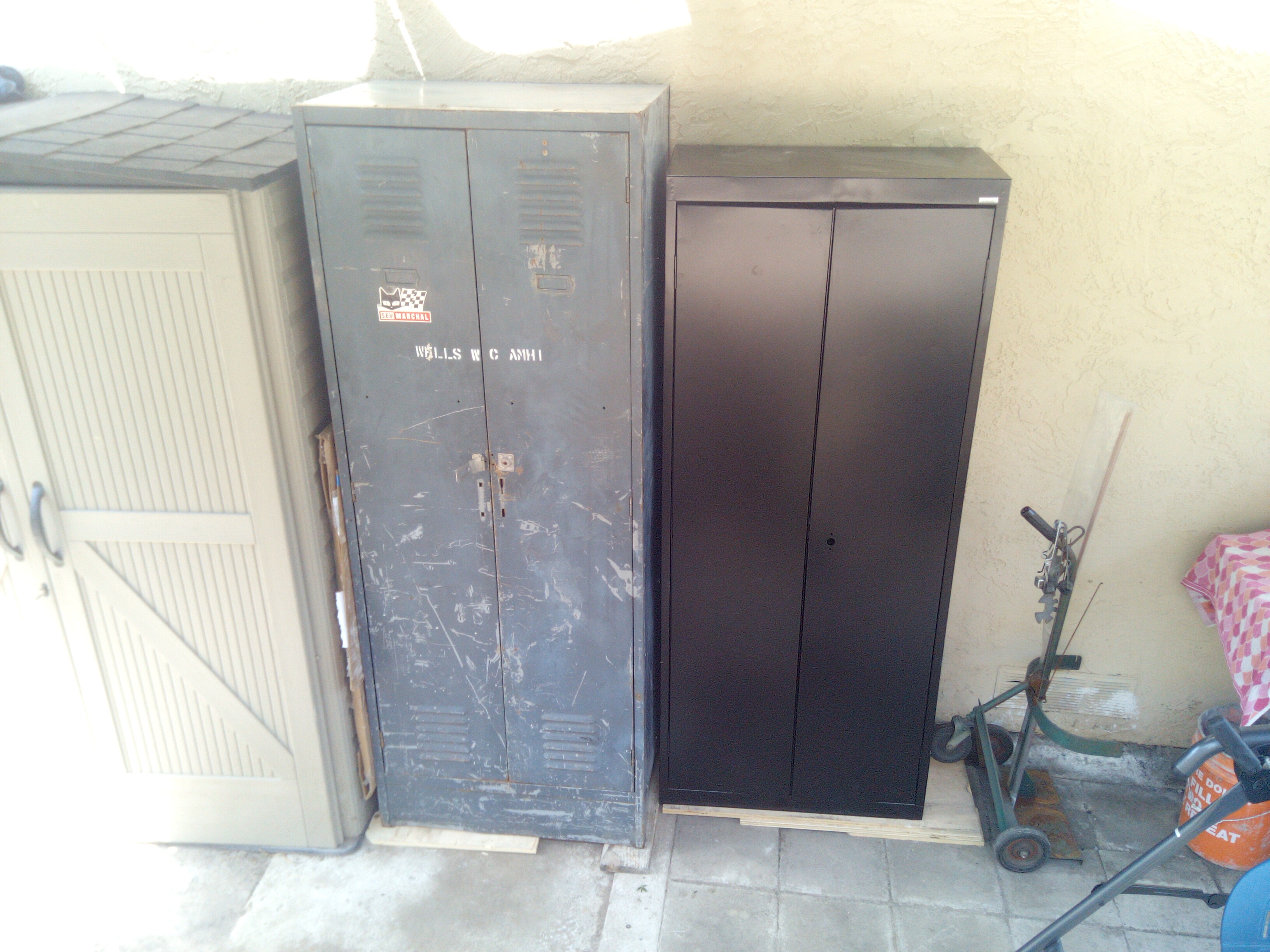

I worry that if one thing catches fire, all my expensive toys will burn. Better than the whole house I suppose…
Exactly this for me. The value of my house and family far outweigh whatever toys I can stuff into even the biggest locker. I will do my best to isolate with drywall panels and such to slow the spread of a fire, but it will be outside in any case.

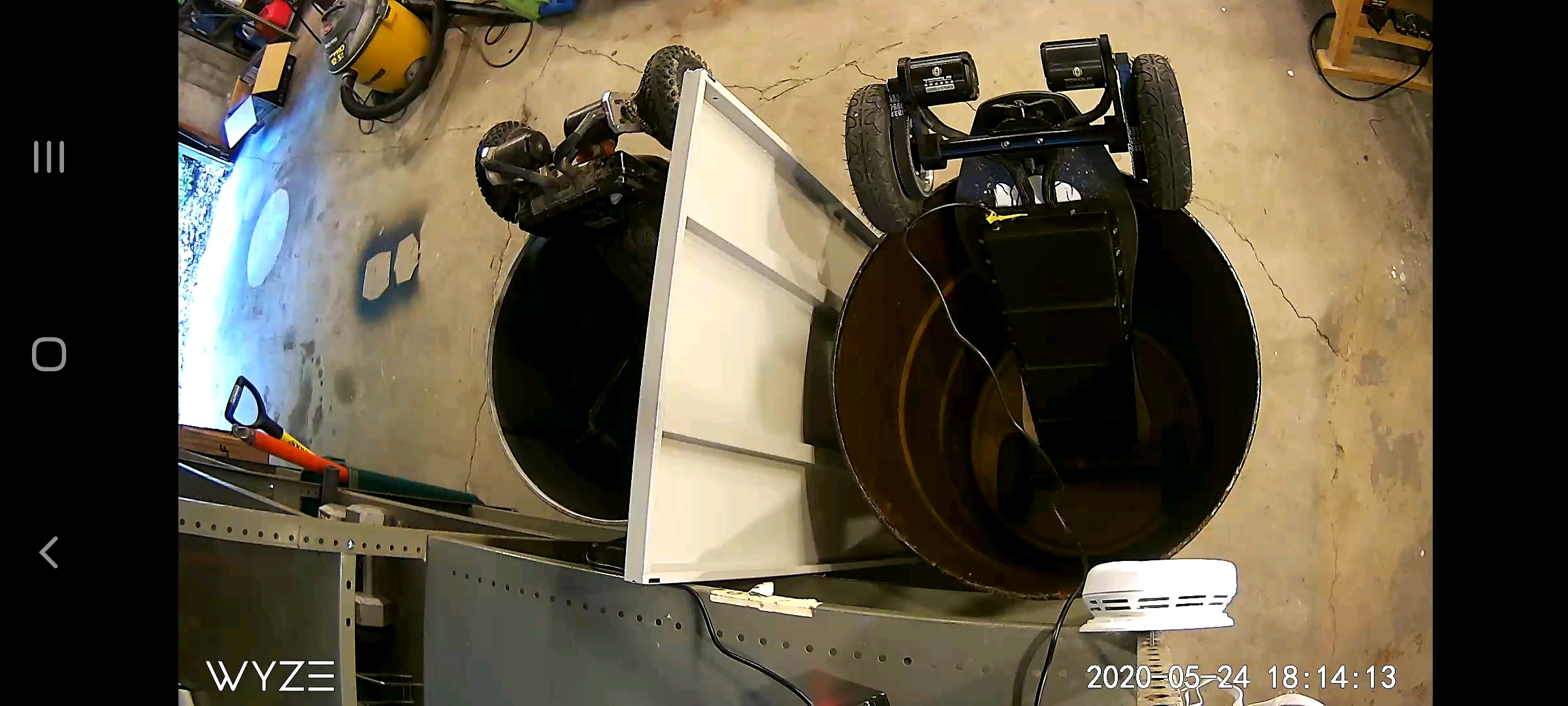

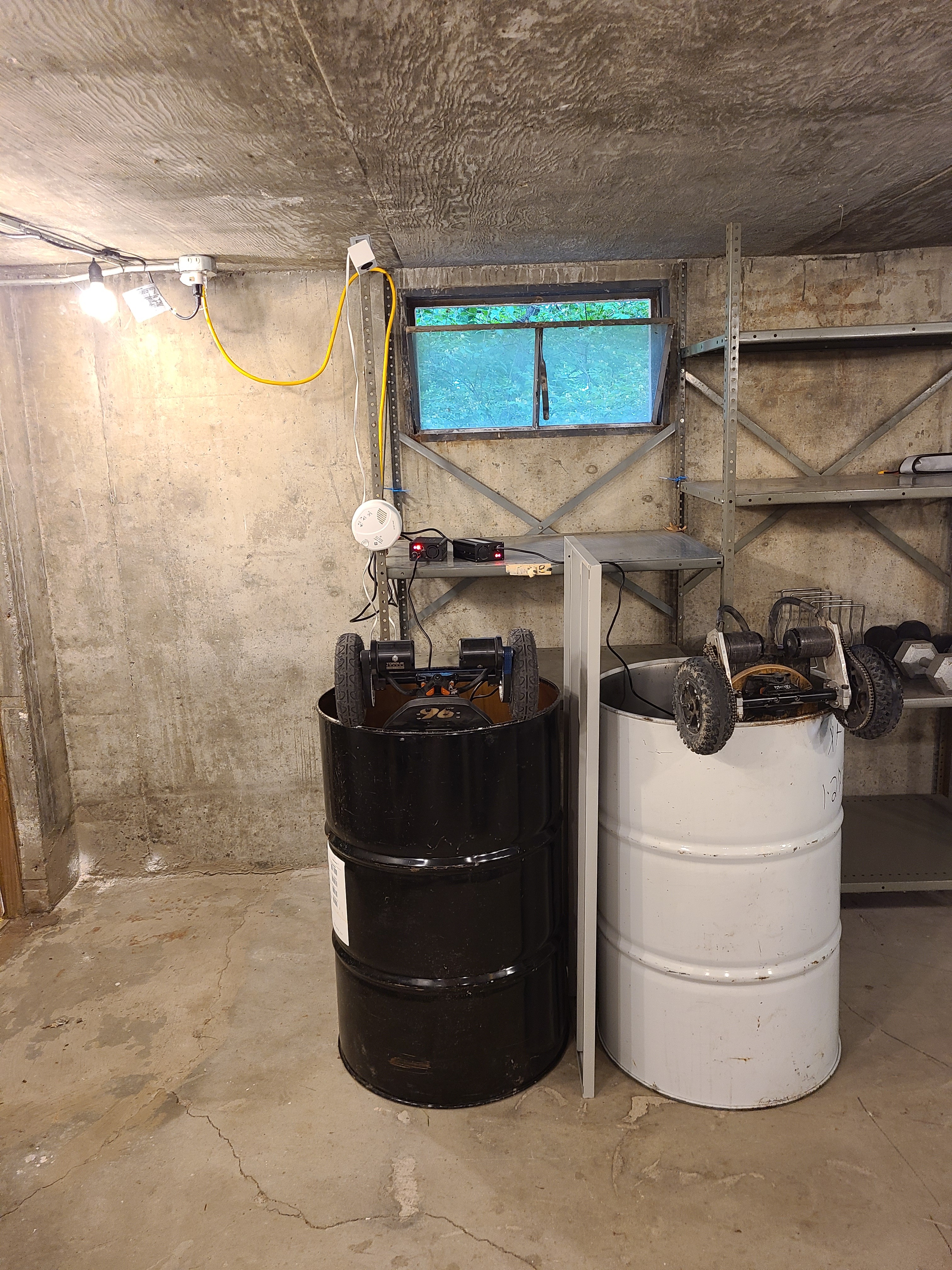

I got the drums cleaned up and moved a bunch of crap out of the way so my charging station looks pretty good.
I ordered a second smaller metal cabinet just for storage.
I plan on ordering a bunch of 5/8 drywall to put both inside and outside the storage cabinets. That is going to be a bunch of work…

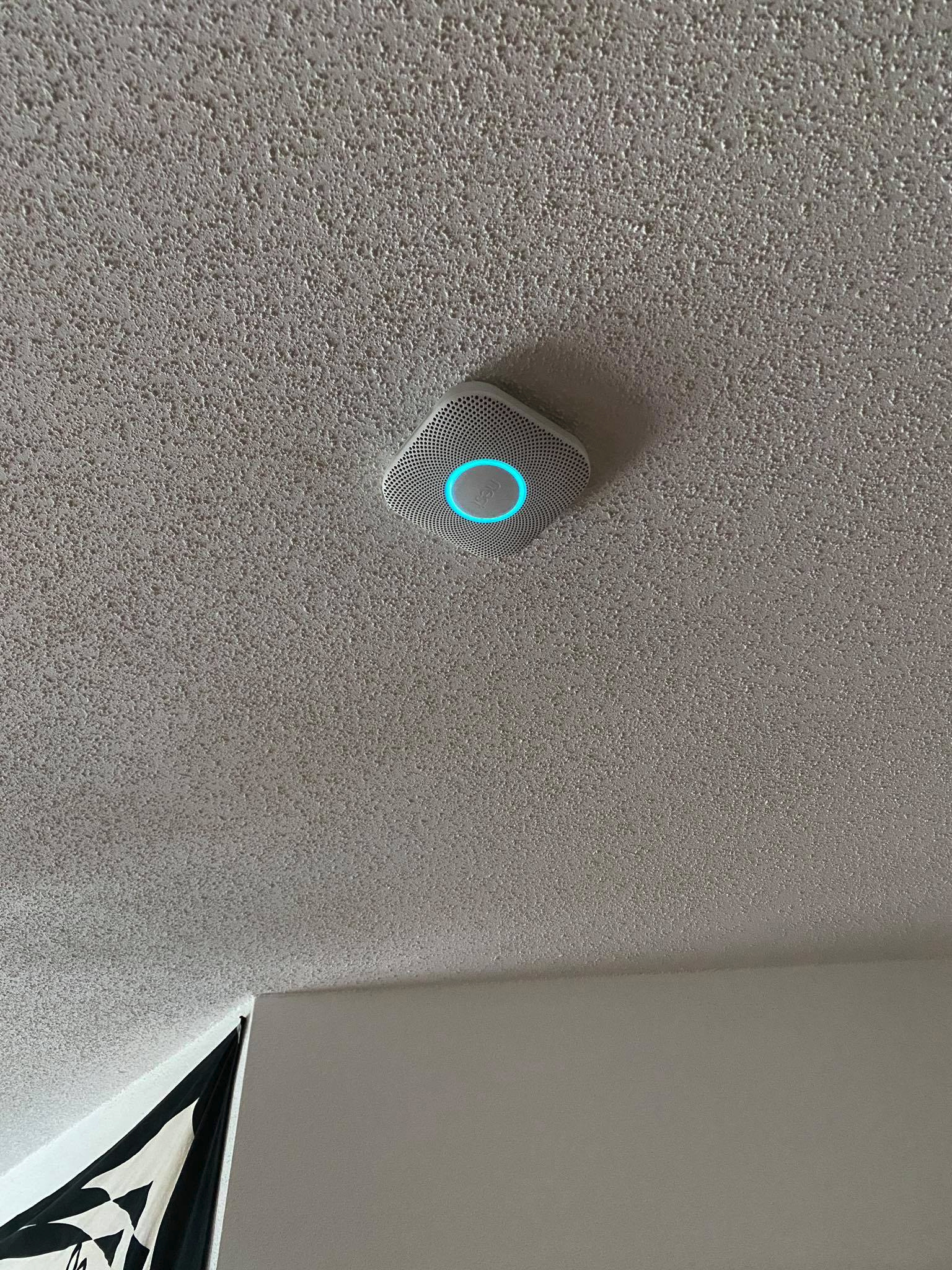

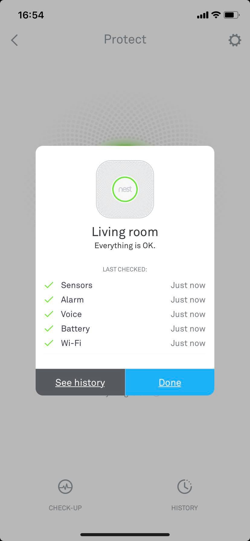

So received and Installed my Google Nest 2 Fire Alarm now… at least a little bit ease of mind when I am on business trips or not at home.

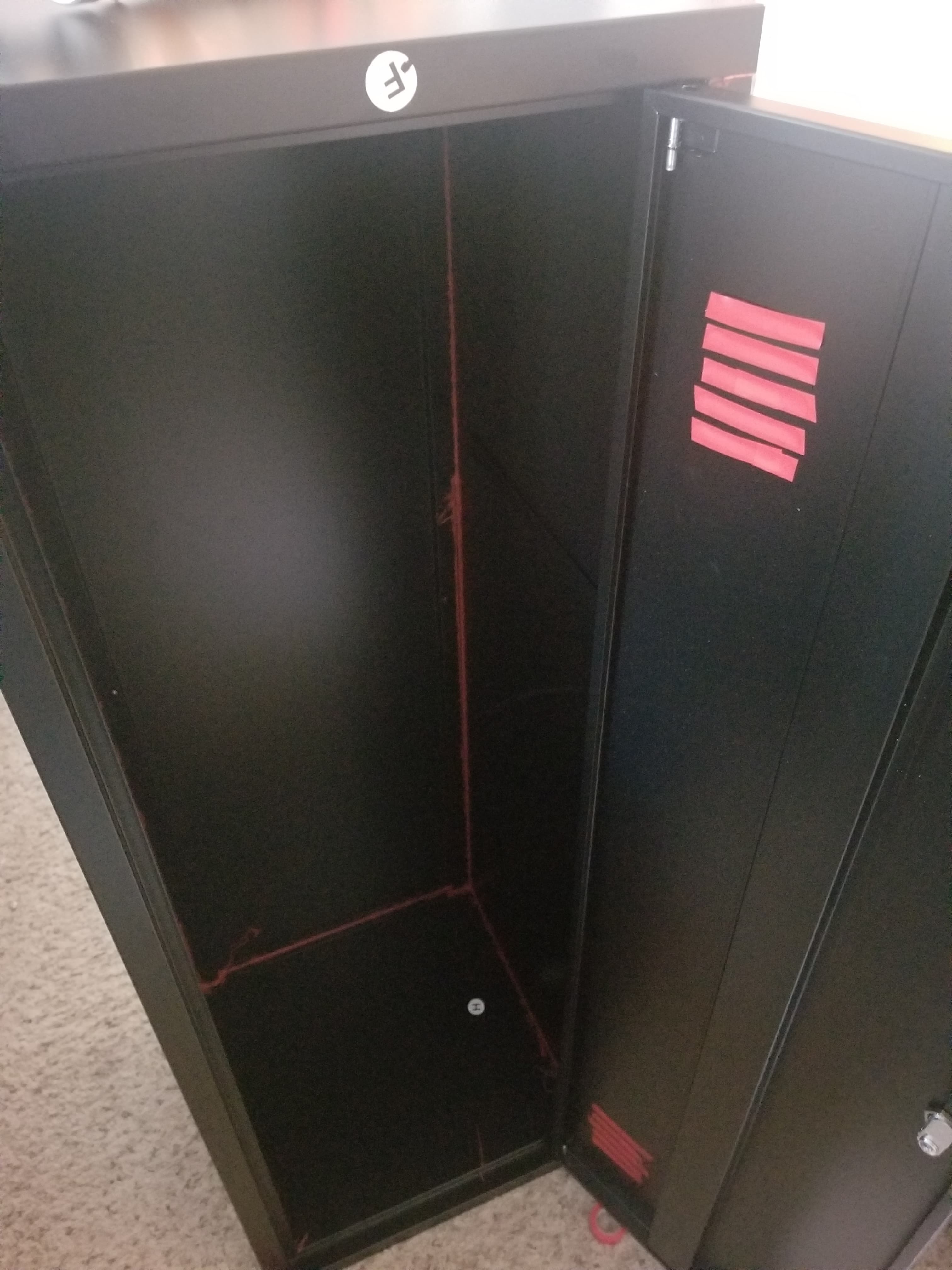

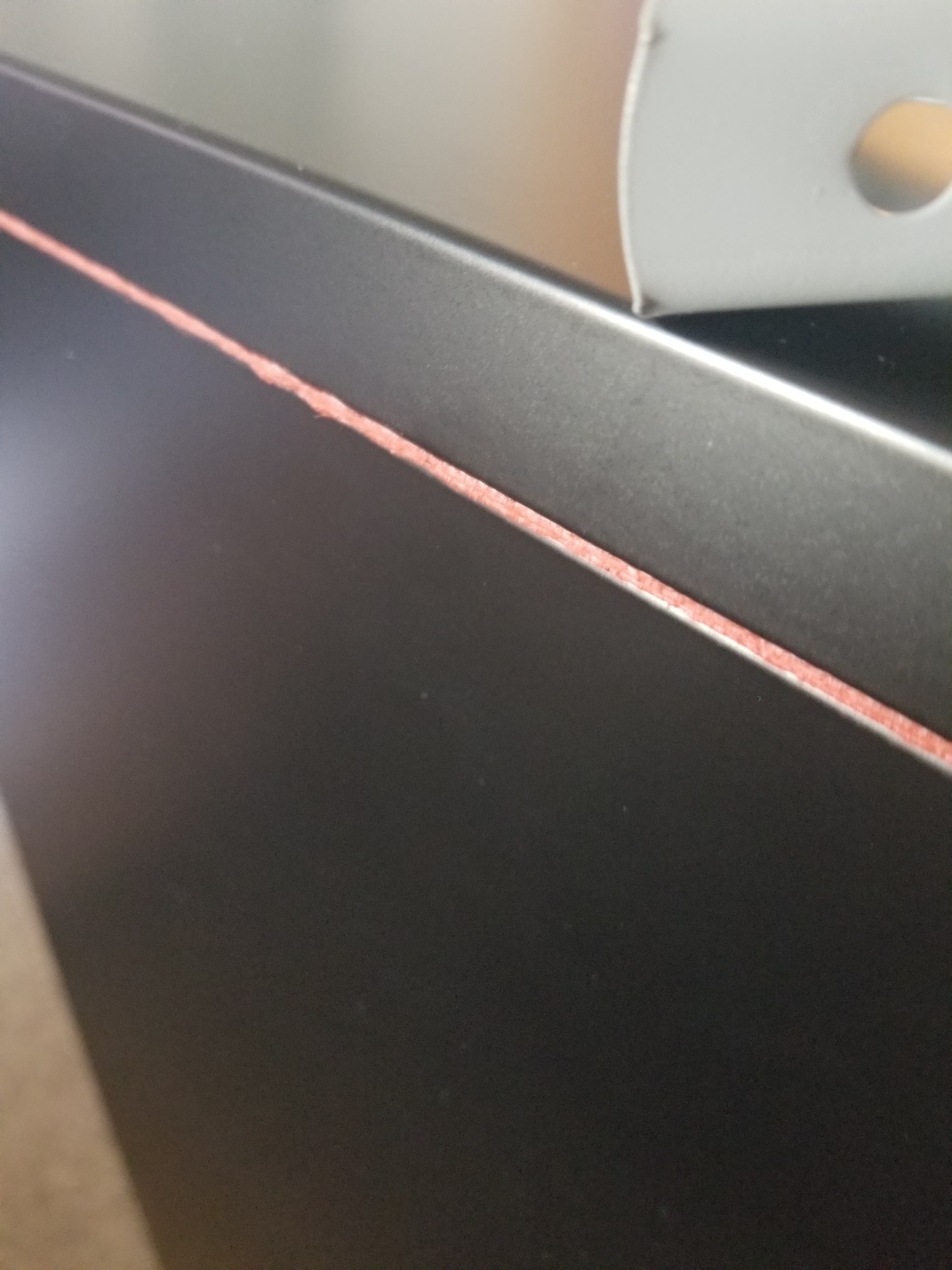

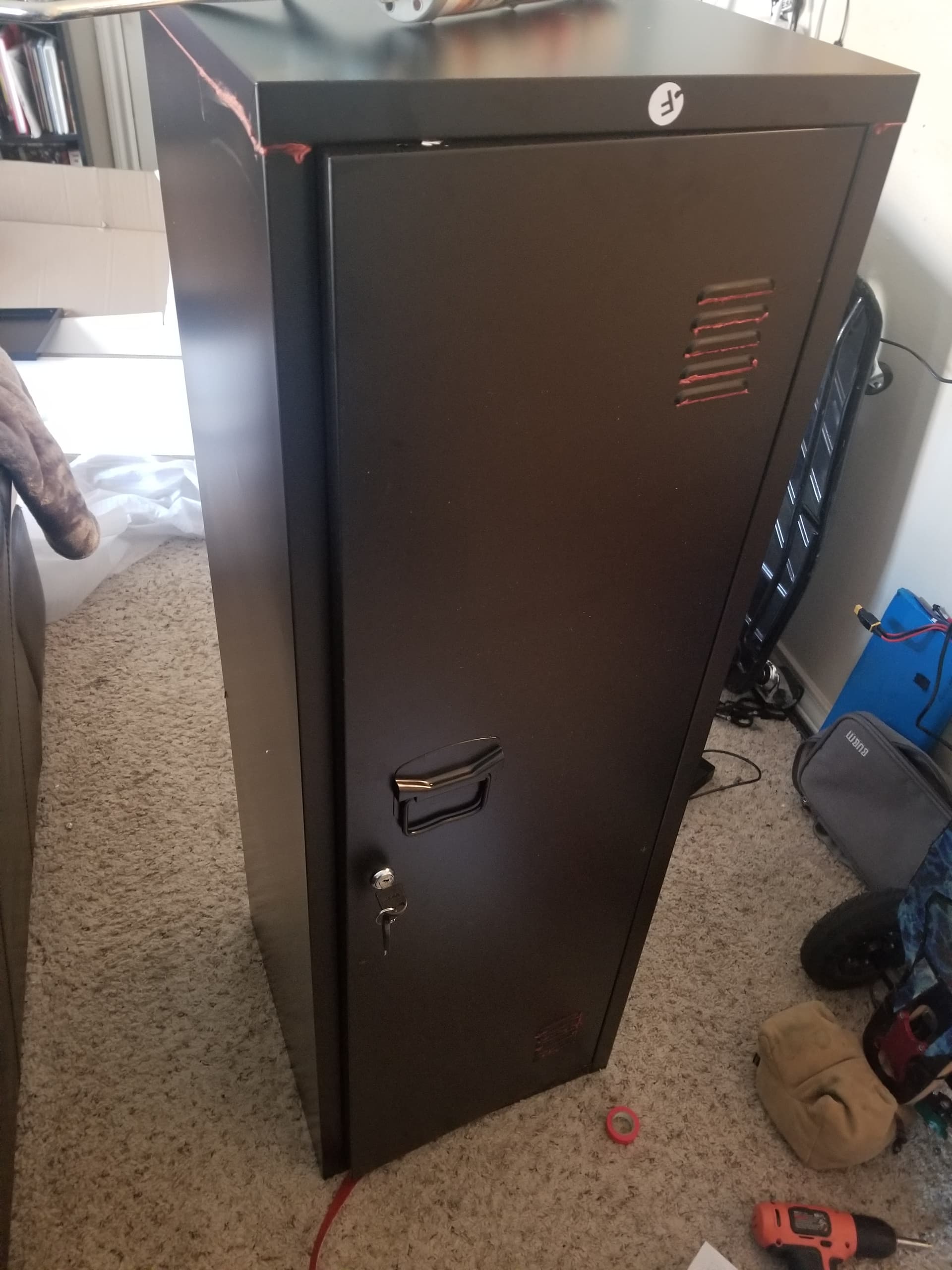

So i wanted a way to storage my boards and be safe from fires. I already got one of the nobleman firebags, but i kinda wanted something i could stand up. So im trying something out. Feel free to tar and feather me if its a terrible idea. I’ll admit, im not a firefighter or a specialist in this area. I’m going off the concept of removing one of the triads from the fire triangle, which is limiting oxygen.
I got this storage locker off of amazon. Its metal and just big enough for my board. After some assembly, i lined the cracks both inside and outside of the locker with 3M fire barrier sealant. For the vents on the door, i placed electrical tape on the inside and filled in the vent from the outside with the sealant. I know, a fire would eat the tape pretty quick which is why i filled the other side with sealant. Next I’ll be putting some sort of weather stripping around the frame of the locker door. Might not be air tight like a ziploc bag but im hoping it severely reduces the air available for a fire. Like breathing through a straw.
I want to be able to charge my board in it and so i was thinking of making a small hole in the side to thread the charge cable only though and line that side with some fire retardant material. Cuz my concern would be the cable burning mid cable and the expose wire would contact the metal sides. Cuz you know, metal is conductive.
This set up was $150ish. Think i saw some similar lockets for around $80. Mind the messiness. Im not exactly a handy man, this was my first time using a sealant gun.
What do y’all think? Good idea, iffy, wtf?
From what I’ve read you can’t really put out lithium power by blocking oxygen inflow. Commercially available fire containers for lithium batteries are not airtight since there’s a risk that during fire pressure will build up inside the container and it may explode. Instead, the containers are made to contain the fire and to filter the fumes.
I think there’s a chance your container will contain the fire should there be one but I would be careful with the sealant.
Ya the thought of pressure build up did cross my mind too.
I just had a quick look on the topic again and, as I understand, the problem is that even if you make the container airtight it will still contain oxygen initially. If there’s a short circuit that causes fire, it will have some oxygen to feed on and the pressure may go too high before the oxygen runs out.
At any rate, when I researched this topic some time back, none of the commercially available containers I found was airtight, so there’s probably a good reason for that.
