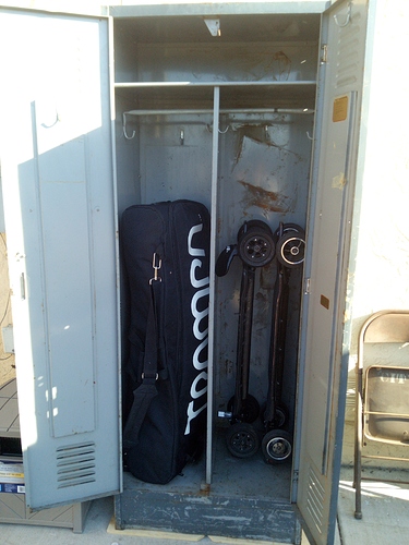

I started hunting around on Craigslist and OfferUp and found a few steel storage cabinets and lockers. I ended up with this one, fits my boards, pads, helmets AND charging gear. Spent half of what I spent just on nickel so far this year. I’m gonna line it with drywall a la @Andy87 and live happily ever after (again).

Are you going to keep that outside? Cause with that socal heat you might cook your stuff…
It’ll be in the shade👍
(more importantly, it’ll be outside)
Yep.
Im now trying to calculate how much drywall I need and dreading dragging the 70lbs sheets to my basement…
Definitely seems like a good addition to my metal cabinet.
