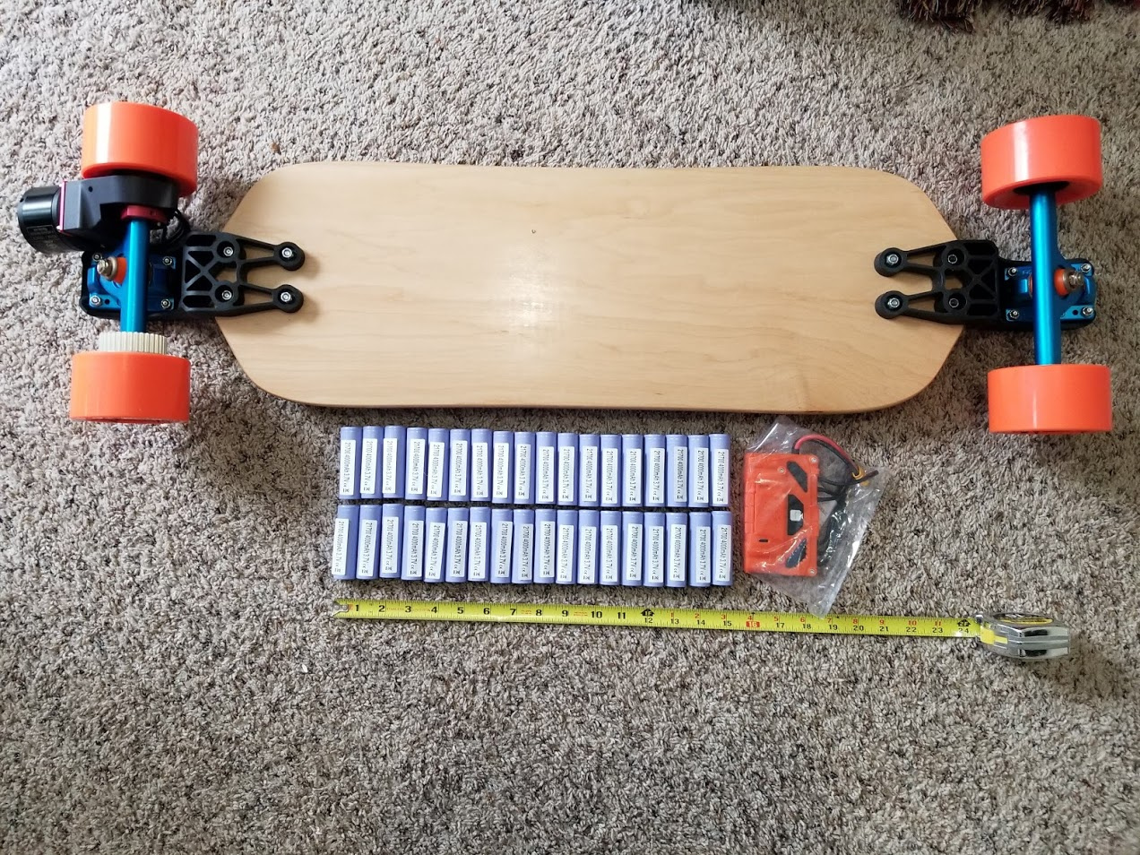

I already purchased the 40t cells and the largest 12s battery I can fit is 12s3p. I was originally going to do a perpendicular flat pack like the pic below but then I would have to stack the BMS on top of the battery or under the Unity. The board is already really low to the ground so I didn’t want to add any extra height and I didn’t want to have too much heat so I went with this design.

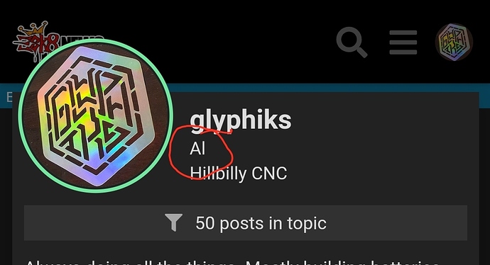

What protective gear do you wear when working with that stuff?is there a special kind of respirator to use?
Protect your skin, always use in a well ventilated area and use a mask like this.
The clue is in my profile picture.
Thanks I have been thinking about buying a good mask. I bought a cheap one and one of those RZ masks for dust but I feel like when I do stuff like spray paint or lacquer the fumes get through
Shave well and replace these every month. Work like a charm.
