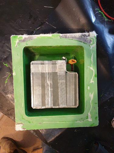

Kinda hard to see
Man that thing is too big!!! Said no one ever :joy:
Its not that big.
10s6p fits in there nicely with a bit of wiggle room.

If I want to make my fiberglass enclosure have some flex, how many layers, what type of fiberglass cloth, and what type of resin would you guys recommend?
It totally depends on the design of your enclosure and the materials you use.
And for the most part, it comes down to practice, patience, mistakes and experience. Can’t really comment on the flexibility part because i haven’t used anything that I’ve made for long enough to determine it’s durability.
@BigBen or @eBoosted may be able to better comment on a good recipe for a flex enclosure, but it would help to see a picture of your rough idea of what the enclosure is going to look like.
The enclosure design will be fairly standard with a dimension of 21"x9". The deck has both camber and concave and I would like the enclosure to follow that camber and concave. The battery is able to flex laterally and longitudinally so that it follows the concave and camber of the deck. I don’t think I will be able to get the concave and camber of the enclosure right if I use a foam mold so I’m considering using the battery+putty for the mold or shaping a piece of wood. Unfortunately I don’t have a vacuum bag and I don’t want to spend for one when I will only use it once. I’m thinking fiberglass because it follows the shape of the mold really well and will allow me to get a perfect seal. I just need to figure out what cloth and resin to use.
If i were you I would make a timber buck like you suggested and use 200gsm cloth, 2-3 layers of 450-600gsm woven roving, and another layer of 200gsm cloth.
You can see photos of how I shaped a timber buck in this thread Demonseed 44 Enclosure
And use epoxy resin. Polyester stinks
