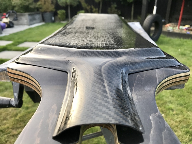

Vac bag time!
Fingers crossed. Got nervous and included a plastic release layer between the layup and the mould. Hopefully that peels off the part.
2/200GSM carbon twill and 2/400GSM biax fibreglass.
Nice bro! Looking forward to the result!
Out of the mould…
Couple of dry spots
Some bubbles and pooling in a few areas
Plastic release layer made de moulding easy but made some small wrinkles in surface finish. Maybe sandable.
Lost quite a lot of crispness of the shape in the vac forming mould I think. Maybe more heat in next vac form and larger radius curves in next plug. Small detail wasn’t well replicated.
Might see how it goes with another layup direct on the styrene mould.

Epoxy didn’t eat the styrene sample did a test on a few days ago. Did a small test with hairspray as release agent (actually seemed to work ok).
Never heard of using hairspray as a release! Don’t think I would risk it tho…
It looks awesome dude! Just touch up the bubbles/dry spots/wrinkles with some more epoxy, sand it back, clear coat and you’ll be golden!
Vac bag just pulls all the layers tight together and helps strength. Supposed to squeeze out excess resin. It’s not difficult to do so will probably do it with that again. Generally the surface finish on the flat parts of it are :ok_hand:

Some sanding done, and clear coat. Gave up the sanding and repairs on a couple of bits. The plastic release layer against the mould caused some areas of the fibre to sit slightly off the mould during layup but then fill with epoxy when I vacuum bagged it. Thick epoxy layer then formed unevenly at those tight corners. No major, try again another time maybe without that release layer. Happy enough with this though. Chur.
You should be happy! It looks sweet as bro!
That looks great. It’s one of those things where to an outsider looks damn near perfect but the creator an point out all the flaws.
