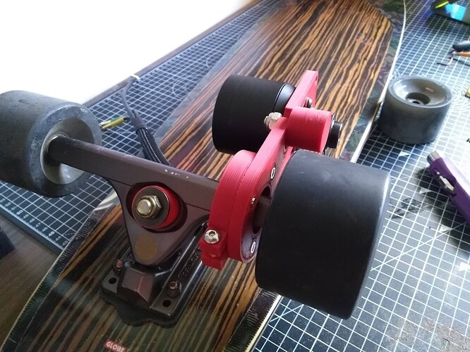

Feedback request for Caliber motor mount
Thoughts?

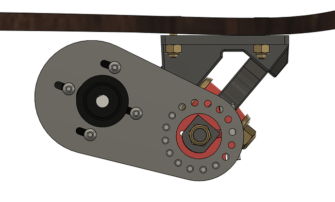

What’s up with the extra deep dogbone on the hanger profile?

Any shallower, and the screw length will need to be increased. Despite the extra material, it wouldn’t have much benefit as there is not enough material to add an extra set of positioning holes. So I figured, keeping everything as contained as possible within the circular boundary is the best and most aesthetically pleasing solution

I mean in the top right corner of the hole for the hanger, only the one side has it
Ah, that’s for strain relief when the clamp is tightened

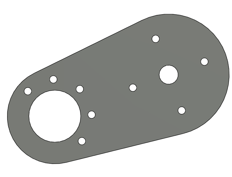

Some motors/circlips need up to 19mm.
Could you provide some examples? Is this common with 63mm motors?
There are a few examples if you search the forums.

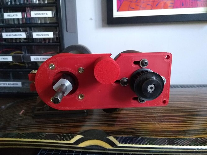

I like the updates. Still need a way to adjust the belt tension though.
I used to be opposed to the idea of idlers, but as I started riding with more power, now I like them… It’s a lot easier to prevent skipping esp during heavy braking. Maybe make a longer idler version for rear mounting, and a shorter regular version for front of truck mounting?
Ah okay I’ll definitely increase the shaft clearance then. I really appreciate your detailed help on this.
Totally forgot to put the tension adjustment back in place, will sort that out haha.

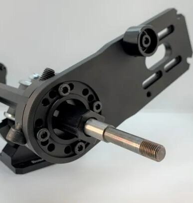

vs
For the clamp - I think the range of adjustments is pretty low with the holes only going part of the way. Seems like they could be added here without much issue?

  • Thickness of the main mount should be at least 8mm IMO.
  • Optional cross braces would be appreciated by many

  • It would likely save you a lot of headache to 3d print some ideas and see how everything installs and fits up before cutting aluminum.

If I add holes there, it will allow the mount to be used in reverse (i.e. facing away from the centre of the board, not sure on the correct esk8 terminology here) but has no effect on the range of motion.
I’m considering reverting back to the BN style adjustable hole positions. Currently, the holes have a 22.5deg spacing. This realistically allows for three positions:
Low
Medium
High
At any further extremes, it would be impractical.
If I was to make the positioning more adjustable, it would mean increasing the diameter of the clamp/using smaller diameter screws/reducing the amount of material between each hole. None of these are really feasible. Increasing the clamp diameter to add a couple of extra positions would make it significantly larger without reducing the angle between holes that much. Using smaller diameter screws (M3) is dangerous, as is reducing the amount of material between holes UNLESS reverting to overlapping holes, which is already tried and tested.

Definitely, I actually printed this prototype before opening the thread with my second revision
