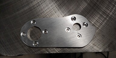

Just get a set of boardnamics idler mounts
20220930_192226

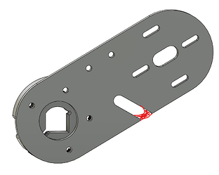

This angers me
That’s my main inspiration for this design. However, at $35 each, with another $35 shipping I figured I’d like to produce my own .
With respect to the corner that angers you, could you explain what is wrong with it? It’s only there due to the way I constructed the slot geometry and is an easy fix.

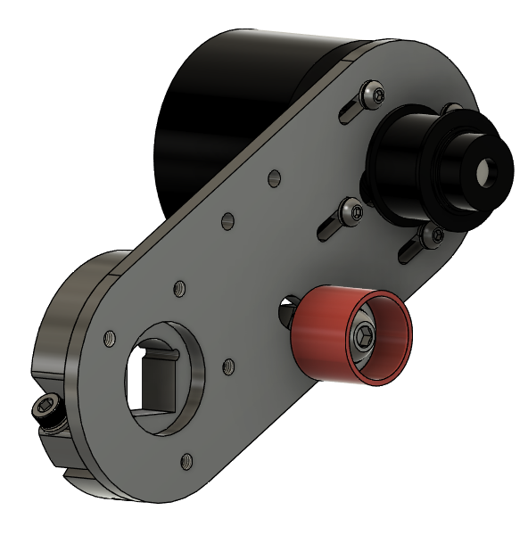

I’ve personally found that with an idler on only one side I get belt skipping when the other side (without the idler) gets engaged. I suggest modifying your design to accept dual idlers in case you experience the same issue.

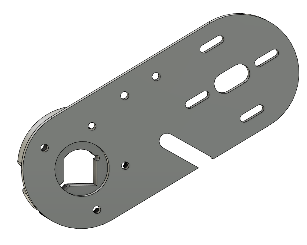

I’d close this up. Adds a lot of strength and does not affect producibility.

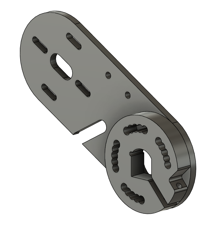

The rest looks pretty standard and doable, although those cross braces won’t do much. I’d move them behind the motors, way more effective there, leverage-wise.

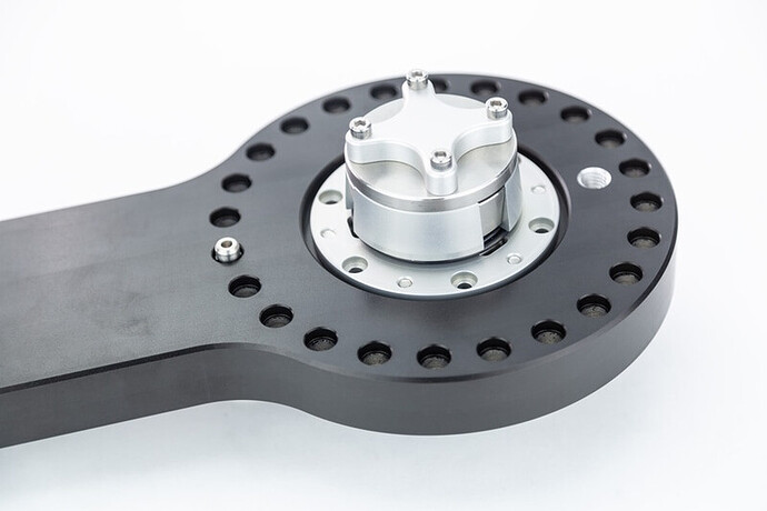

I know BN does the same thing, but I’m not a huge fan of this design
There is a lot of force with an 800g motor on a long lever when hitting big bumps on urethanes at speed. Those closely spaced holes don’t leave a lot of material in the soft aluminum to resist movement.
I think some sort of finger locking design that bolts together would be a lot more secure.

Also it is my solemn opinion that idlers are worthless. They add more rolling resistance and force you to make longer motor mounts to accommodate. Better to have shorter plates for forward mounting and just properly set the belt tension. Shorter mounts leave more room for a larger enclosure :smirk: which means more battery which = more better :call_me_hand:
That’s interesting, the increased engagement on one side reduces engagement on the other?
Thanks for the advice. Originally I had a square end with the cross braces in each corner but it looked odd so I moved them to the centre without really considering the structural effect. W.r.t closing that up, as I’m planning to use 608 bearings with an m8 screw for the idler I’d need to create a “bulge” to ensure enough variation in the position. Not sure if that makes sense? I’ll explore the design a bit more, cheers
Yes.
I would avoid the idlers unless you have a specific problem that you are solving with them.
One more thought for the clamp:
Using a through bolt with a nut on the other side vs being theaded into the aluminum would make it more secure, reduce the risk of stripping the aluminum threads, and would be cheaper to manufacture
… and you can use a nylon locking nut, instead of :face_vomiting: threadlocker

The mount should be slightly wider than the motor. This helps protect the motor from ground strikes.

Not fully, idlers allow for variation in belt length and are kinda needed for large wheel pulleys, as otherwise the belt starts slipping on the motor pulley.
I’m not sure how that affects the closing up? Also you don’t really need an idler for your setup, they make more sense for big wheels pulleys, like 60T+.

Check the diameter of the motor shaft opening. Some motors have a somewhat flush circlip that needs a larger diameter not to rub. At least a 15mm opening. BN uses 16mm.
Good work so far though. Hopefully this doesn’t come off as nitpicking. I went through this process with some personal mounts and there are all sorts of things you don’t even know you don’t know until you start abusing them.
