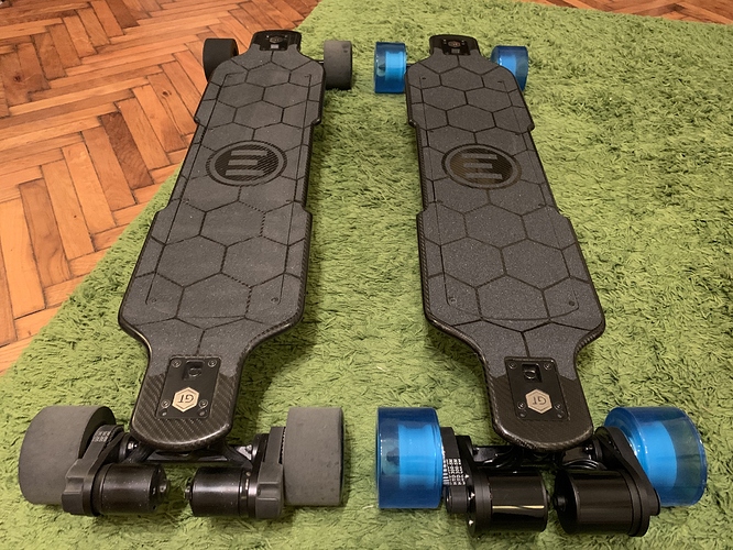

Stock vs this build (if you ask which is which I’ll ask you to remove yourself from the internet for the next 2 millennia):
Here goes…
Long time lurker, been active on the forum for almost two months now. I have three Evolve boards that I’ve been riding since about three years, a GTX and two Carbon GTs. I have noticed that I’m only riding full speed, trigger fully pressed. It does get a bit boring and since one of the Carbons had a bad battery and Evolve hasn’t had a spare available for ages, last winter I decided that I would upgrade the Carbon.

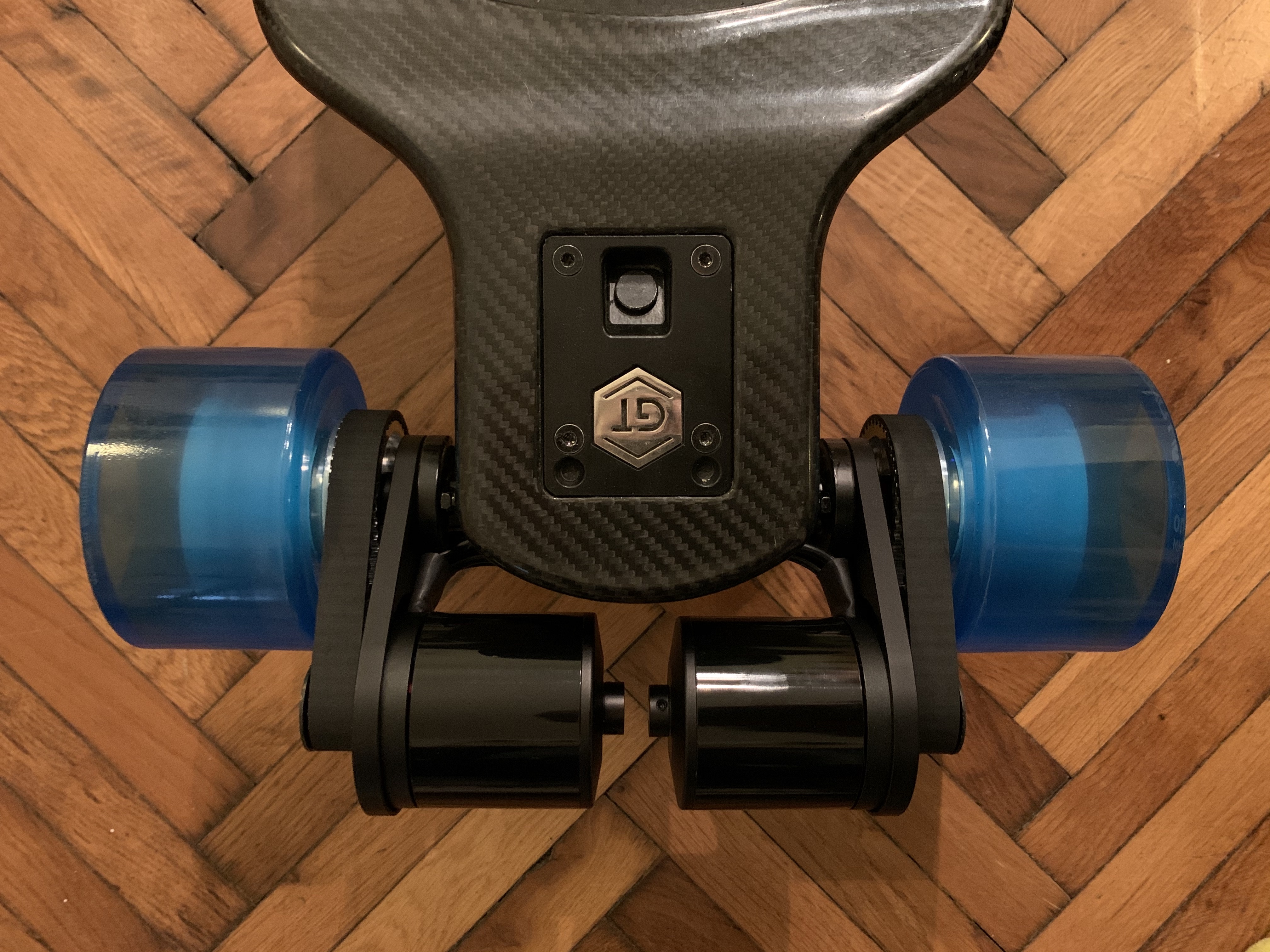

I am in the process of getting a few Nylon pulleys with ABEC and Kegel cores (press fit, making Kegel bolt-ons to be used with the Dickyho retainers), a buddy of mine prints them perfectly. So far we have 36T, 40T and 44T to be used on Evolve axles, with double bearings for extra support. I’ll come back on that with test results. I will update this post with pictures, but earliest this weekend.

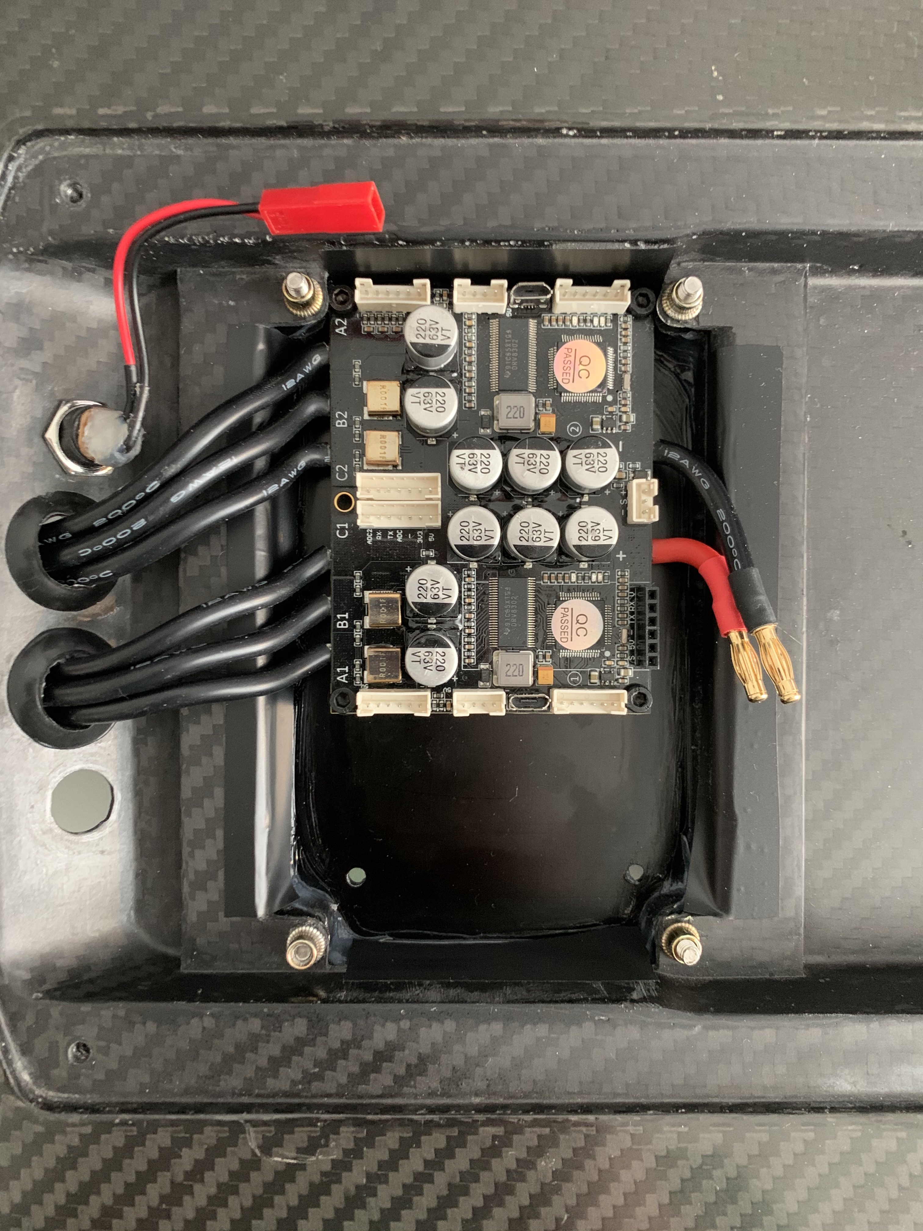

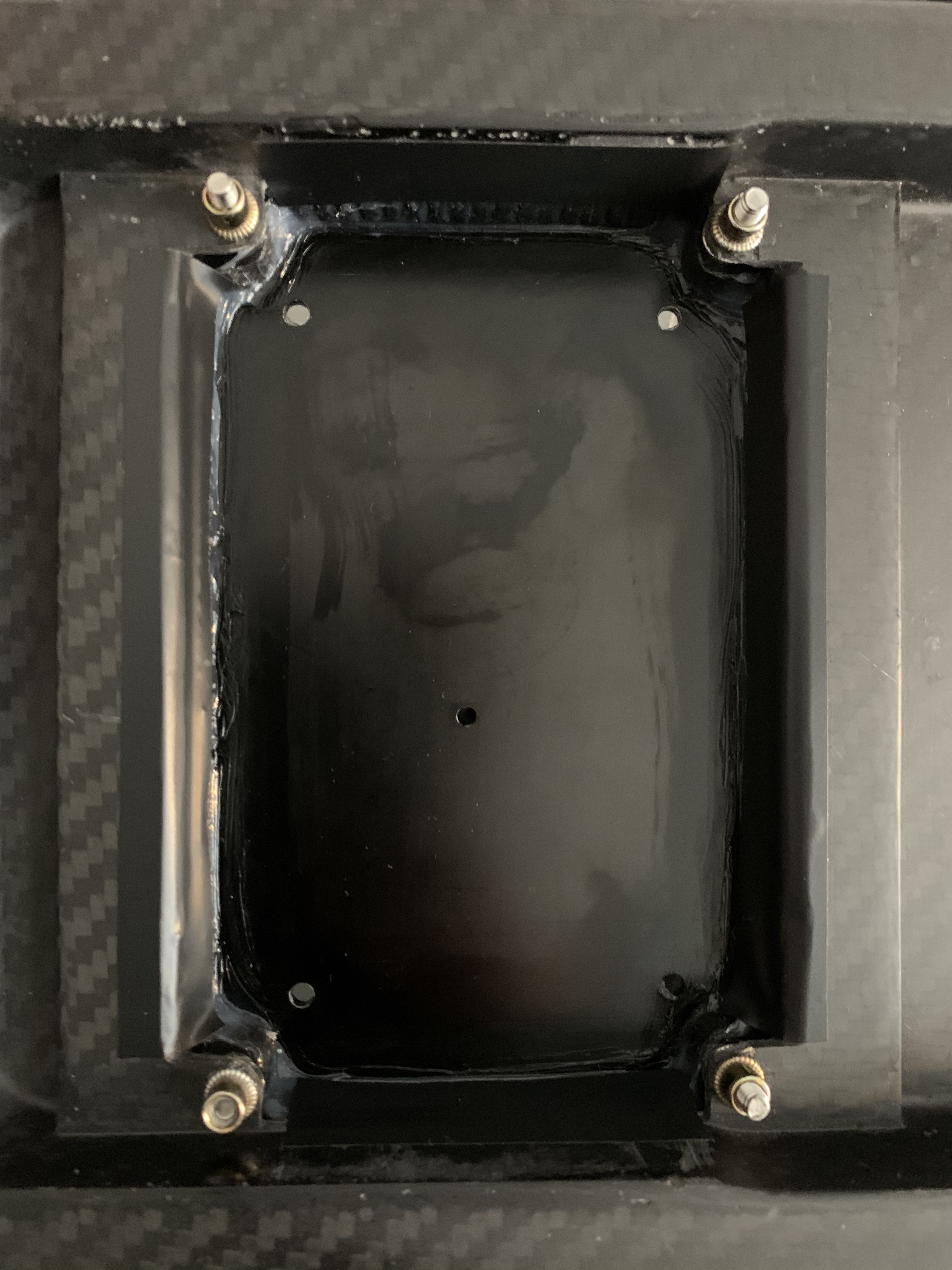

Everybody that knows the Carbon GT can see what I’ve done here, just pretty much took all the excess carbon fiber away. Cost: €7 for a big-ass metal flat-file. Had my mask on d/t COVID19 anyway and filed away after which I grinded it down with some 180 sandpaper. Then I screwed on the 12mm spacer with the heatsink and figured out that 30mm screws are too long. Ordered 25mm M4 countersunk screws on eBay and had a beer. Next day I used some universal (neutral) silicone to close the microscopic gaps that might let water in. The screw-holes will be filled up with epoxy. I like insulating tape to make surfaces smooth, so I used it appropriately.
The Flipsky ESC fits perfectly in between if you do a good job grinding, and be honest, who doesn’t like grinding a bit. I glued the Flipshite heatsink on top of the Evolve heatsink with some Silverbead thermal glue. I don’t think I’m ever going to separate the two of them, that stuff is actually really glue.

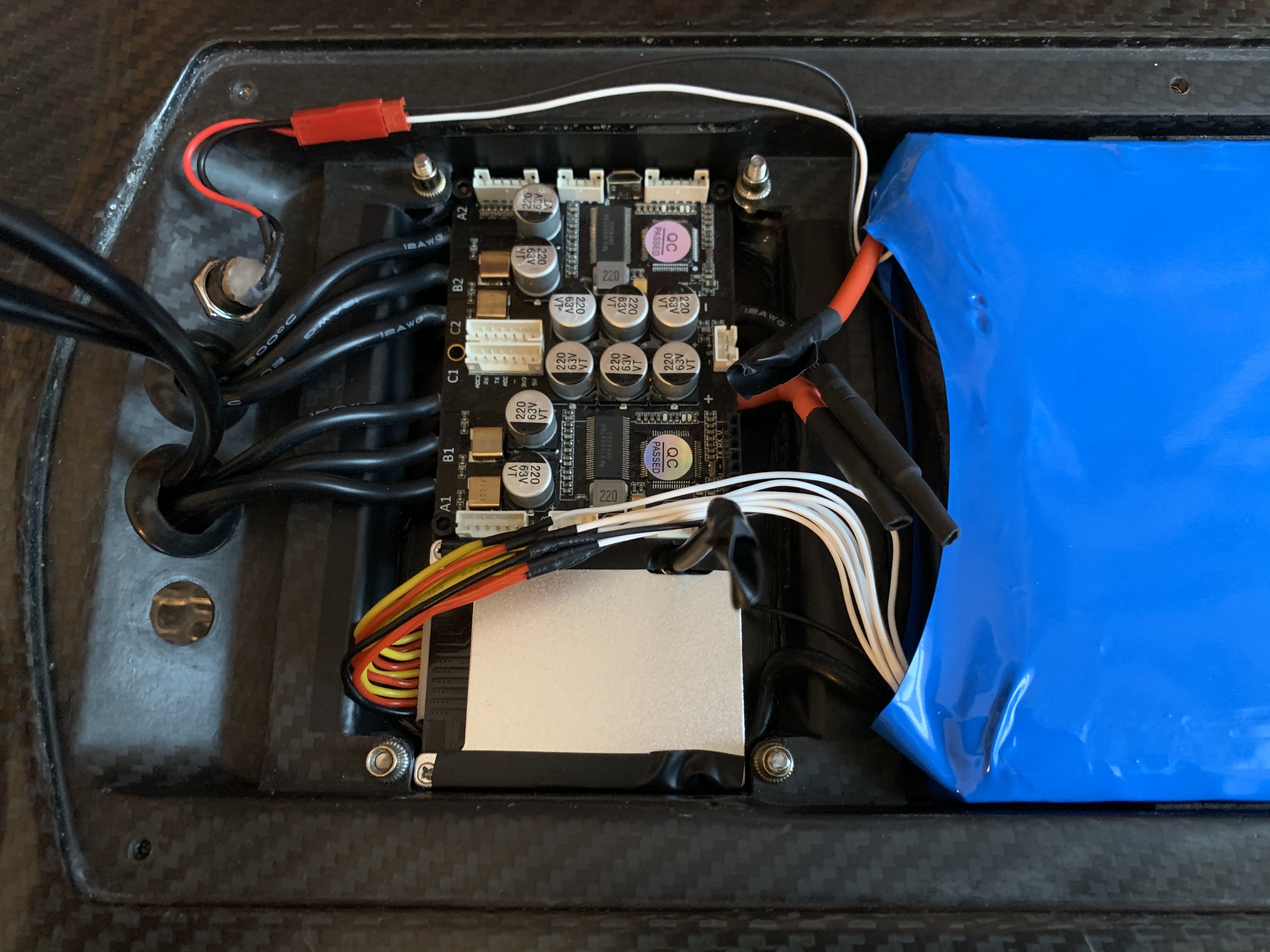

The actual reason for the grinding was that I definitely wanted a discharge BMS. This is pretty much the only thing that fits. It is indeed a perfect fit. I used some EC360 thermal tape to fixate the BMS to the heatsink without having to use excessive force if I ever need to separate them. The Flipdipshit is definitely going to die should I ever need to separate it from the heatsink.
The Maytech remote is awesome I think. The receiver is a fail, as far as eSk8 goes, maybe it is actually good for eFoils. That’s a whole different project though, but I will make one eventually. Anyway, the receiver has these dumb-ass 2.54 connectors which are way too big and just useless. Straight or 90-degree jst-ph connectors should be standard. I just desoldered them and soldered a flat cable with the right connector directly onto the board and put some clear shrink-wrap over it (picture will follow).

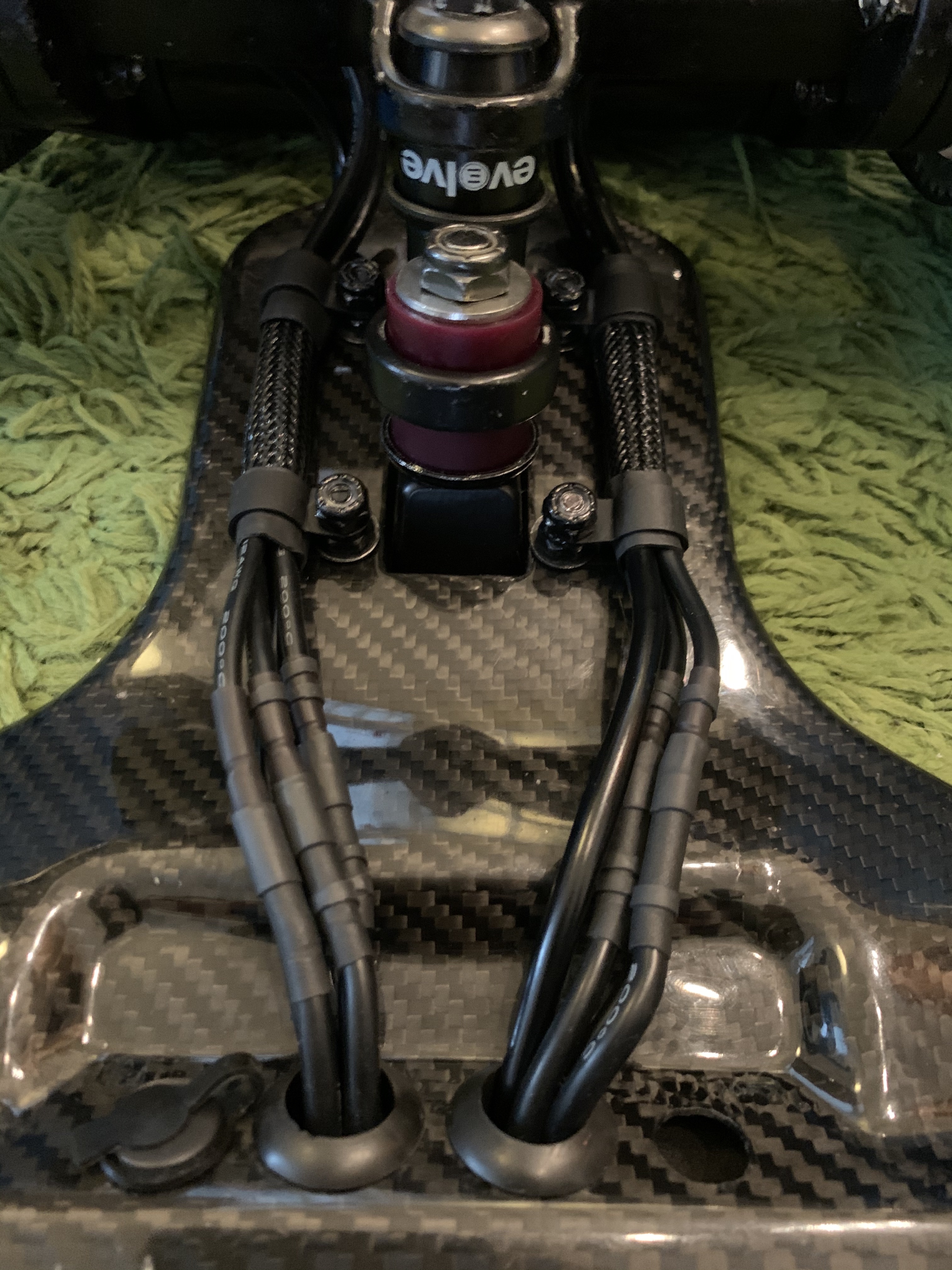

Not entirely satisfied with my cabling. Marked all cables with shrink-wrap stripes instead of colours but didn’t put meshing all the way around. Might actually leave it like this or be completely dissatisfied and put meshing on everything. Undecided. A beer might help me decide.
Those TB110 are just awesome:

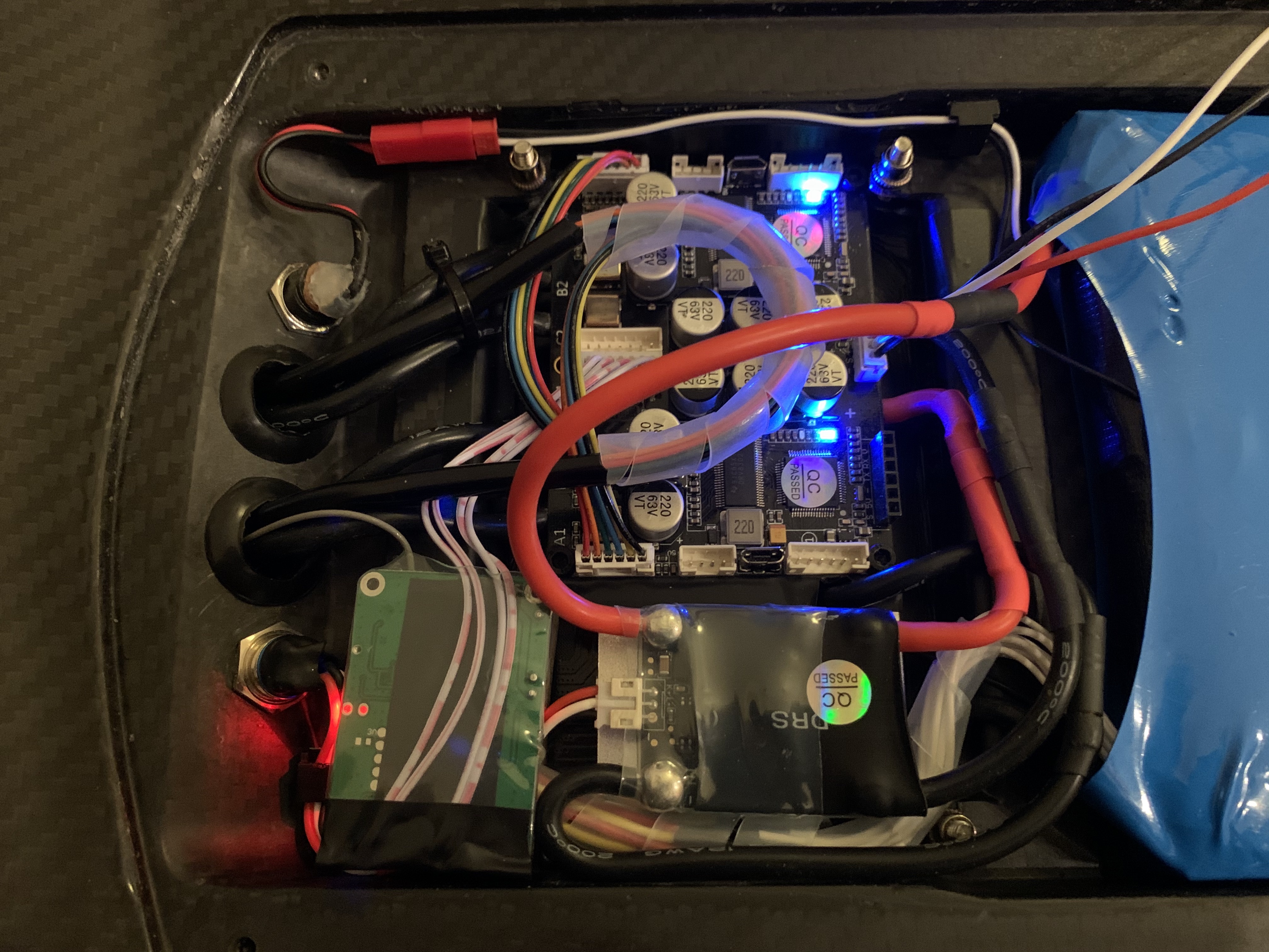

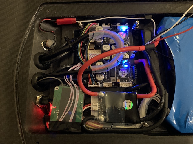

It’s raining again here so I had some time to do some soldering and what not. I used double sided tape to put the Fliptwat AS on top of the BMS. The receiver goes right next to it.
I need a way to fixate the receiver. I’ve put some foaming on it so it will stay in place but that’s not optimal.
