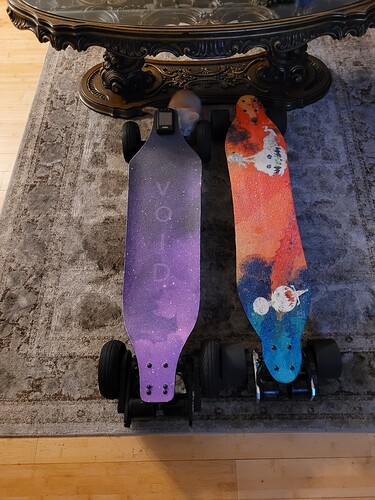

Update!
KSB v2:
Recieved my BN184. fits both pulleys+motors and the wide cloudwheens.
Also mounted my DAVEGA X
Void:
Battery is done!
Kids see boosted v2 is almost conplete! Just needs some finishing touches.
The Void and KSB updated!
:eggplant:
:flushed:
Updated parts lists for both boards as I recieved a stormcore for my evo.
