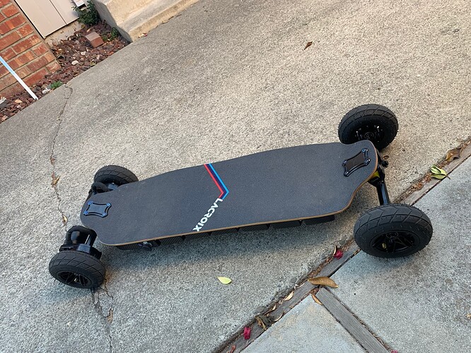

I’m calling this board Huhu Honu, which means Angry Sea Turtle in Hawaiian. Edit - i this board became jawzare because it basically became a jaws with a nazare battery pack.
It wasn’t supposed to involve any DIY, but it arrived with a completely drained battery, so here we are.
Current next steps:
  • Solder up a 12s5p p42a pack with P-groups spot welded by @Skyart
  • Radium riptide adapters and anti-sink plates in the mail
  • Mount SKP 175x50’s
  • Think about BN-AT gear drive
First job done. Regrip.
I don’t know how lacroix went from the timeless beauty of the prototipo to this monstrosity of a design.
The graphics are well under a layer of resin, otherwise I would sand them off and reveal the carbon fiber.
I went with Jessup ultragrip. I wanted something with a little more grip than normal skate grip tape, but mostly I needed an 12" wide grip tape, and this was one of the few that I could find online.
Boardnamics straight cut 3.95 ratio update. Required some dremel work. Don’t buy the 21t straight cut pinion if you are not comfortable with a dremel.
I blew up a sentinel by accidentally shorting next to the xt90 with an allen key. $120 to replace it, bit I’ll call it a win since my eyes are undamaged from the mini fireball I caused.
I bought this board used on FB marketplace. It showed up with a dead battery. Here’s some pics from the teardown and building the new battery. I purchased pre welded p groups from @Skyart . Thank you :pray:
Don’t try to recharge dead batteries. You’ll end up with a dangerously unbalanced pack like the one I had above.
