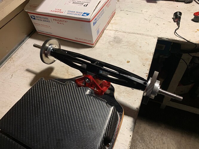

I had a marathon build weekend. Like 20+ hours working on 2 of my 3 boards. But I got done everything I wanted to.
  • 5.5 boardnamic straight cuts on hypertrucks are on. One of the 89 tooth gears was too big for case and the other one was terrifyingly close to the edge. Dremel time. Apart from the currently questionable battery, this board is almost done.
