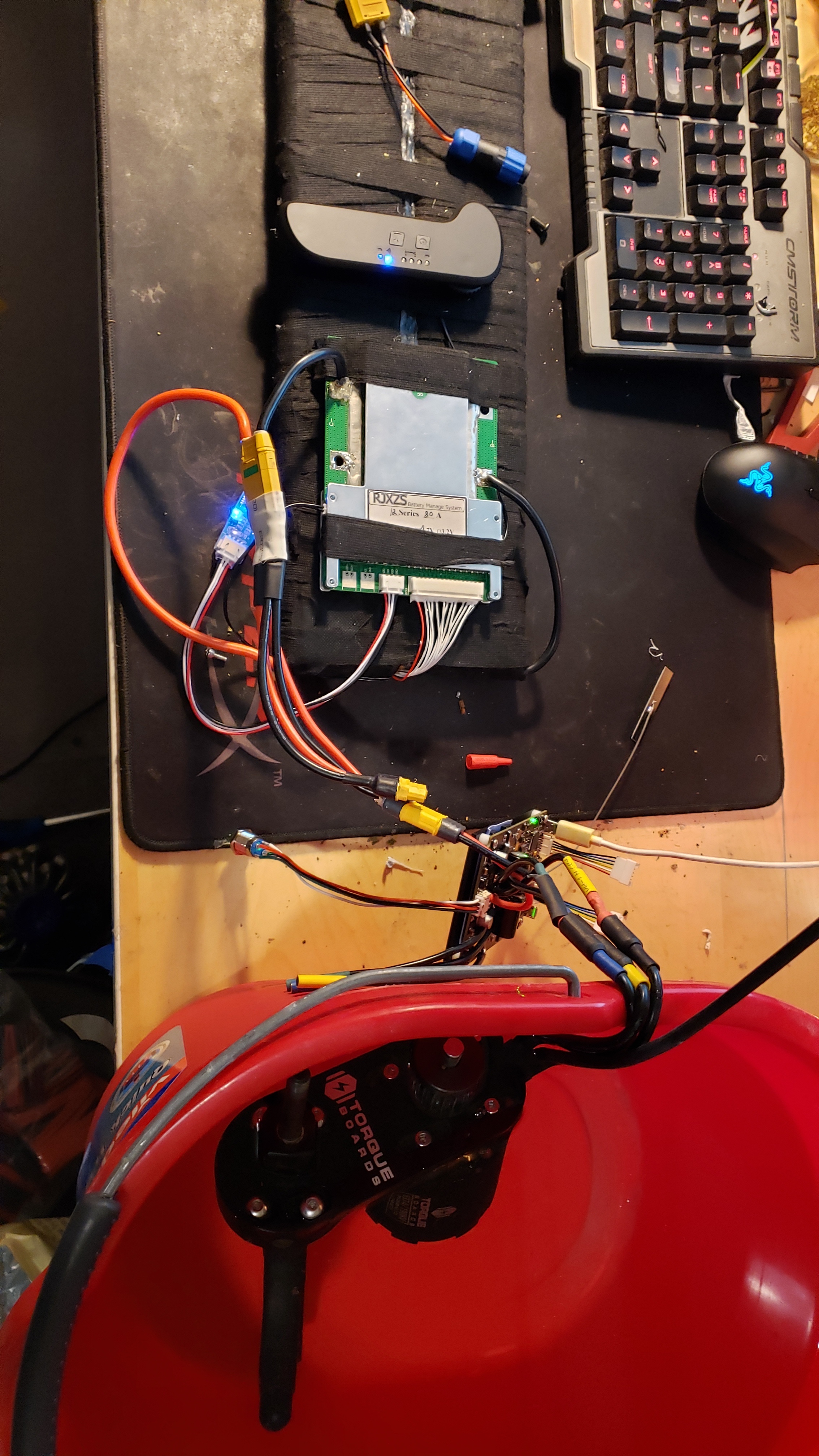

Now some Proof of my sketchy test setup,
I tried to Run all ESC’s with both a foc_openloop 50 100 and foc_openloop 70 100 command. 50 and 70 amps respectively at 100 erpm. For all the tests the ESC’s where suspended in open air and not touching the table. Mosfets start Temps 30C +/- 3. TB 6374 Motor. Unsensored. 18C ambient Temp
First I tested the Mini Foc Plus at foc_openloop 50 100 and it took a total of 4 minutes and 3 seconds to start thermally limiting current to about 30 Amps at 80C This is a Vesc 6 hardware variant with Direct Fets and a small heatsink. The outside of the case was around 70C on my IR thermometer. I couldn’t touch for more than a few seconds.
Next i thought my Esk8.de (my favored controllers) would blow this out of the water and boy was I ever wrong, 1 minutes 3 seconds at foc_openloop 50 100. Now this one is by far the fastest to cool off after turning off the test but it throttled down to a pretty stable 38 amps at 80C
Now finally the ESK8Supply Vesc based ESC foc_openloop at 50 100, 20 minutes 69C STABLE… Now this doesn’t make a lot of sense but the heatsink is shared between 2 ESC’s and I was only testing one. So I’m sure under a dual Scenario this won’t perform quite as well. So I decided to test this at foc_openloop 70 100 as well because why not.
After 10 minutes I had to call the test at 69C mosfet temp because the phase wires where almost 100C and starting to smell.
So to say the least the Esk8Supply ESC has far surpassed my expectations on the bench. It seems to have a fairly conservative current rating that i will probably push when I install it in my board.
