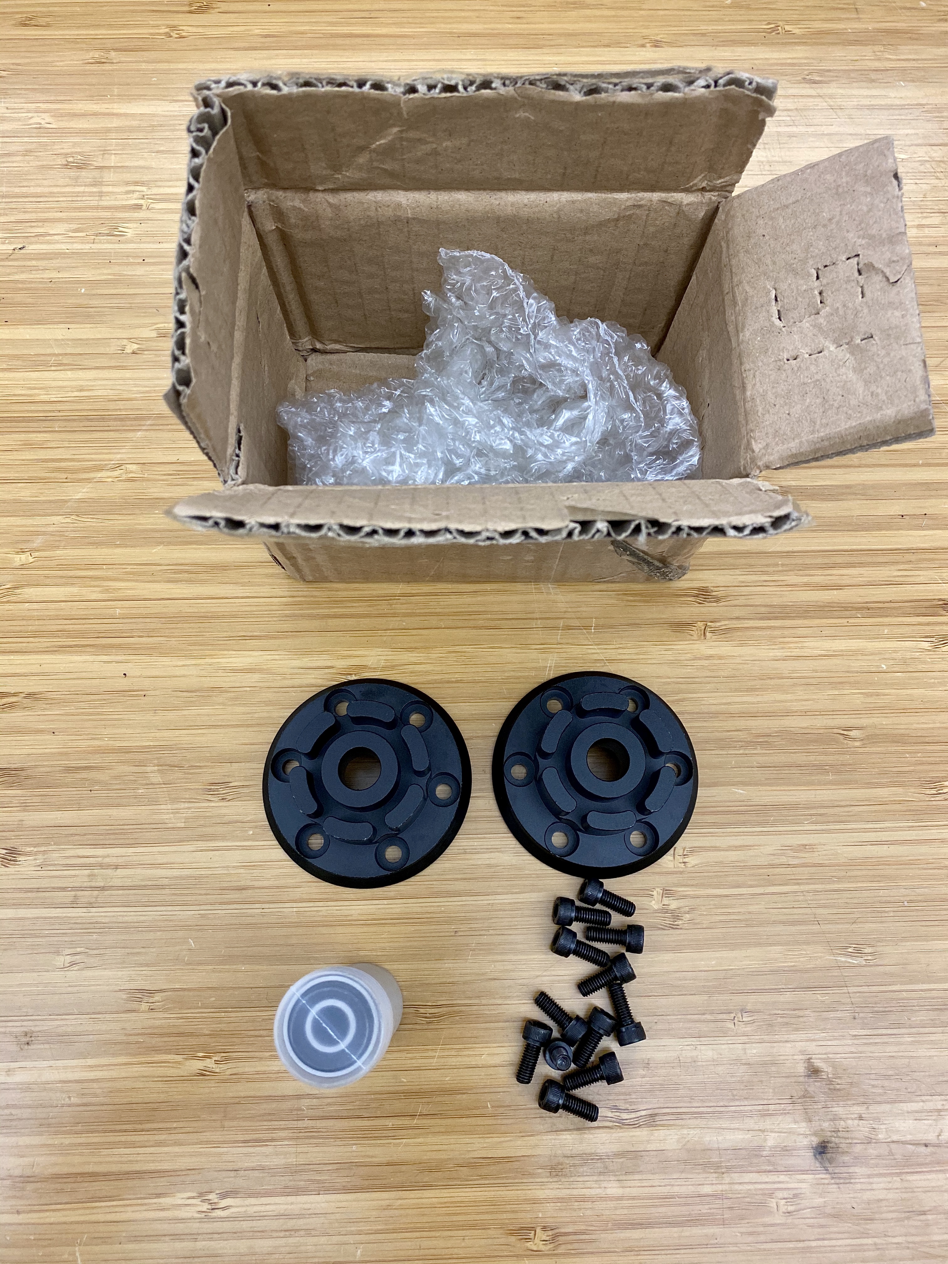

Can I get a abec adaptor for 58k with shipping to Australia 4215. ATs are best on road too hard for off road. Looking a set of haggies for my DD now.
how “off road” are you talking about here?
dirt path/light gravel/mountain service road with potholes/actual trail with roots and stuff
For sure, the link is
https://www.esk8supply.shop/product-page/abec-adapter-for-the-direct-drives.
Ordered 1000 times easier than dealing with ownboard. Great site btw.
Thanks man!
Thank you @Esk8supply!
Will these fit on my drives?
No worries :blush:

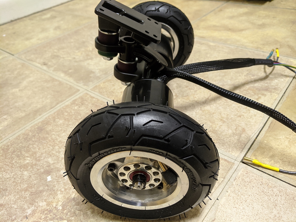

Check ya drive kV, wouldn’t want to run anything but the 58s with pnumies.
They’re 6" right? What’s wrong with running the 70KVs? Lack of torque?
Yeah, you’ll be pushing them too hard to get good accel out of them without an abundance of heat. Unless you go 4wd ofc :metal:
There have been problems with the 75kv TB DD and larger pneumies. To his credit, Dexter does not recommend certain wheels in conjunction with his first gens.
Is this for DDs all around? I know Elofty DD are “lower” performing than TB’s so I guess this probably applies.
Only one way to find out though :stuck_out_tongue: I was going to run either a 12S2P or 10S4P and leaning towards the later with pnuemies
12s is pretty fast on 6" tires @ 70kv. Better to go 10s, but you still might struggle with heat.
Got 4wd 58kv ,:stuck_out_tongue:
