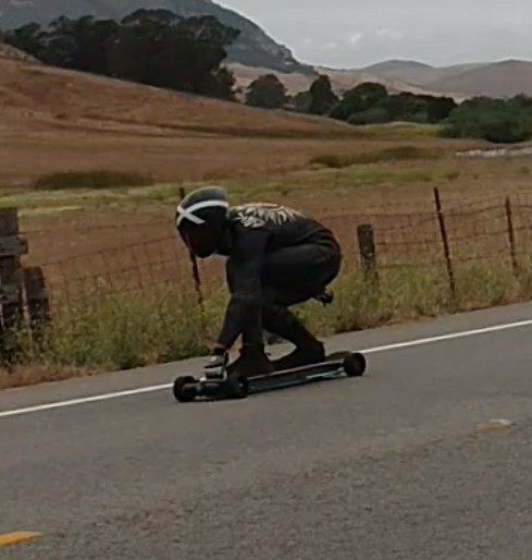

I’ve watched moestooge on YouTube and raced behind him in person. I generally try to approximate his level of tuck.
Coloradocadi gets, imho, too damn low for my liking.

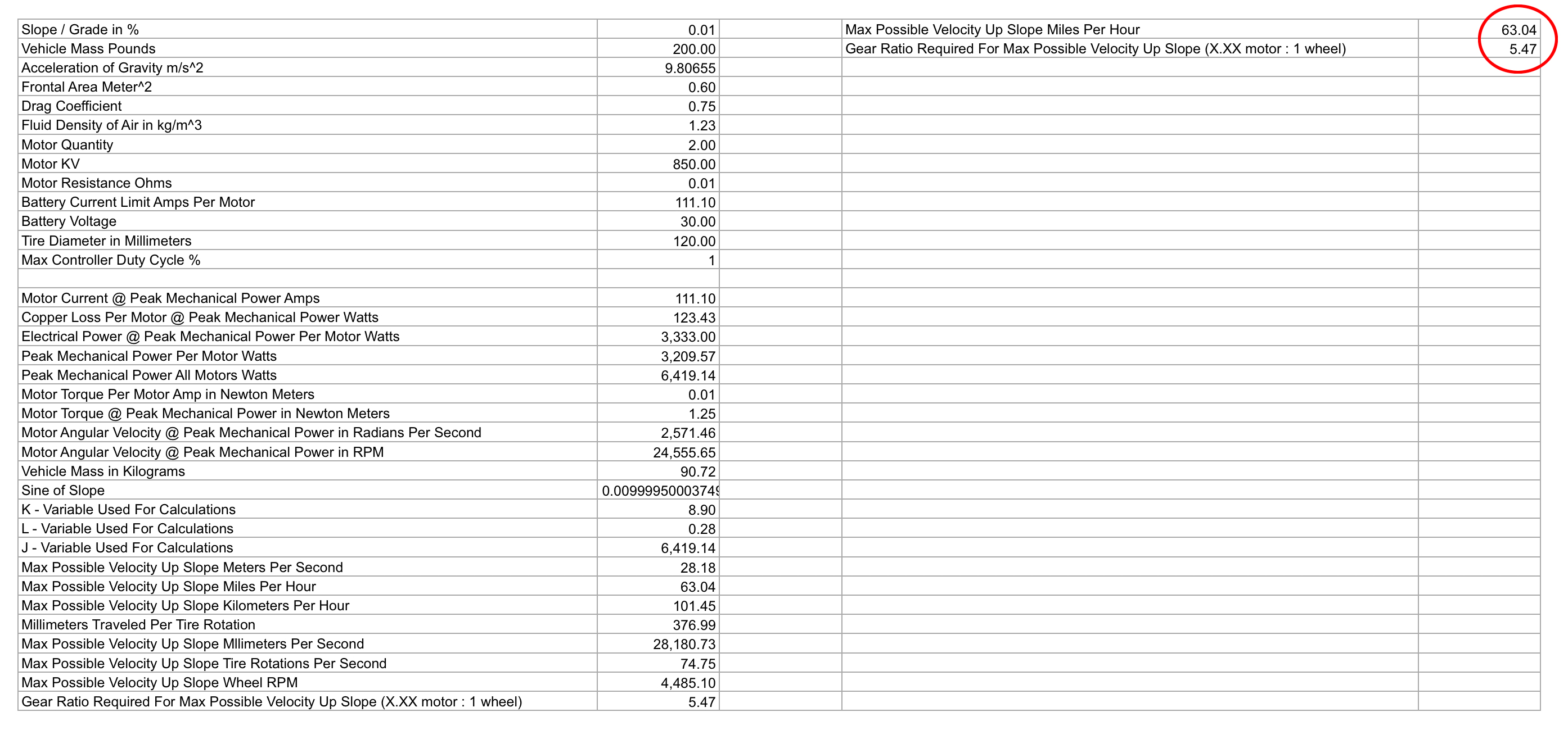

This was the Max watt used getting to 63mph on a slight uphill grade with no headwind. Note the volt sag from the 10c lipos. 1v = ±3mph. This was our 5th and final pass getting Max Capps acclimated to a powered board.
looks like about 5900 watts factoring both motors,
111.1a^2 * estimated 0.01ohm = 123.4w copper loss per motor
246.86w = 2 * 123.4w copper loss per motor
5900w - 246.86w = 5653.14w
5653.14w = rough wind watts at 63mph
@MoeStooge It looks like the power of the wind at 63mph was about 5653w.
according to my charts, 0.6m^2 and 0.75 drag coefficient gives 5318w at 60mph.
Its uncertain to determine drag. The motor rpm was still accelerating when Max lifted the throttle. He crested but never leveled air speed to get a decent mph flatline watt measurement. Still a good real world of how many watts it takes to get there. Accel, Drag, Ele. loss, drive train loss and grade.
@MoeStooge
4.2:1 final, 800kv 6pole. Motor/gear Settings on the screen shot are wrong.
