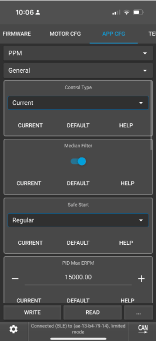

I did this a while ago on an ESC I’ve since blown up, so my numbers could be way off. I think my board went about 15mph in reverse, so still quite a bit of potential speed, but significantly less than my 40ish top speed.
A massive shout out to the Aussie underground esk8 community for helping me with the D100s brake thing… it’s not an issue more like a DIY tweaking.
If using a PPM remote, switch to Current, ERPM settings are all default.
What did you have it at before? Current is the mode where you have full reverse right? Easy burnouts.
Full speed reverse.
You should have just as powerful brakes with “Current - no reverse with brake”

Ohh I got it working with -10k ERPM - turns out it was a skill issue :rofl:
Full current with reverse limited to -10k ERPM is AWESOME. I’m never messing with smart reverse or hyst reverse again. I’m stoked.
