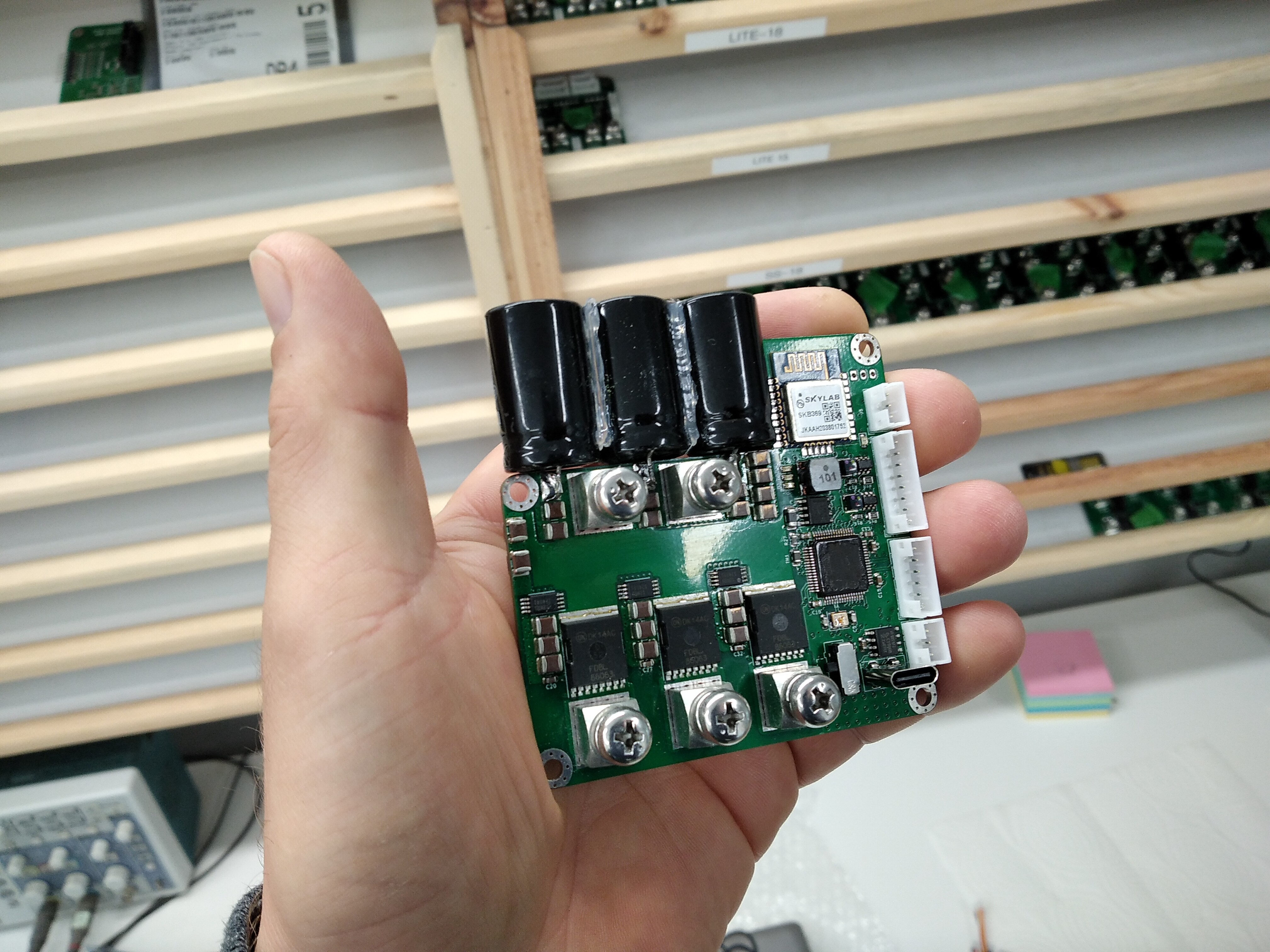

Starting the testing of those freshly designed 100V|75A ESC this week with my EBMS. Should be good for up to 20S in a 70mm x 75mm x 16mm package. DRV less design with IMU+bluetooth. It does not have one of those failure prone integrated anti-spark switch
75 battery current or phase current?
