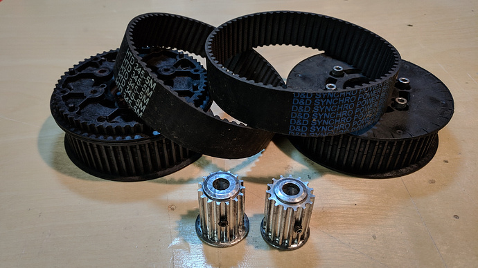

In some brief testing me and @Tonkatron found the difference to be about 25% compared to his 25mm belt setup.
Thatâs basically the worst case set up regarding free roll, especially with the idlear
Aiiii
Itâs the only metric I have
And thatâs good that you have that, even on video. Side by side comparison is always good
there also was the fact that Lee would use regen to brake but with belts I would use the drag more to slow down.
Still, my 25mm belts have not be replaced in 3 years and are in tip top condition. Zero maintenance lol
Who makes the pulleys for 25mm belts? I thought I was the thiccest belt user at 20mm. Same here though, no signs of wear on the original belts and itâs been a year of heavy riding on my mtb.
Nowind⌠Thats who I got my drive kit from 3 years ago.
also, hereâs an adaptor that sits between the wheel and the pulley so you can use them on Trumpa wheels.
To make it work you need to press in the nuts to the adapter on both sides then attach the adapter the wheel, then the pulley to the adapter.
