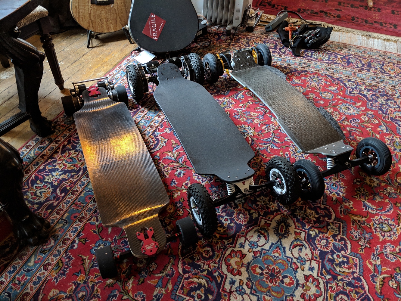

I was working on my first diy- Going with trampa holybro, vertigo trucks, hypa wheels with 7in inline tires, alien power system 6374 170kv motors. Was still sourcing the rest of the parts, was thinking trampa vesc6+ and a 12s6p 18650 30q pack.
BUT while searching for parts I obtained a trampa emtb and it is pretty sick! Has 80mm alien power system motors and helical gears instead of belts. I ordered a couple new lipos(for now) that they recommend for the board/monster box. I went through and cleaned up a few bad wires and re routed over the top of the binding like suggested by trampa, got a couple cable clamps to get still but still going to learn about the vesc tool a bit and update and get riding in the next week!
So got the 4 lipos in to try the board out, mainly to see if I wanted to dump 4-800 in a battery hahaha. Just did a test run and it was good! Going to put the dampeners back in and double check everything is tight and give it another go. Tried taking it up to some speed and it had some bad shakes around 20mph then had two springs pop loose. So that was the test ride leaving it how it came. If the blue are to stiff I have a set of yellows to try :grin: So far though I’m thinking that a proper battery pack will be in order for this board!
Got my trampa parts today :smirk:
Looks nice! First thought you got only two wheels :flushed::joy: than understood they just laying on each other :joy:
Yeah I dont need rear wheels will just mount the motor mounts upside down and use the motors as hub wheels :joy:
