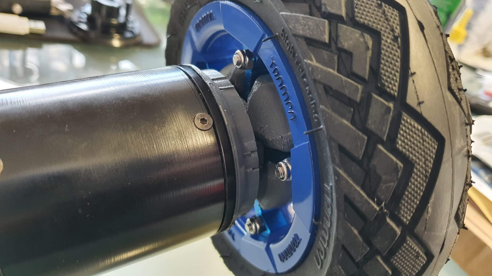

I used blue loctite on my cans after loosing them and they have been fine since then, honestly it’s even a problem as I have no idea how to take them apart in case of failure :sweat_smile:
Those magnets are fine. Might add a few Ed edd n Eddy’s depending on if you ask Hummie or Shart.
Just JB weld that shit together
BTW you clever guys have any idea how to remove the cans when glued?
They are thin and with no grip at all
I used a vice plier when I fixed them but this is not good for the paint
Bruh I literally just put locktite on the can screw the can on almost all the way with 0.05mm gap left and it just stuck there. Now I have to wait til the can popped off again… I put some car wrap I found on aliexpress around the can so it doesn’t get scratched up.

Remove motor from axle… take off all screws… pull stator from motor can…
Dunno why I thought you had to unscrew the rear can to get the motor out of the axle

BTW did you also glue your adapters’ screws? If not, do it now (and wait for 24h before you ride)
BTW 2: my left motor can also got loose after a while…
Not gonna lie. I’ve been using dc motor and when I test run the elofty it was so quiet. Wish the can didn’t pop off but I got it for cheap so :man_shrugging:.
O and yes I glue everything lol. Would it be a bad idea if I Red locktite it? Red locktite would permanently bind the can together. So no more problem. :thinking:
Blue is fine, keep in mind you may have some maintenance to do on those :wink:

Loving that adapter… and your can came with set screws :sunglasses:
