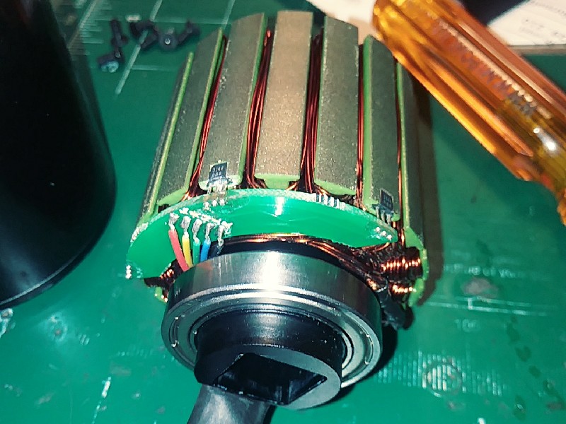

Inside the latest 58kv eLofty direct drive motors…
18 teeth on stator, 20 magnets, ring under magnets to “help” hold magnets in, no evidence of epoxy holding in magnets, flat magnets, definitely NOT curved magnets, slight miss-alignment of magnet spacing, no evidence of can balancing.
@torqueboards
Stator size: 53.5mm dia x 43mm long
Motor can is 66mm dia. x 70mm lg
front bearing 6902Z (wheel side) 28mm x 15mm x 7mm
rear bearing 6805 2RS (hanger side) 37mm x 25mm x 7mm
20 magnets 43mm x 8mm
Edit: added motor internal info.
