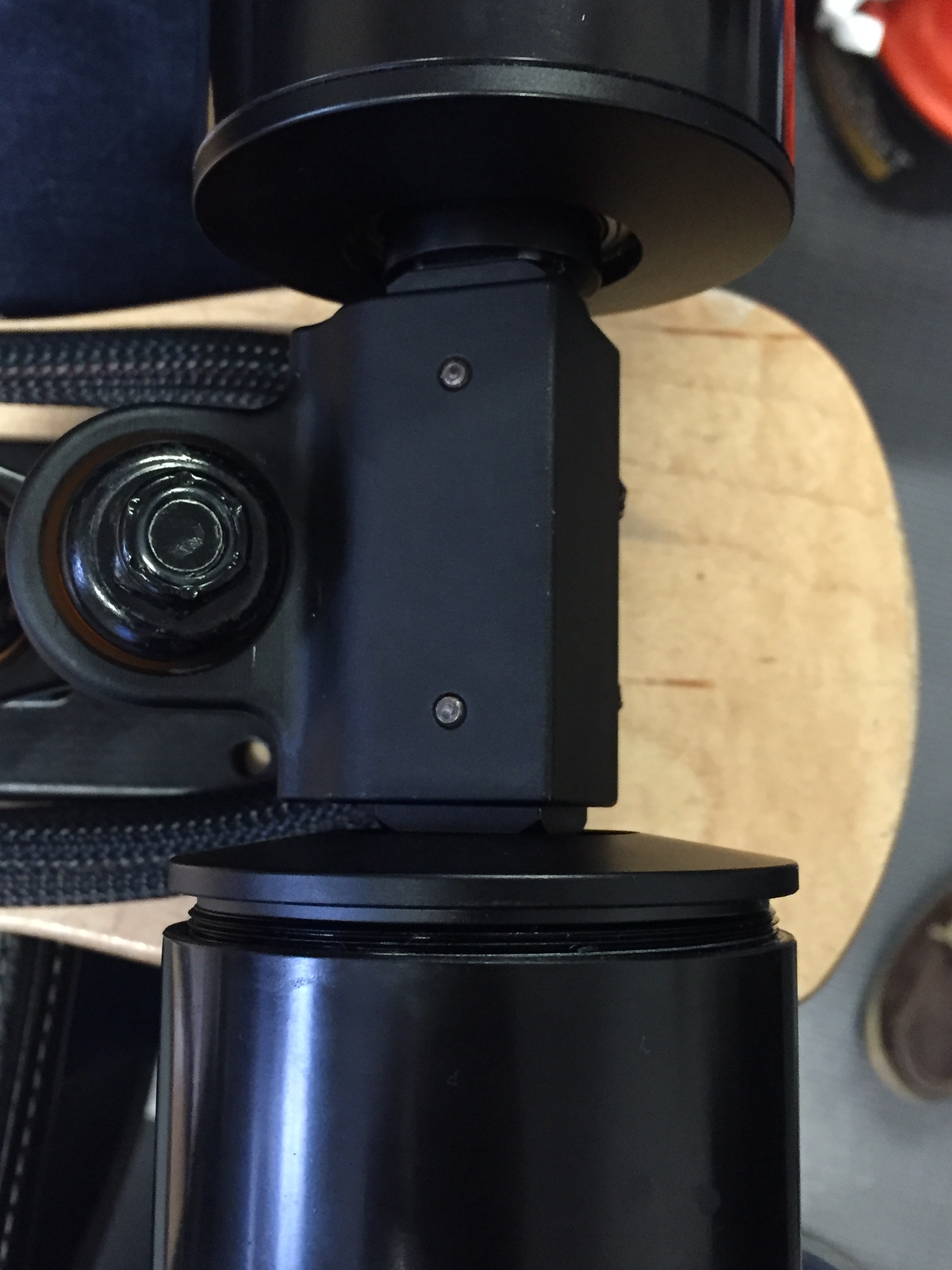

My hanger broke ~2 weeks back. I wrote to Kenna and to my surprise I got an immediate response. She said she would get me a replacement hanger. After that she started making excuses though and eventually became completely silent so I donât think there will be any replacement.
Still, I wouldnât mind paying for the new hangers. I did enjoy riding my elofty drive. Are they available for sale anywhere?
I believe Nathan at @Esk8supply can provide them for you

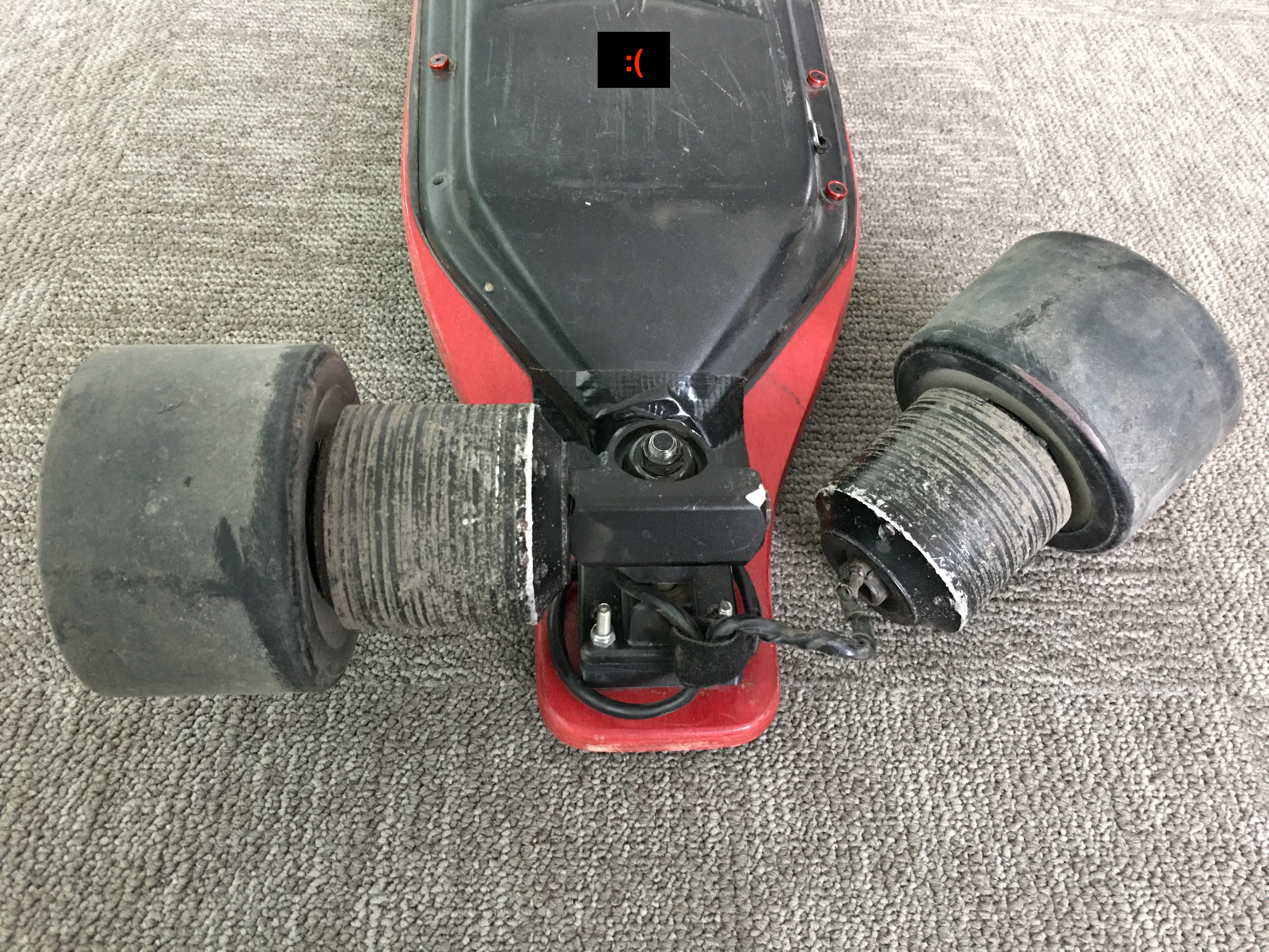

your motor cans look like theyâve been through hell :o
Tis but a scratch.
Can I ask how much you weigh?
about 75 kg, maybe 80 kg with gear

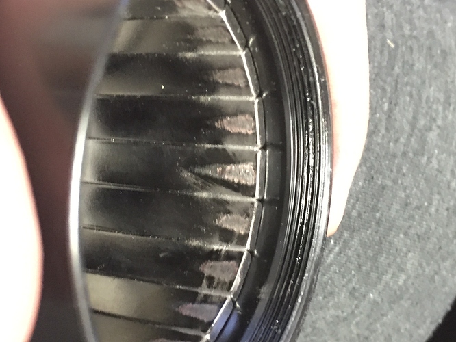

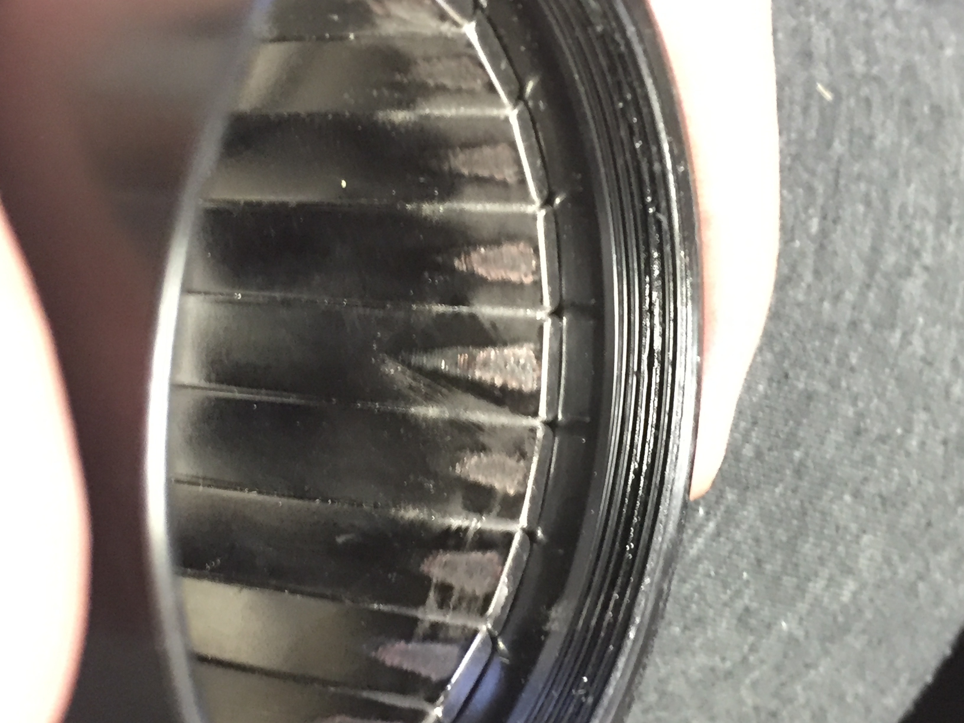

First test drive and end up with the loose can thingy.
What do I do now? Screw it back up and apply locktite?
Edit:
damaged the magnets. Sweet.
Where did you order yours from?
Would love to know too. I thought the cans on all the ones currently shipping had set screws.
I ordered it from esk8supply.
Recently? This is the 58kv kit?
yup. last year group buy. 58kv. damn that was a bitch to put back. Do you know if other people have success with just locktite on the can?
EDIT: whatâs the amp rating on this motor? Does anyone know?
hmmmmm thatâs somewhere between 12 and 15 (Iâve honestly lost count) motor cans that have unscrewed⌠all right-hand side drives as well⌠If I were you, Iâd read through the thread⌠
