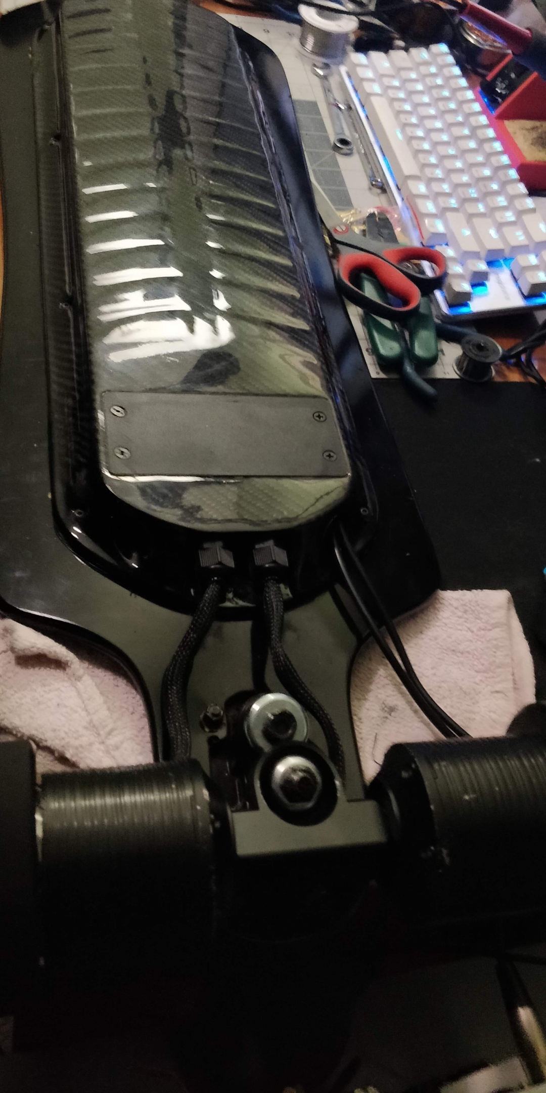

One side rattles like hell because of the loose lock but. I tried adding shims but there’s still a lot of play

My point in swapping motors, I was already taking both of the hangers anyway to “battle harden the cans” with epoxy, I’d inspect the motor bearings and the motor lock nut while they’re apart and it’s easy peasy to just swap the drives at this point.

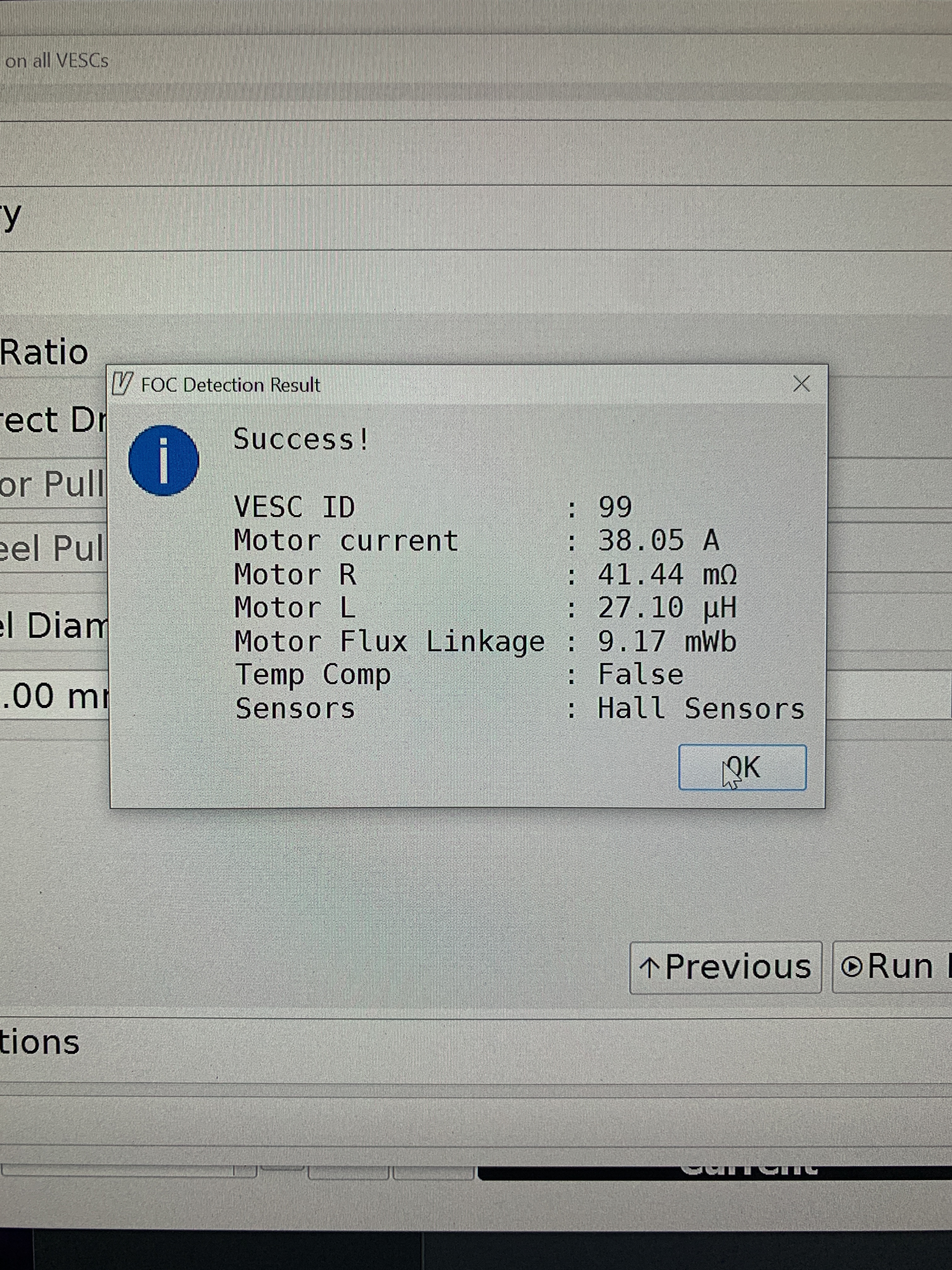

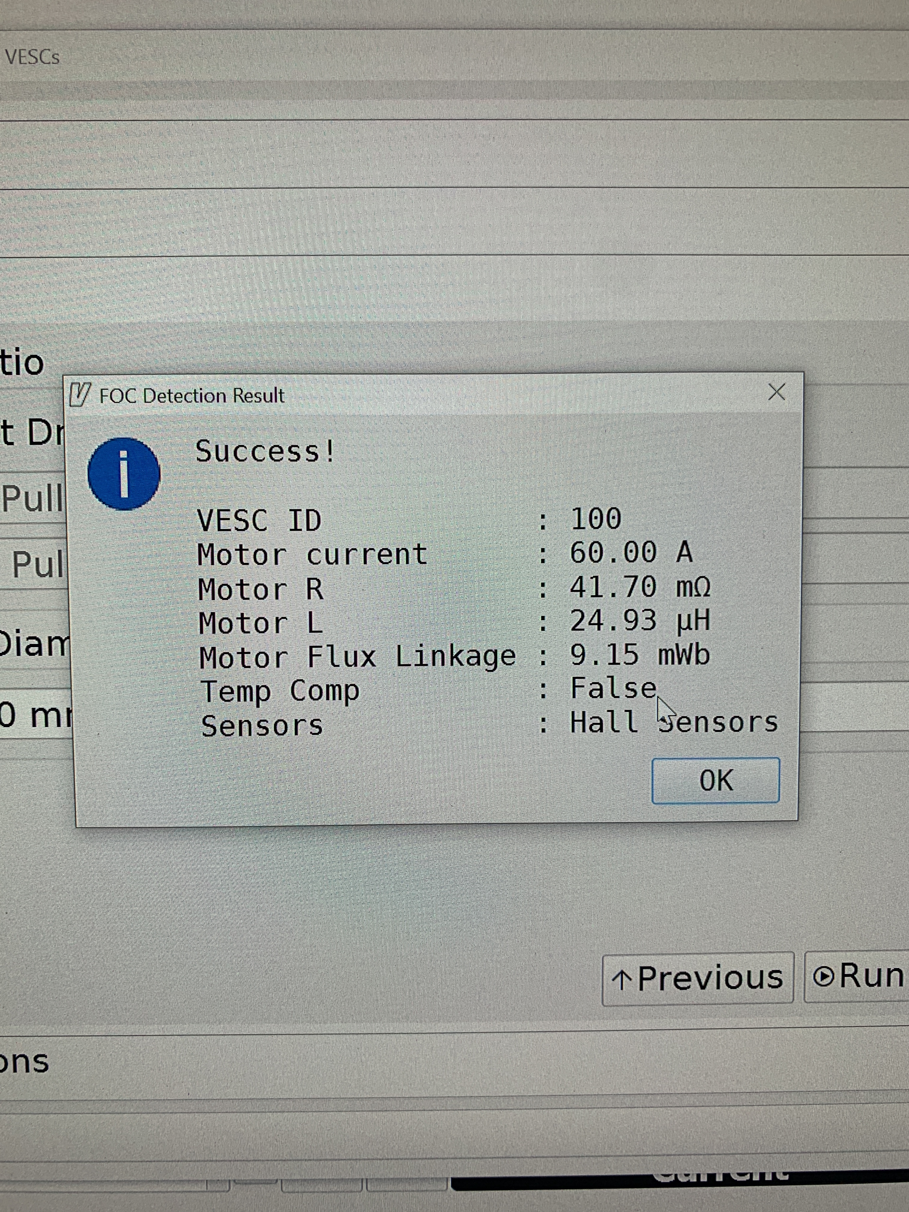

Just realized something. I threw my specs into the esk8calc and it’s saying my speed should be somewhere around 40mph. That seems wrong as it definitely doesn’t feel like 40mph top speed. Maybe my battery sags too much and doesn’t reach full potential? Is there a way to measure KV from the vesc tool? I’d like to take a look.
or probably not enough power/torque on pnummies/old battery/vesc settings to reach that
You can put 20" tires on it and have the calculator say 100mph, but that doesn’t mean it’d work :stuck_out_tongue:

I blew out 2 bearings (outside) on one of the motors. The first time, bearing blew out during the ride but I didn’t notice till charging because it rode like normal on just one bearing. The second time, wheel detached from board while riding. :confused: I learned I can run and catch myself around 12mph though haha.
I’m wondering if it’s due to the lack of a spacer on the hubs or maybe I’m just using way too cheap bearings.
WTF NO, see I figured that adapter was gonna be retarded. Whoever thought that adapter was a good idea replacing a bearing should be shot. Deadass if my wheel falls off while I’m riding, I’m taking those drives to the range and put 100 rounds through them.
haha actually I think the adapters were the only thing saving my ass the first time as I think that’s all the wheel was holding on by. The second time when the wheel detached was in the middle of a turn which makes sense as the wheel was pulled off the adapter. I still think there should be a spacer between the adapter and outer bearing so you can somewhat crank the nut without fear of pinching the bearing. With reinforced axles, I shouldn’t fear about the axels breaking anymore.
I do have some thoughts about the adapter though. I’m wondering what the material of the adapter is. For me, the adapter doesn’t fit all the way into the wheel as it’s limited by the bearing well size. I think this should be compensated by either wheel or adapter side. It’d be nice to have an integrated spacer built into the adapter but I understand that different wheel thickness makes this hard.
