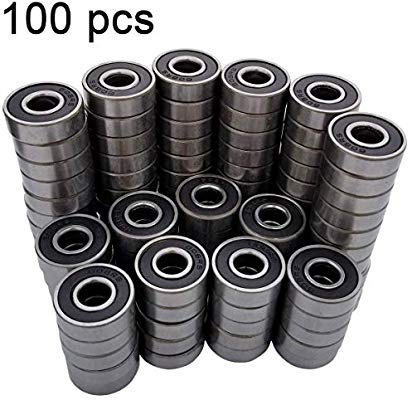

The axle does have a bearing spacer though, its the stepped axle. However point still stands. You shouldn’t be burning through bearings like that.
Also I’m not sure what the adapter is made from as it’s only magnetic on the kegel pins.
Hmm for me the stepped axel doesn’t reach all the way to the inner ring of the outer bearing. Further more, the outer bearing sits halfway between the axel and the axel threads. Yeah although I would put the blames more on the bearings as I think I got 100 for $20? :sweat_smile:
Yeah that is quite interesting. For the kegal adapter, I’d be worries about one of the pins bending and ruining the entire adapter.
I’ll have the drives up and running in about a month or so. Waiting for some more parts. So we’ll see, but yeah those are some shit bearings there my guy lol. I have a spare set of reds I’ll use but I’m still highly skeptical that they’ll last. It’s either they’ll fail or my can will start un-threading like everyone else’s so I’m already planning to run into snags with these drives regardless.
I will say that my order came with much nicer bearings (I think because I bought the cloned boosted wheels) that I’ve neglected to use but that may change soon?
Is it possible that the bearings are overtightened ?
:thinking::zipper_mouth_face::woozy_face::wink::wink:
wait, so did you blow the cheapie regular skate bearings?
Or the special sized motor bearings in the DD?
That was one of my concerns. Because there isn’t a spacer in between (my normal spacers were too big) there’s a possibility of over tightening. But I don’t think so because I was also worried that tightening too much would weaken the axle. With the latest bearing, I’ve made sure to tighten until snug and then back a smidge.
I blew 2 cheapie bearings. They’re grease filled shielded (?) bearing
