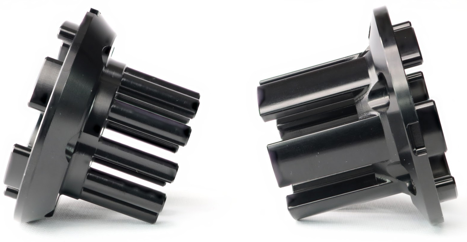

@ThomasL Yeah TB DD is custom. I’m pretty sure they have a more simplified adapter. If you need adapters just send me a PM and I can send you an invoice. Here’s a few photos for reference.
Question :grin:
I got asked about it but no idea. Would this casted TKP fit Surfrodz TKP base plate? Or are they different?
But the DD Kegel is made for Kegel wheels, such as TB110’s and such ?
I have a pair of TB DD with 110’s, does it mean the kegel adapter is only good for these wheels ?

@ThomasL you can use any kegel style wheels with the kegel adapter that you have on the TB DD.
