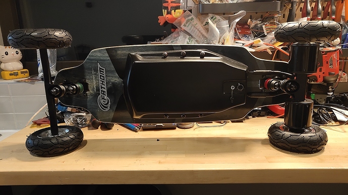

He tightened the big nut holding the motors 3 or more times. Each time stretching the shaft and then finally failed. If you find that the motor is getting loose on the shaft and you have to tighten the nut more than once, then stop and contact her for a new shaft.
I haven’t had to do it even once, so it might not be a universal problem.
to be fair. it was knocking around when there’s no load aka cruising on a flat. it keeps on making noise and I thought there was something wrong with the motor themself. once I tightened it, it was dead silent again.
oh yeah, I wasn’t saying that you were wrong to tighten it. I was saying if Ryan finds himself tightening it more than once, he should request a new shaft because the original one is obviously faulty.
And yours was definitely faulty too because hand tightening a nut shouldn’t cause failure in the shaft.
I need to bug kenna to find out what steel they have changed to. also I have a friend @deltazeta that bought the original shiny drives disassembled. Time if figure out how it’s constructed.
Yeah help me disassemble these, still need to wye terminate them
Can you show us what your current state of disassembly looks like?
