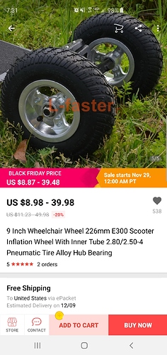

I found this 9" wheel on Ali for cheap but the hub looks too big :disappointed_relieved:

I think they’re actually 5" hubs on the 9" ones I linked. Only reason I didn’t think the tire would fit the 4" standard hub size.
I think they are both 4" hubs. They both list 2.80/2.50-4 tire sizes, indicating the 4" hub.

That photo has the hub diameter labeled at 123mm. That’s 4.8 in.
Still tempted to order one to see.
Yeah, that’s the outside of the hub. Hub measurements are from the outside of the barrel where the tire sits, ie the inner diameter of the tire.
Yep I hear you but that would be one hell of a lip. My 8" tires have about a 100mm hub opening. The fivestar hubs outer lip diameter is only 110mm. They might work still. To clarify, I’m not wanting to use that hub, just the tires and tubes.
I see the tire rating you’re referring to now. I agree they most likely should fit now.
Ah, makes sense. The Fivestar is definitely a special flower since it was developed to fit both 8" and 9" wheels. I think my assertion above stands here
MBS lists their 9" as a 2.5-4, so I’d be surprised if another 2.50-4 didn’t fit. 100mm tires = 4" hub, lip doesn’t really matter since these are split wheels, so you don’t have to get the tire over them or anything.

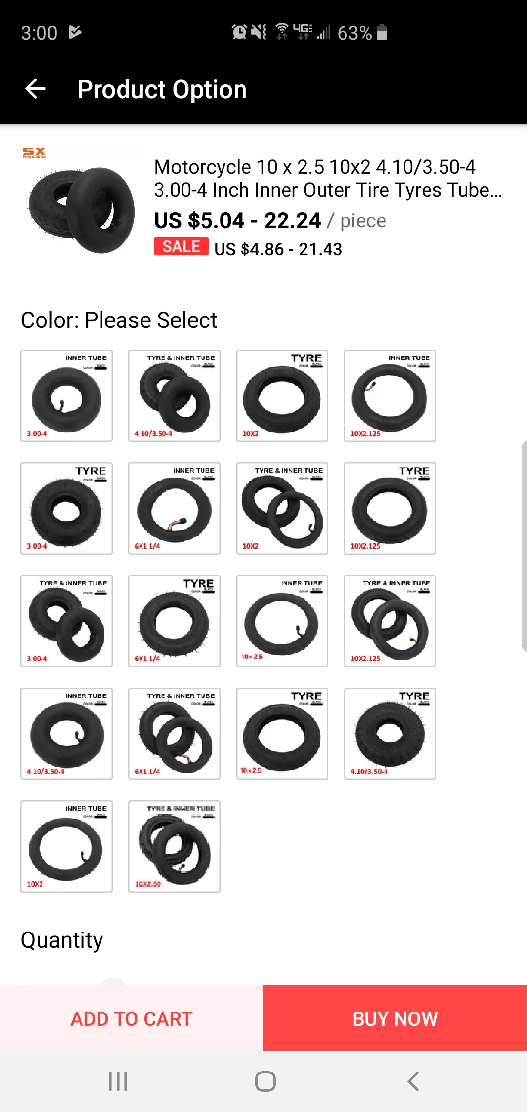

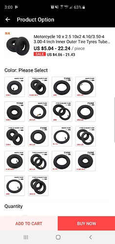

So this supplier theoretically has 11" tires that fit 4" hubs based on this? Second option, they would just be super wide
Yeah, I think putting a 4.1" wide tire on something like a Fivestar is asking for trouble, but I’d love to see it. The 10" tall 3.00-4 might be more interesting though.
Some intriguing mythical sizes… 3.00/3.50-4, 3.50-4, 3.50/4.00-4…
