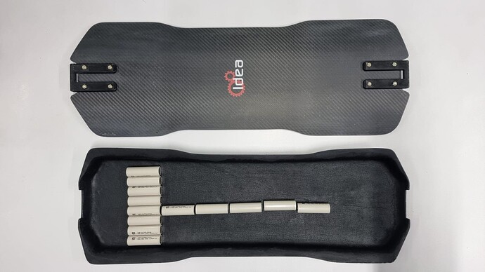

Hello guys:
New project finished here, this time it was a collaboration between @IDEA and eBoardsPeru in order to bring you an amazing deck enclosure option, something different to what is on currently available on the market as the deck is designed to use truck brackets
We started this project back in July and even though this looks like a simple enclosure to design there were several challenges and tests in order to guarantee perfect fitment and room for the biggest battery yo can fit which is 12S4P 21700.
The carbon fiber deck can be ordered from Tom’s via PM and the enclosure from my website here
Will these have mounting holes pre-drilled? As the deck and enclosure are matched?
Unfortunately no, the inserts will need to be drilled by the buider.
Maybe Tom can predrill and preinsert the nutserts, in this case I could addapt the enclosure to match the holes, but would be up to Tom.
Beautiful work :heart_eyes:
Question: 30mm height is that totally height of the enclosure or depth of battery compartment ?
The 30mm is the estiumated depth, but it changes along the width of the deck on the center it has less depth because of the concave.
That thing is beautiful.
Seem like not much clearance for dual VESC setup under the bracket, not sure. :thinking:
Looks great! What’s the logo?
:thinking::thinking::thinking:
Looks amazing! Just ordered one.
Big thanks to Tom and Alan!
Damn! it seems I mixed up the logos, sorry about this Tom, will correct ASAP.
