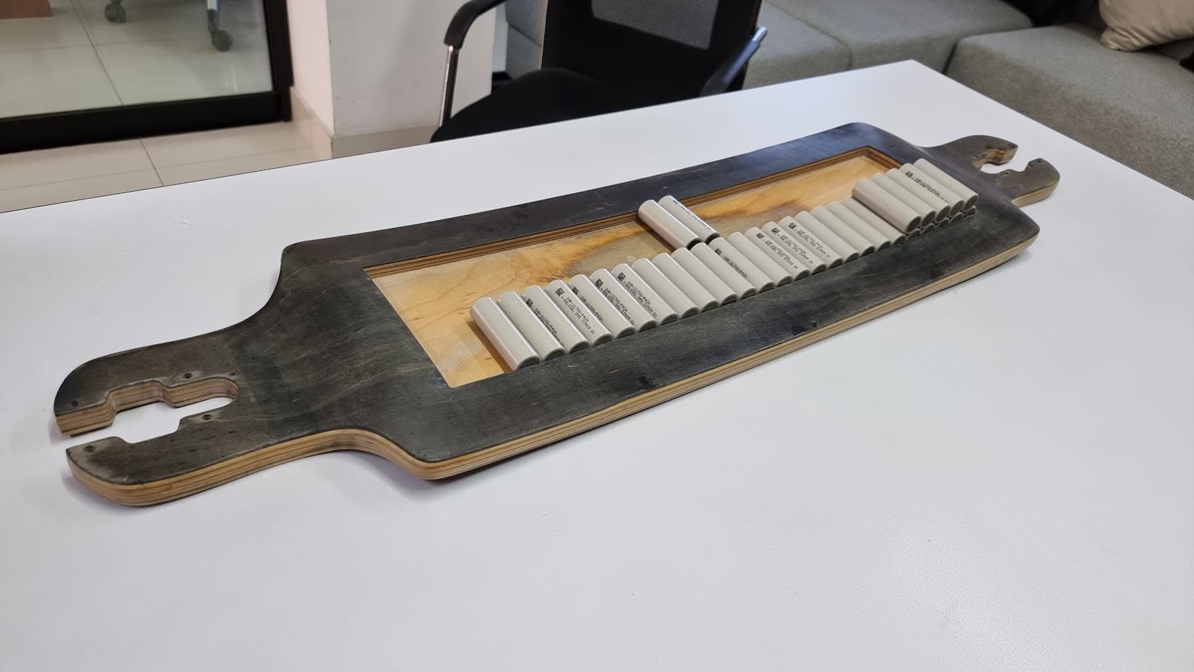

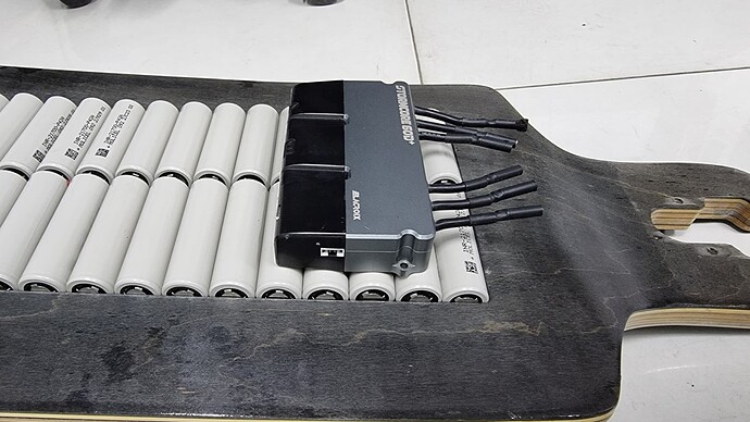

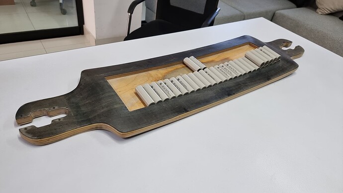

The Hummie deck has an inner cutout capable to hold a maximum single stack battery of 21700 10S4P, 21700 12S4P and an ESC was not possible on a single stack enclosure as you can see on this picture.

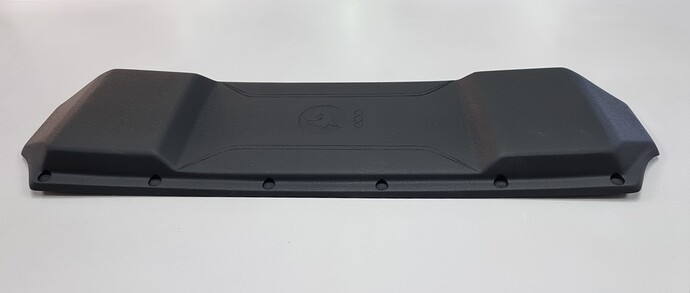

Making a double stack enclosure was not an option because the benefit of the cutout and a visually thin enclosure would be lost , besides ground clearance on the center section would be too low for a drop through deck. So I came up with a double stack on the sides with a beautiful single stack thin shaped belly.
With this design you are able to mount up to a 21700 12S5P battery a BMS and an ESC like a Zenith, Stormcore or Unity.
The enclosure has 12 ring holders and the loo on the center:

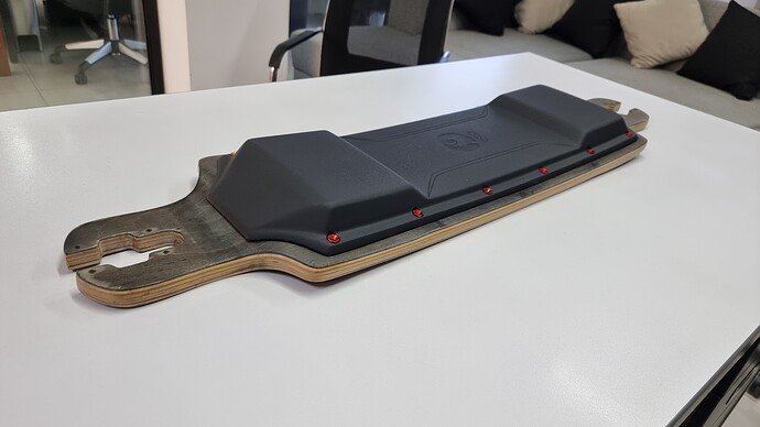

It fits the deck perfectly following the subtle positive camber on the Hummie deck

Very pretty! I personally have a double stack enclosure for 18650’s on my hummie and it’s great. You do want 110mm wheels or larger in a drop-through setup like I have, however.
Its gorgeous Alan! Well done mate!
