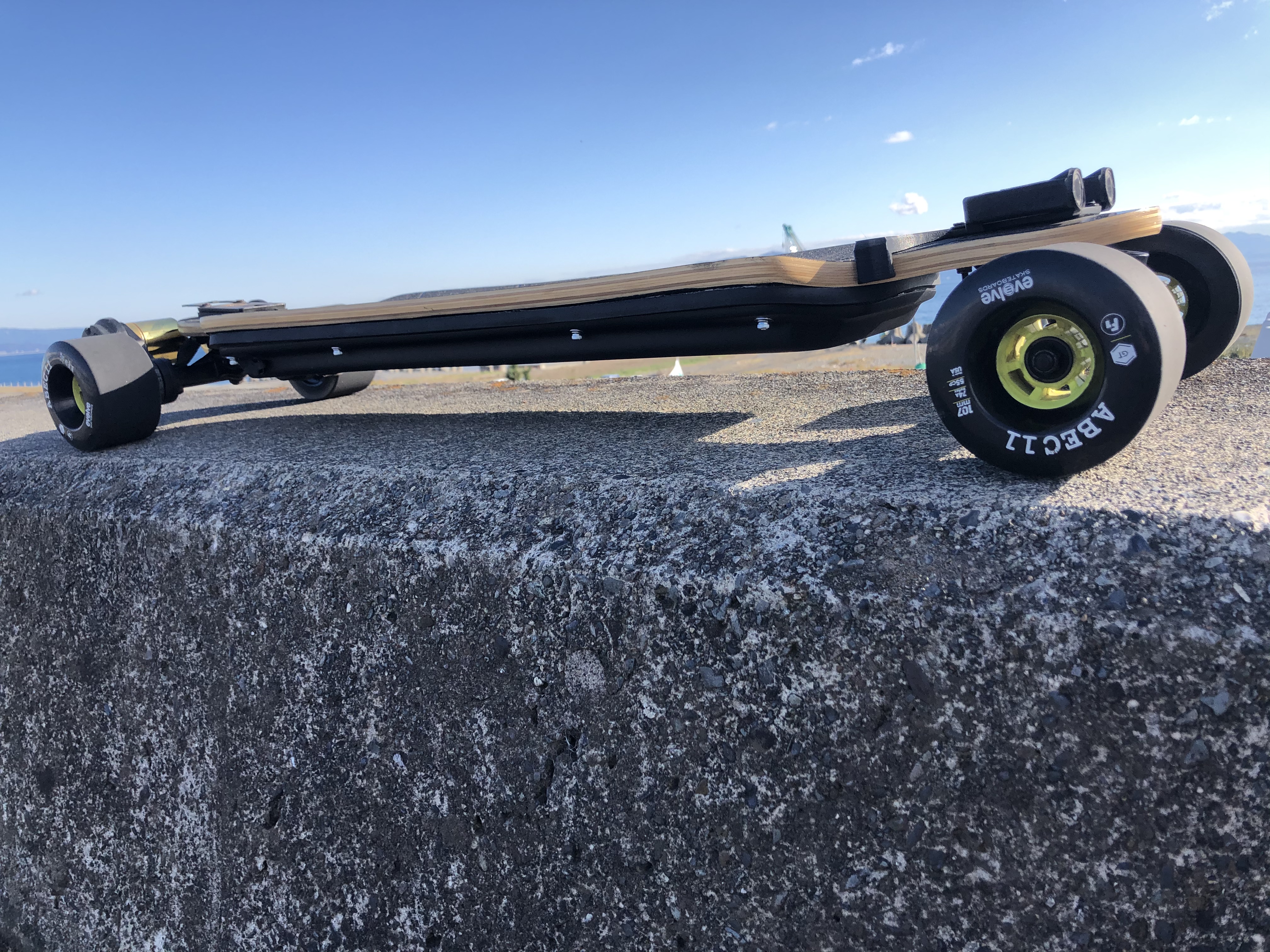

What deck is that?
Subsonic spirit I think. Someone is selling a used one in the UK :grinning:
Yes. That’s the spirit pretty nice short deck with kicktail

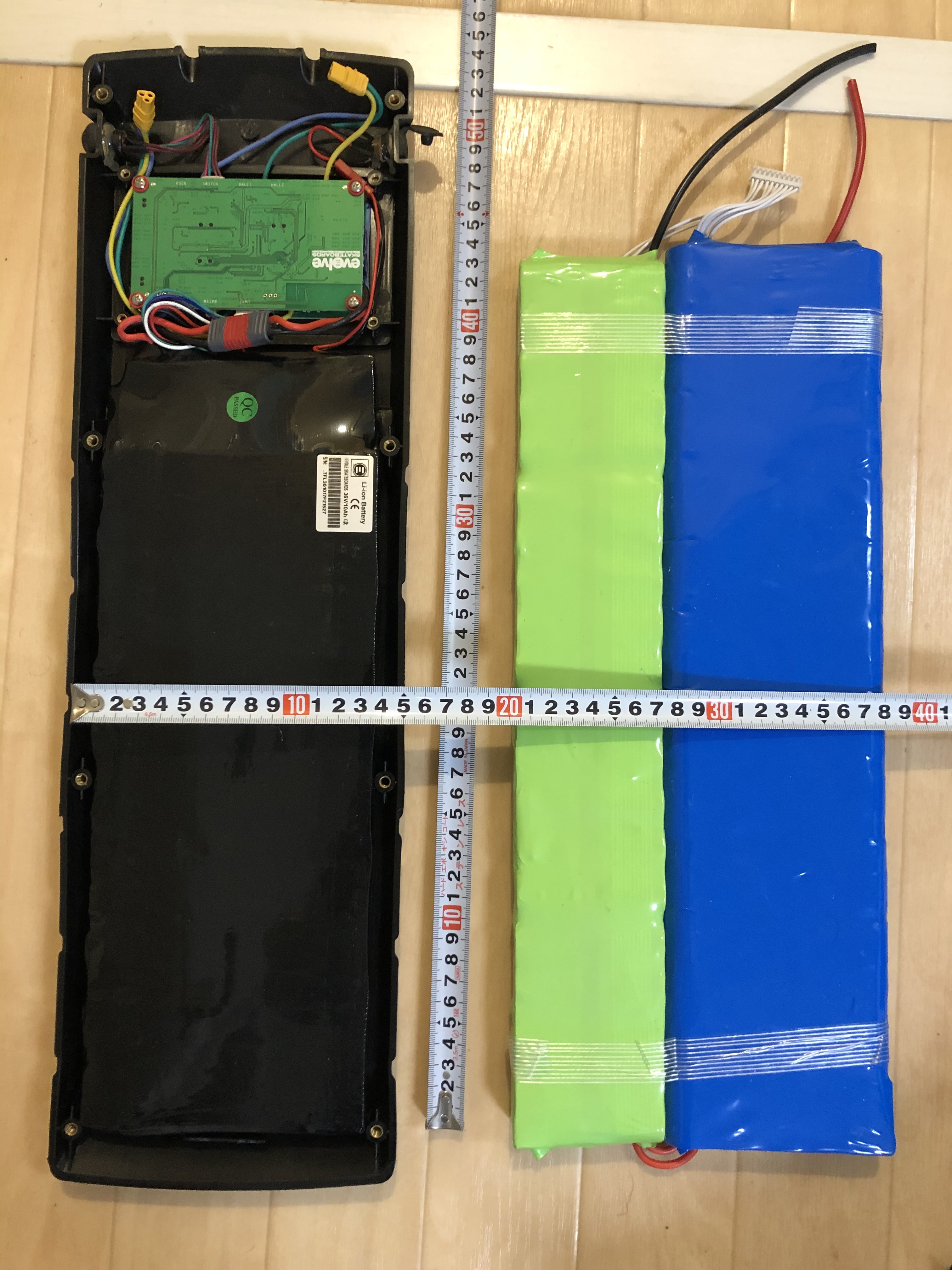

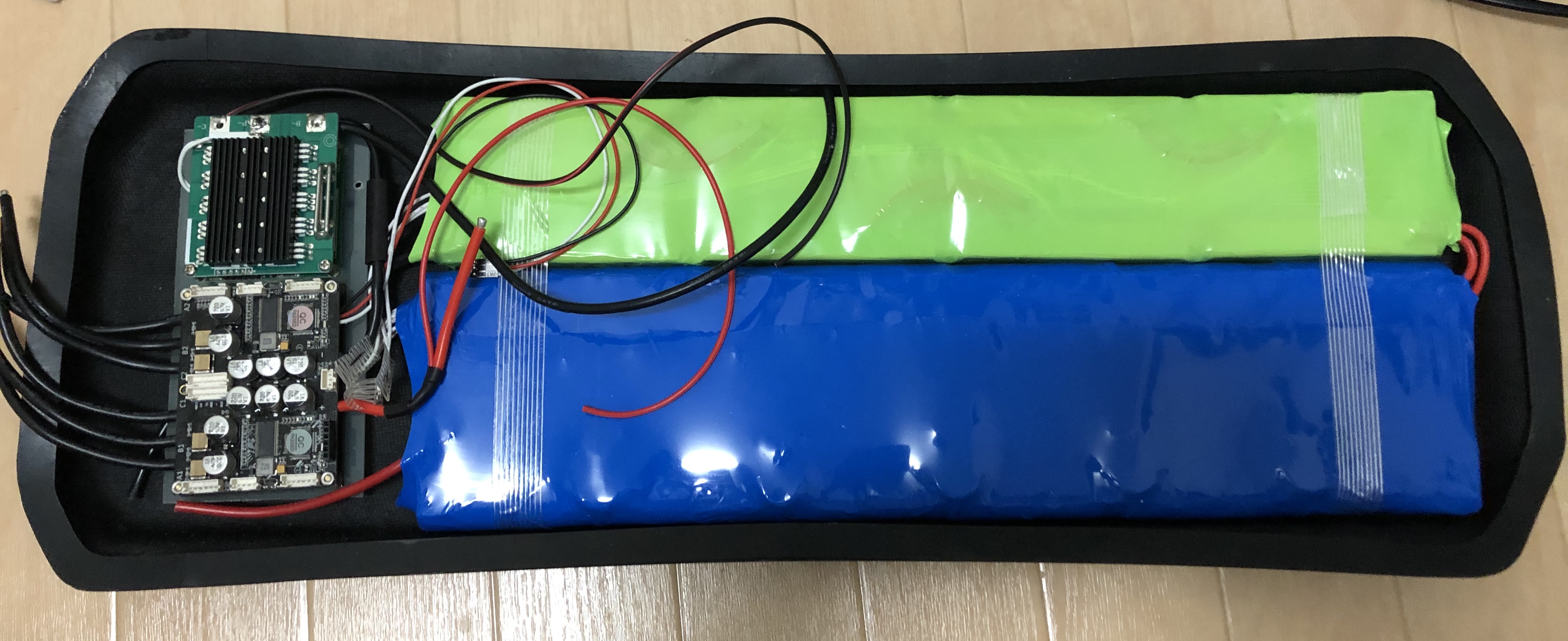

I put Samsung 50E10s5p in GTX. 900Wh. Flipsky 4.20Plus and 35A BMS. It is a very nice enclosure.
Thats some REALLY nice work bro :ok_hand: but is the 10s5p 50e enough? Seems to be lacking in the amps department…
GTR is 35E 10s4p. GT mode of GT series is about 32A. Since Evolve is a double king pin, it can not be very fast. The amperage output is equivalent to the original Evolve, giving the range the highest priority.
When the Evolve motor is moved with VESC, the motor sound becomes quite quiet.:smile:
