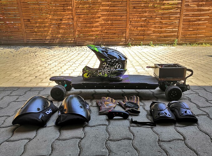

Safety gear:
  • Oneal Backflip RL2 helmet (full face required for this board)
  • Sunglasses to keep dust and bugs out of my eyes
  • Loaded Advanced Freeride slide gloves, moved one puck down a bit to have place to hold the remote
  • TSG SK8 DHP knee pads
  • cheapo elbow pads, might upgrade later because I hate to wear these… Of course I didn’t have them on when I fell either…

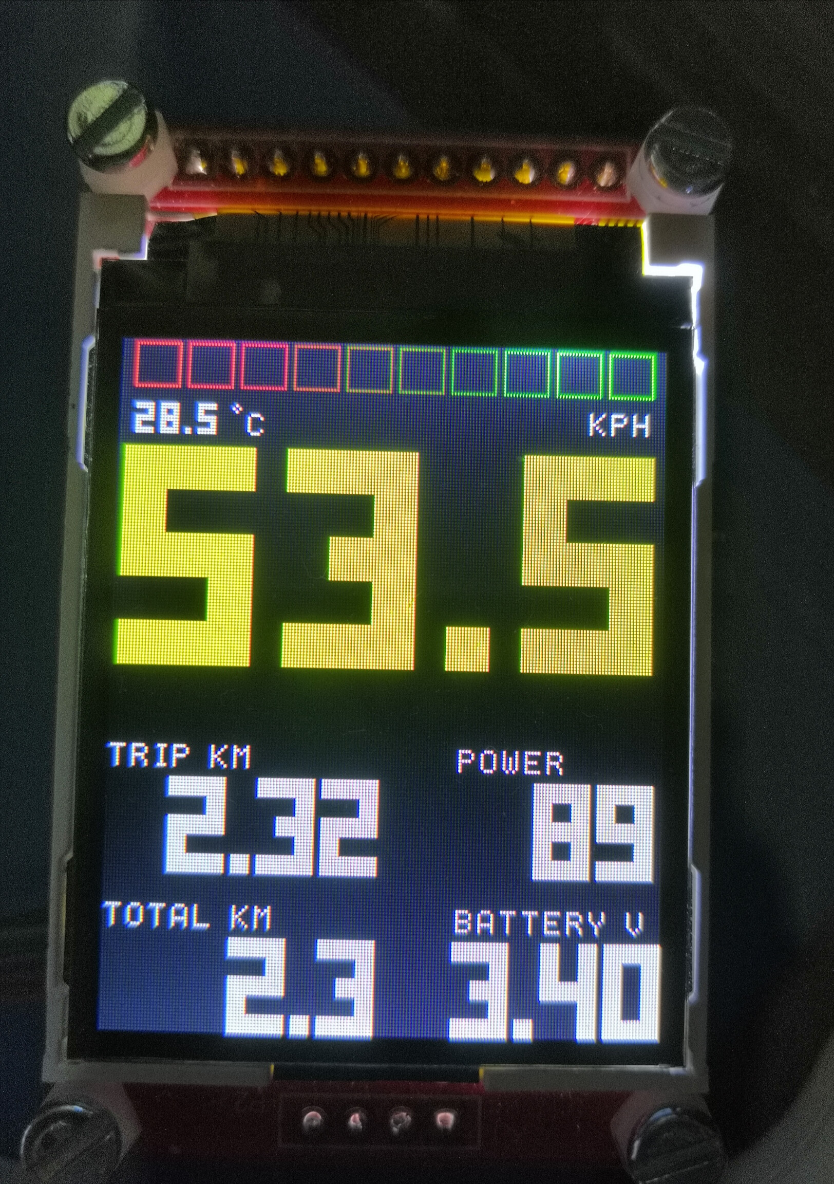

  • Installing a DIY davega, which I’ve already made, but I can’t have bluetooth and the davega installed at the same time on single drive so this has to wait until V3. This is based on Roxie OS, so it’s FW5.1 compatible
