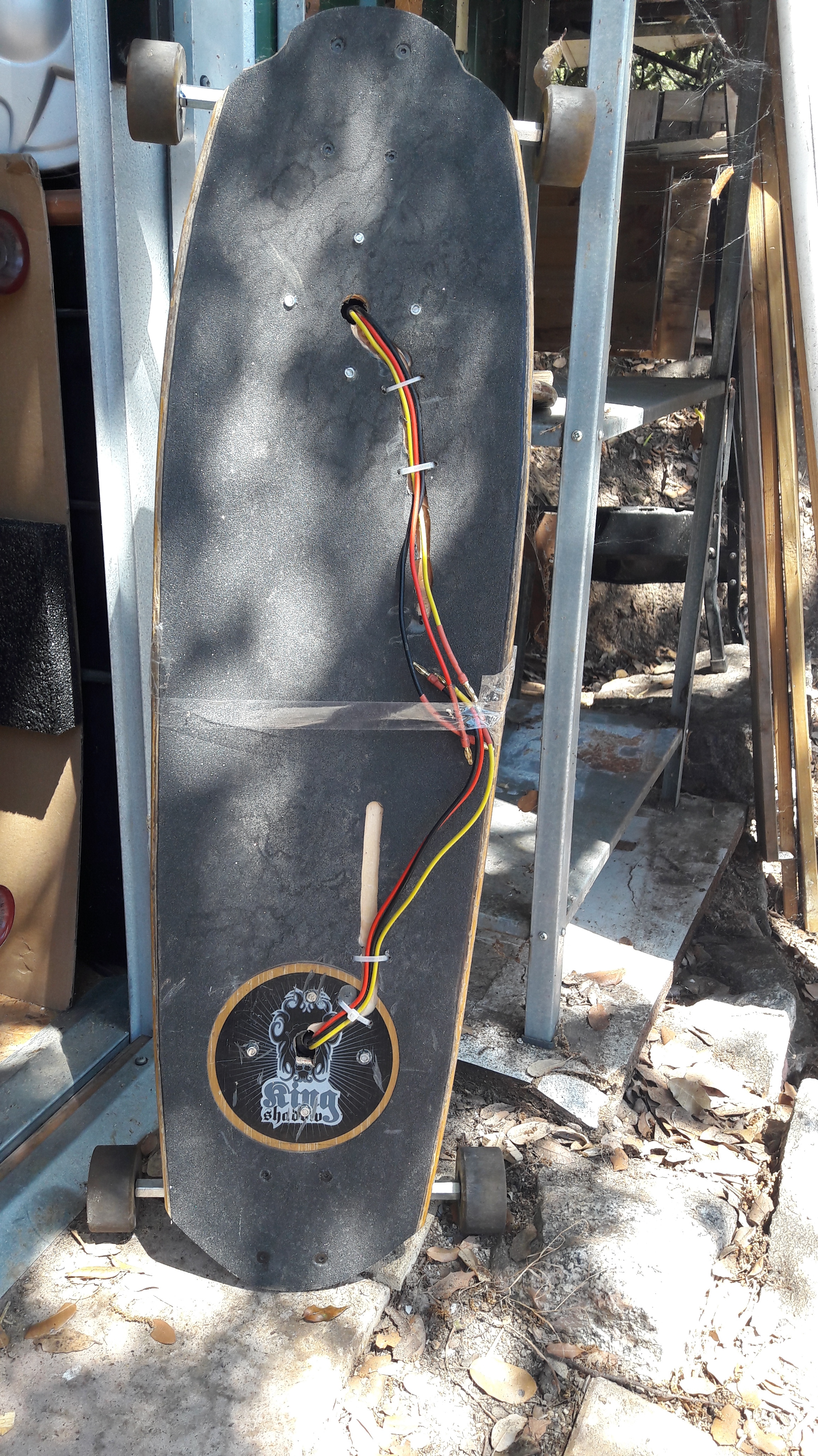

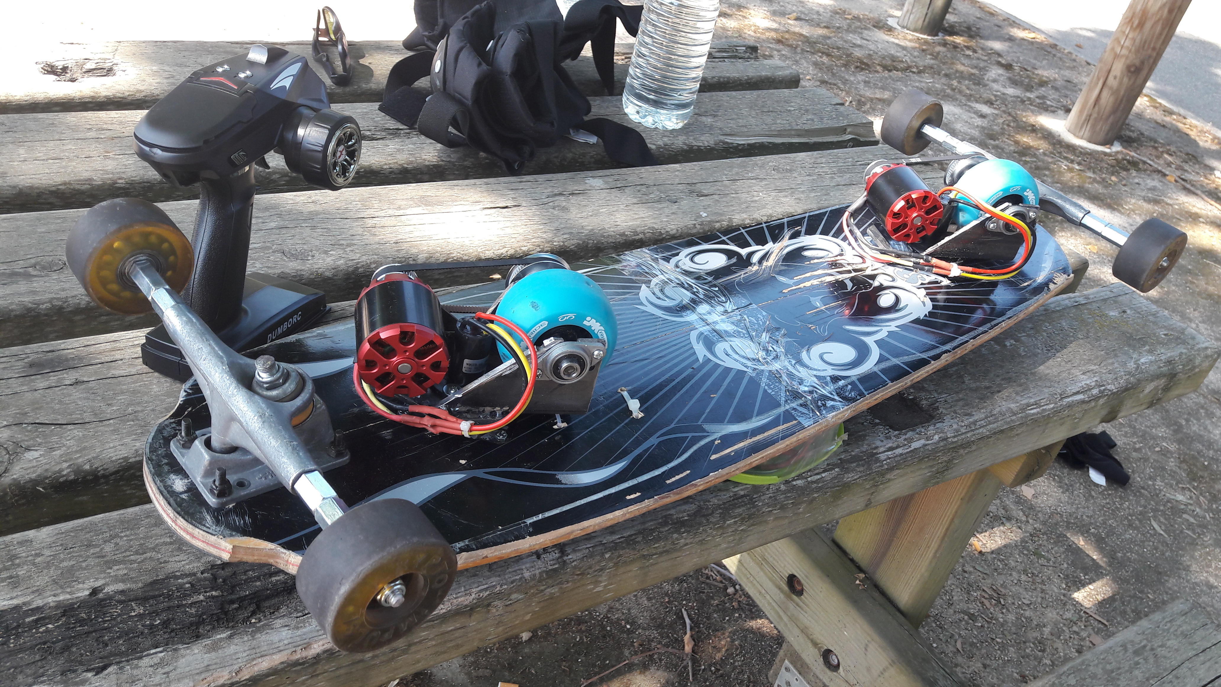

So, i finally got some time to tinker with the boards ( up really early before the kids)
I discarded the idea of modifying the freeboard, i didn’t want to ruin the trucks, because it’s really fun to ride it as is. So i repurposed an old longboard.
It seems to be working, but the motors and pulleys tend to scrap the ground. so i couldn’t really tell.
i will try to raise the centerwheels but unfortunately I grinded off as much as possible on my steel caster. I might try to put a wedge between the lazy suzan bearing and the caster.

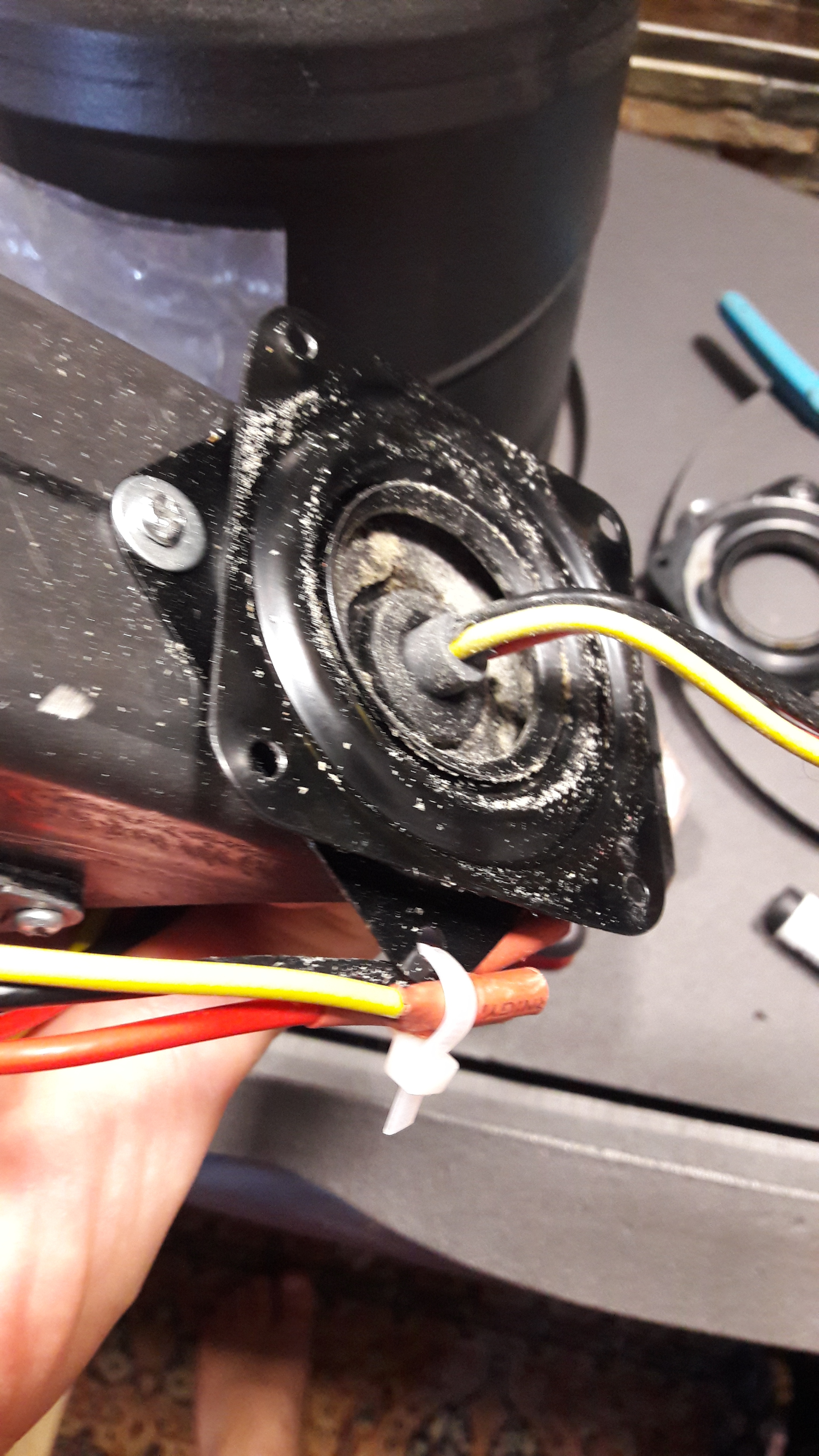

there you go. it’s a combo of heavy duty lazy susans, and aliexpress cylindrical sliprings

lolz at the module spinning but I was hoping to see/hear the motor spin up. Could you also post a picture of how you got the slip ring + lazy susan all mounted and also how you secured the rotor/wires of the slip ring to the deck?

Each motor runs on a 4s lipo battery, and it seems punchy enough. Due to the ground clearance issue, didn’t get to test the drawn current though.
Also, i went downhill without the motors last evening to testdrive the board, and it seems i have missalignment issues

How much amp can you put through this slipring ?
I don’t really get how did you attach the metal part you made to the lazy susan, could you show a picture of it ?

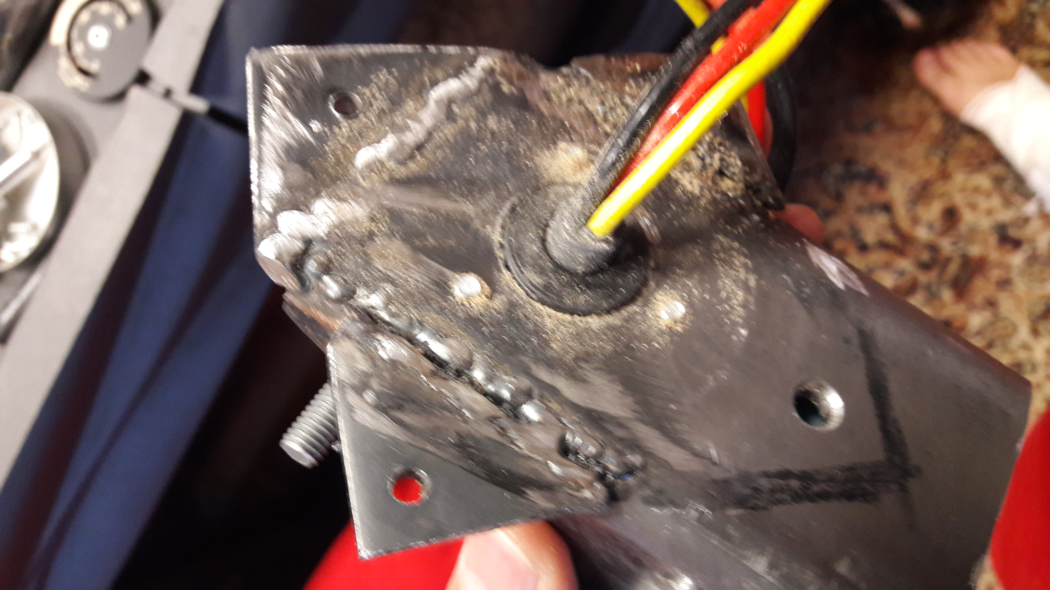

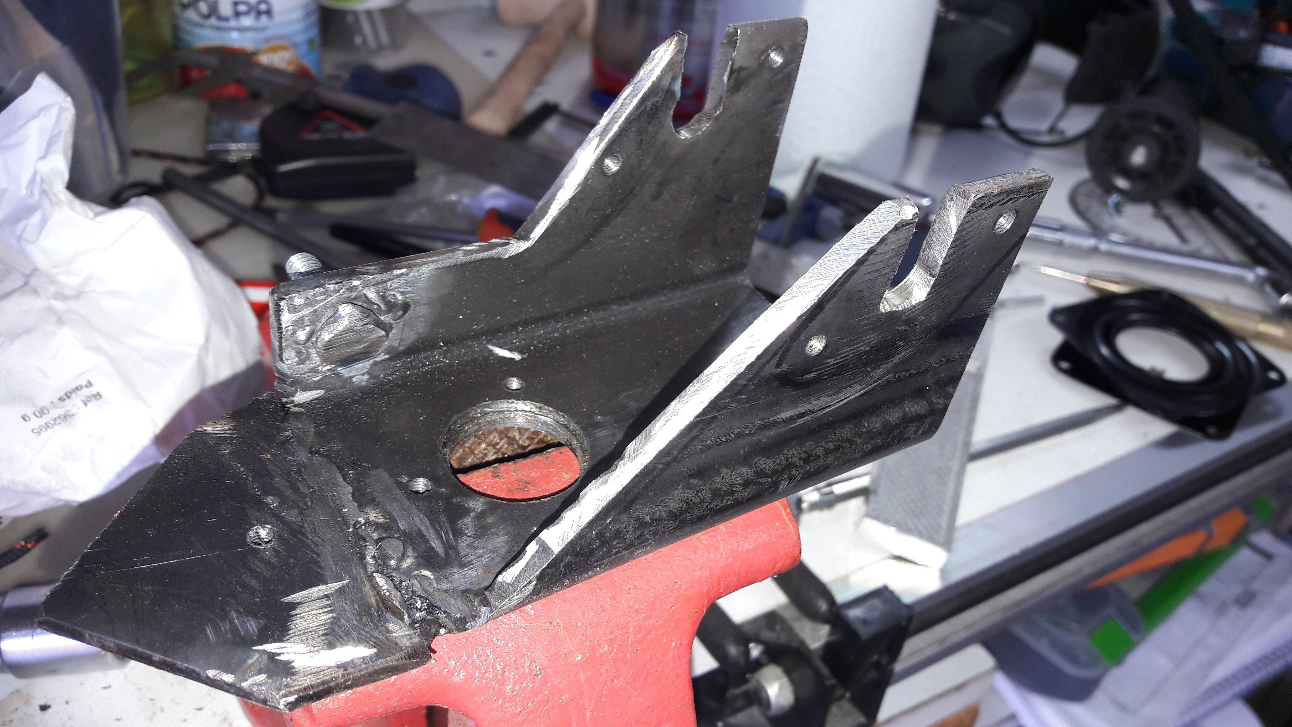

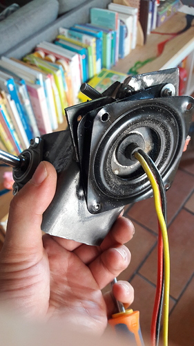

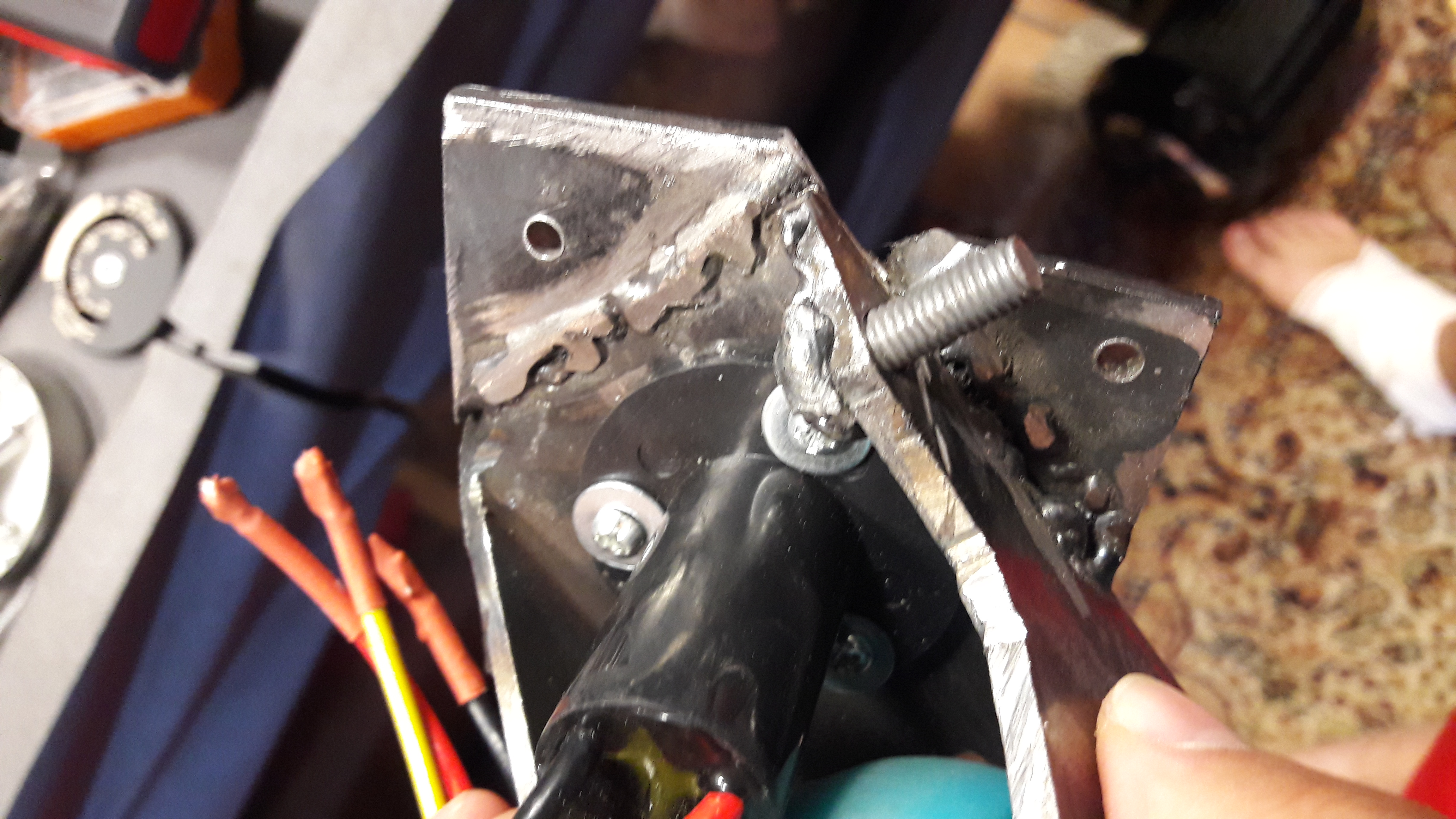

I snaped some pictures about the lazy susans bearings instalation.
I welded some metal to the U steel frame, so they could be bolted on a solid baseplate. One of them is a bit bent, but the tapered holes were not properly aligned. I have some doubt about their longevity with all the radial forces, but we will see.
The sliprings are rated for 30amps. They didn’t blow up yet. I could start from a complete stop the last time i tried. Seems ok.

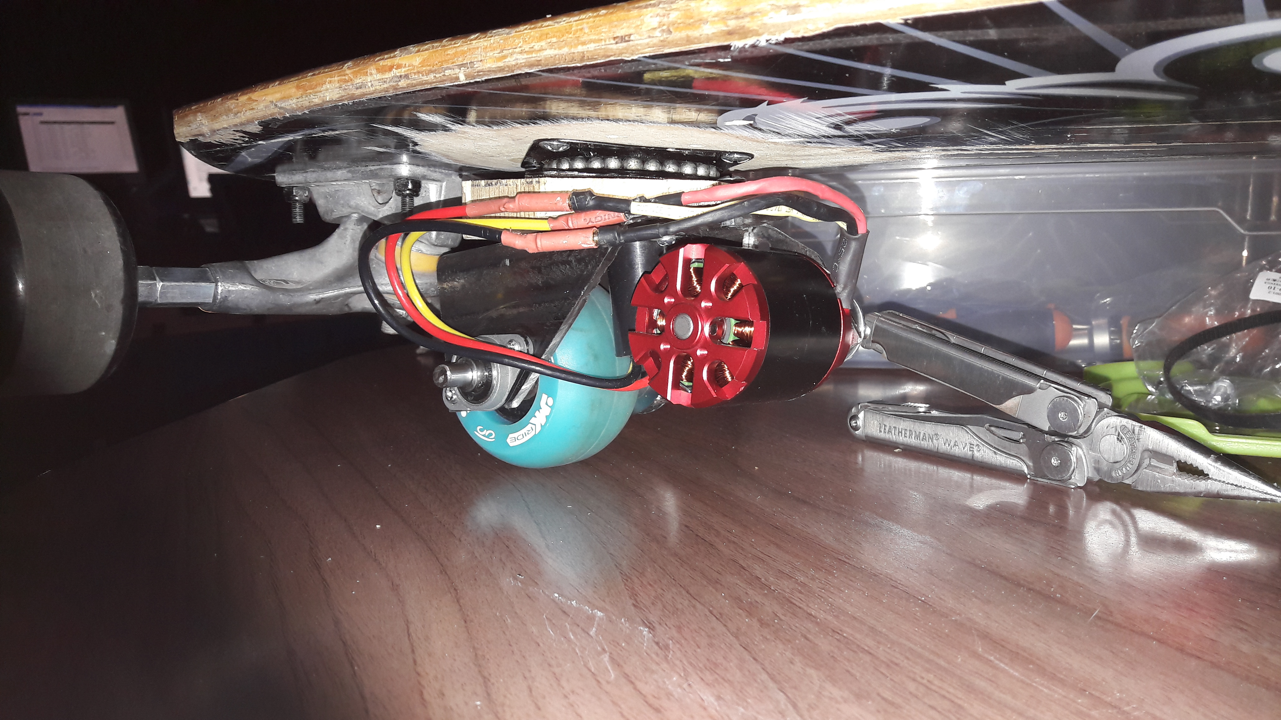

So i brought the toys at work tonight. Working the night shift alone.

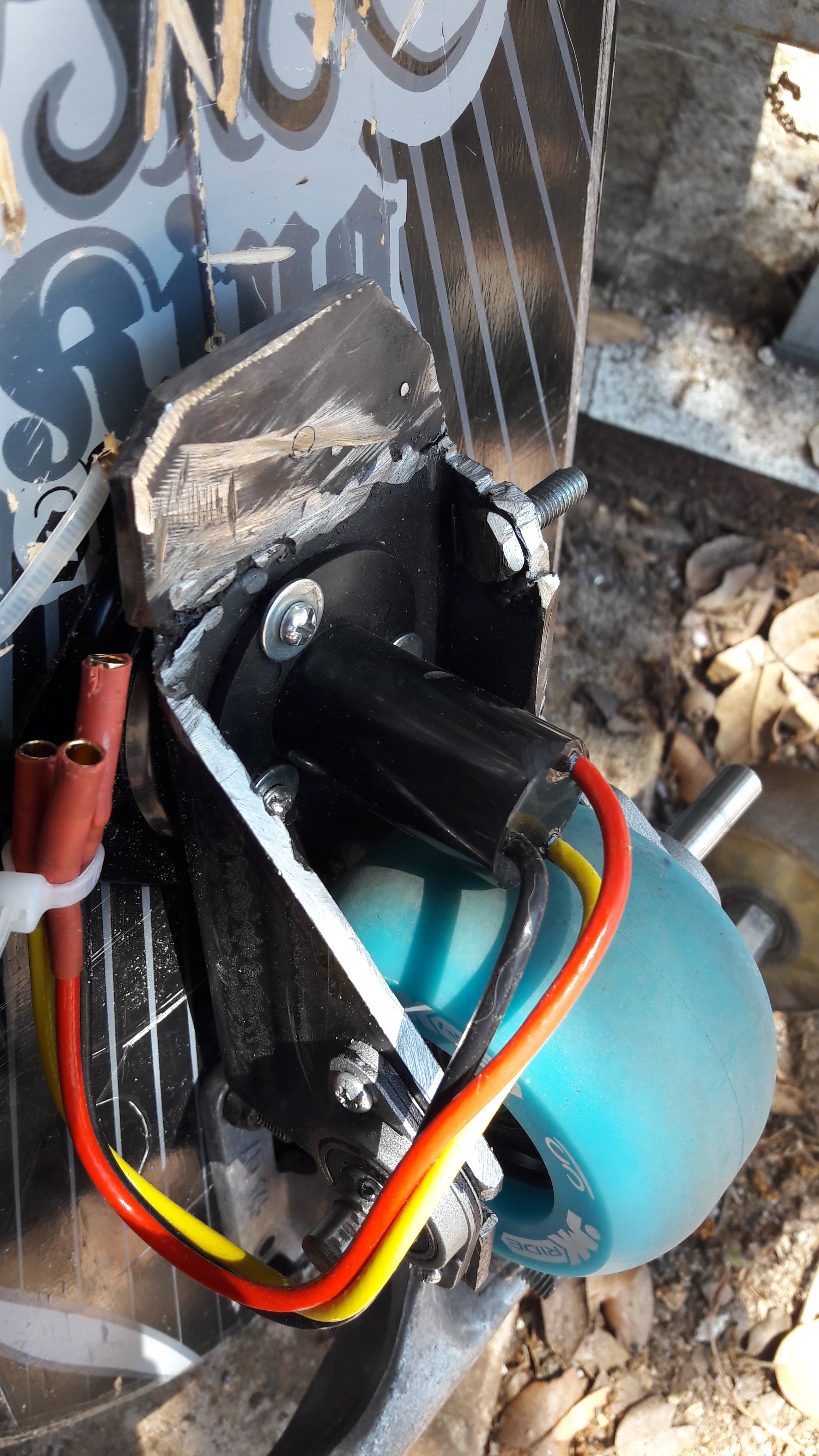

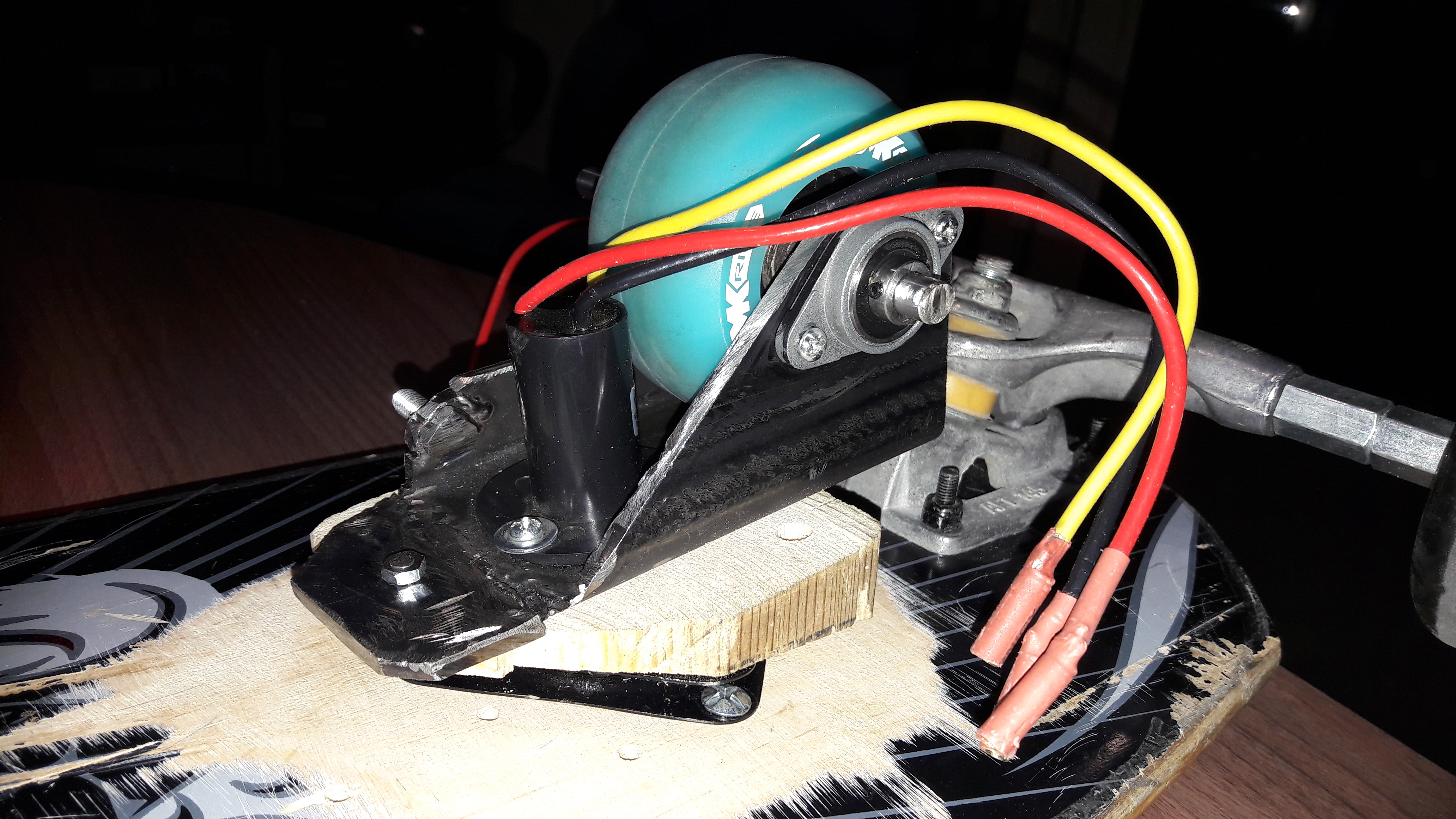

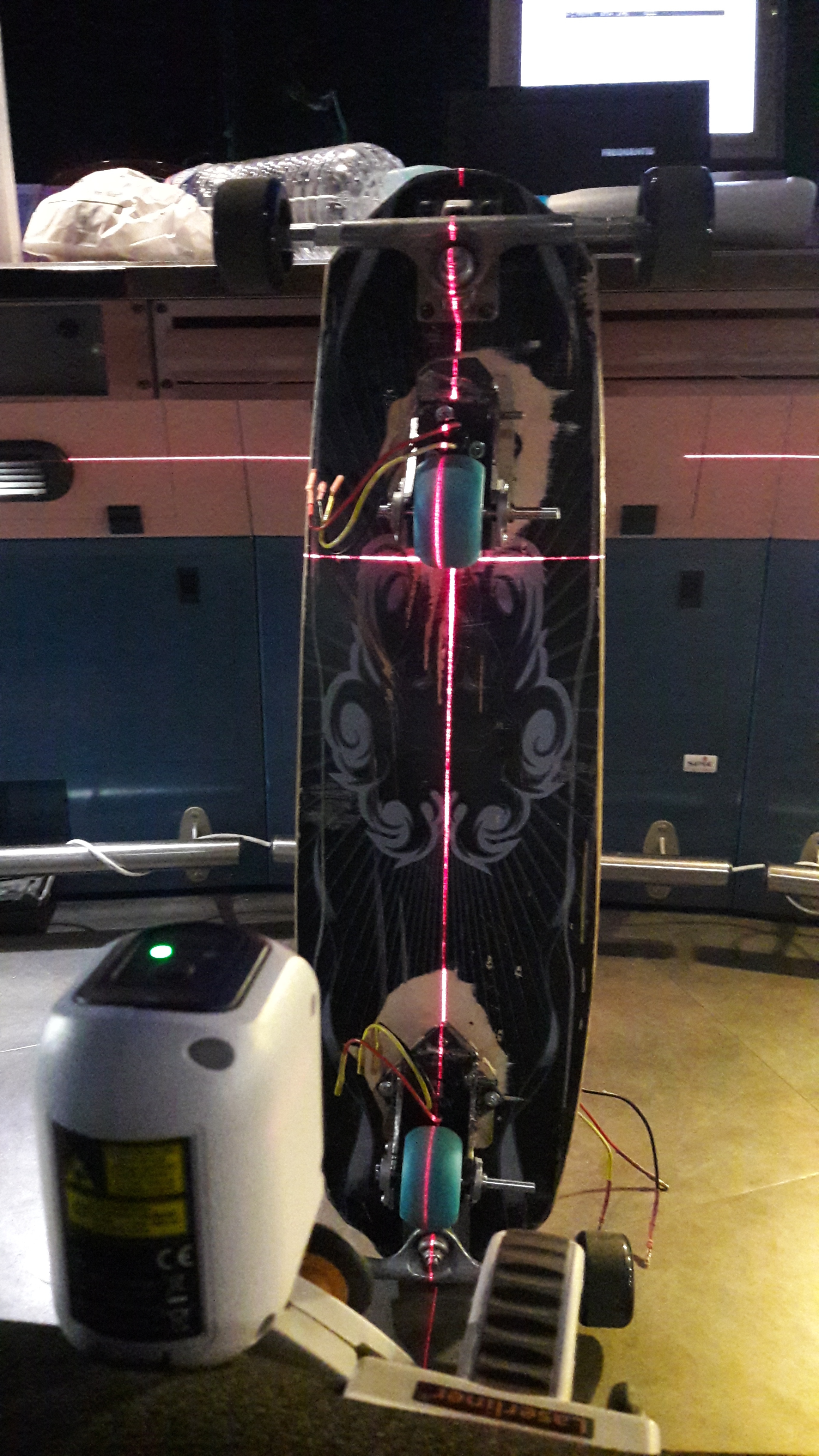

This afternoon i made a very crude wedge, to improve the ground clearance of the motor
I still need to cut down the flange of the wide wheel pulley.
The motor sits higher, but i now understand why the deck needs to be stiff.
Alignment check
I only forgot one tool, the 10mm socket, and guess which one is needed to properly tighten the motor…
But,It seems to work.
I will need some space to test it, seems sketchy as hell though !!!

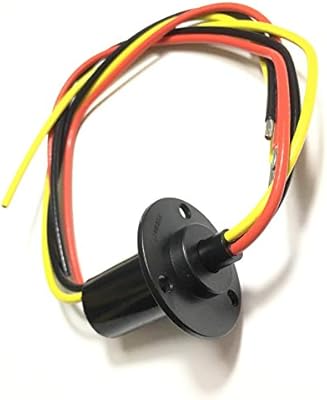

I am curious about the wires coming through… If you rotate the center wheels however many times, do the phase wires wrap up as well? If so, how are you tackling that? Just planning on not doing too many 360s?
Those are the dirt cheap capsule slip rings you can find all over ali.
My new design revision for the E-Caster is built around them, with two versions one for the 21mm diameter and the 30mm diameter variants. Given how well it looks to run on the 3 wire 21mm ones I’m not sure I’ll need the larger one but I still want to test.
