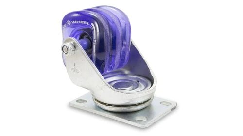

I was looking through the Shark Wheels website and came across these:
A sturdy looking caster with a 8mm shaft and includes the correct spacers for a skate wheel…
That $99 price includes 4 casters and a set of wheels that cost like $50. My main concern about it besides the price is that it includes a 70mm wheel and looks tight so the 72mm JMK Ride wheels might not fit.
So I emailed them to ask if I could buy only two casters without any wheels for hopefully like $25, and about the wheel size that fit.
The reply was to give them a call, I’ll have some answers to my questions.
I guess that caster is available elsewhere like on aliexpress but I just want more info about it for now.
Called them, 72mm wheels fit. Each one is $12, the caster is as strong as it looks he says.

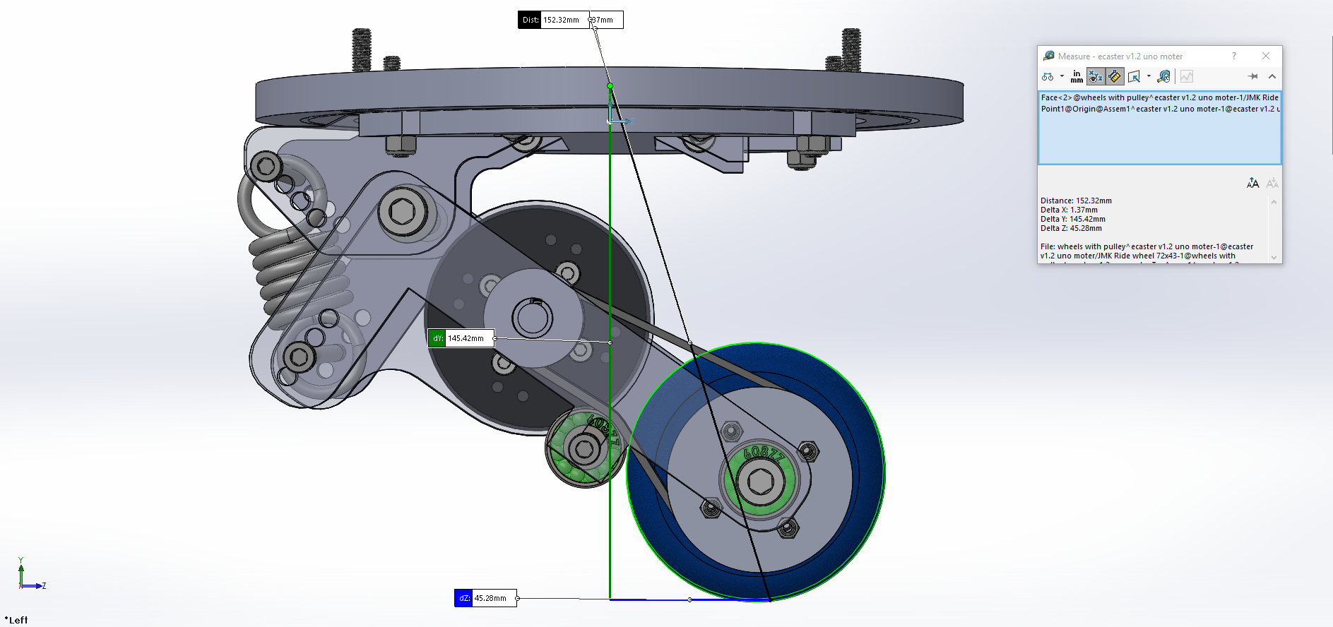

got me inspired to make a design that is I think more akin to what the gentlemen I found on instagram designed, minus the custom slip ring but I’m thinking about it.
preview of the idea:
For the suspension pivot I’m going back to brushings.
Improvements:
  • I think 30mm id is too big/heavy but something like 15mm I would worry about breaking. 25mm may be the sweet spot.
  • I could work a freebord-esque cam into this design easily.
  • Possibly make it removable easily
@alexincorsica ok I worked on the JMK ride wheel model and it should be near perfect
JMK Ride wheel 72x43.SLDPRT (415.5 KB)
a 30mm bolt circle might not be perfect I think a 31mm would fit better, so I need to change my pulley model.
