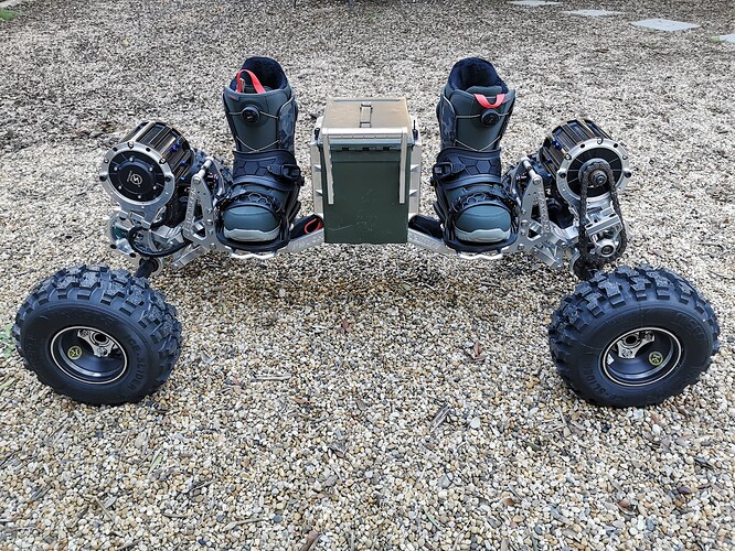

I’m fairly confident this is the highest voltage board on the forum / ever built on planet earth (100.8v :rofl:).
CHIMERA | Red Ember Jotnar | Tronic 250R | 24s3p | all the amps - DIY Builds - esk8.news: DIY Electric Skateboard Forums
This is a work of art. Is there a build thread or details posted anywhere?
Yeah E-TOXX is outstanding! :heart_eyes:

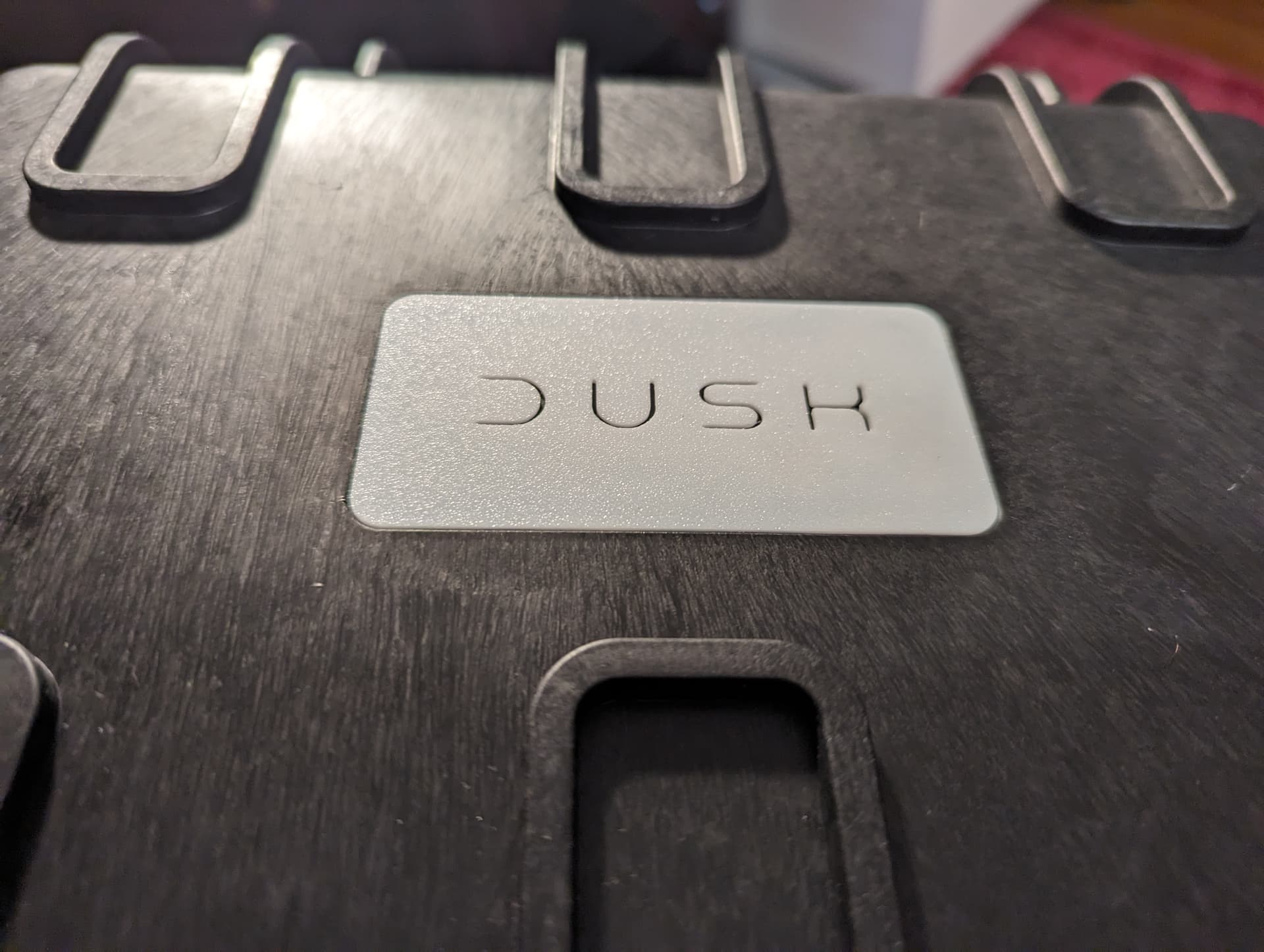

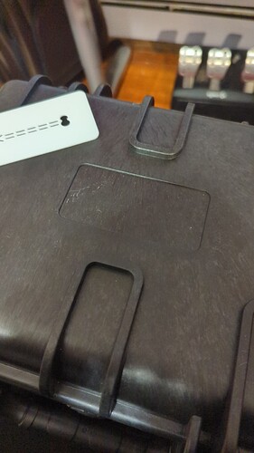

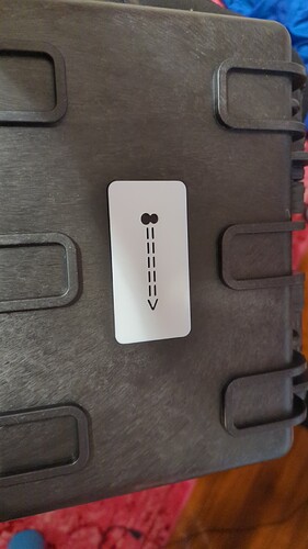

Also removed the ugly PURE OUTDOOR sticker on my box and printed some name plates.
That first plate looks good. It is weird though, im not sure, but 8 cannot be “equal” or “equal to/smaller” at the same time. And i think you also forgot your second value for the equation.
If i may suggest a variable for behind your formula: - (i)

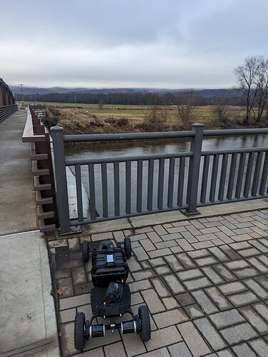

First ride after a rainstorm. Board works like a charm, but my efficiency is awful. Somehow these jump drives have much more rolling resistance than I was hoping for, but I just installed new bearings, so I’m hoping they just break in nicely.
I noticed my efficiency jump up a little after i installed my new motor. The only thing i can think of is that i put too much grease in. Did you use a lot of grease?
I don’t think so. If it is too much grease, the excess will get flung off soon.
Yeah but there’s not a lot of room inside the case for it to fling.
Here’s what I would try
  • Loosen the backlash a bit
  • use minimal grease (or lighter grease , still NLGI-2, like superlube)
  • pump tires to 40psi
You spelled 50 wrong
Tire says 80psi. I paid for them. I’m using all of it
(I’m running 45psi)

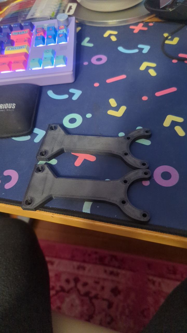

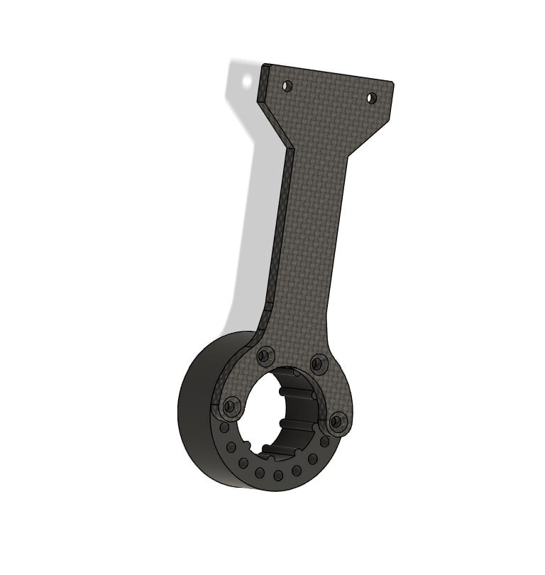

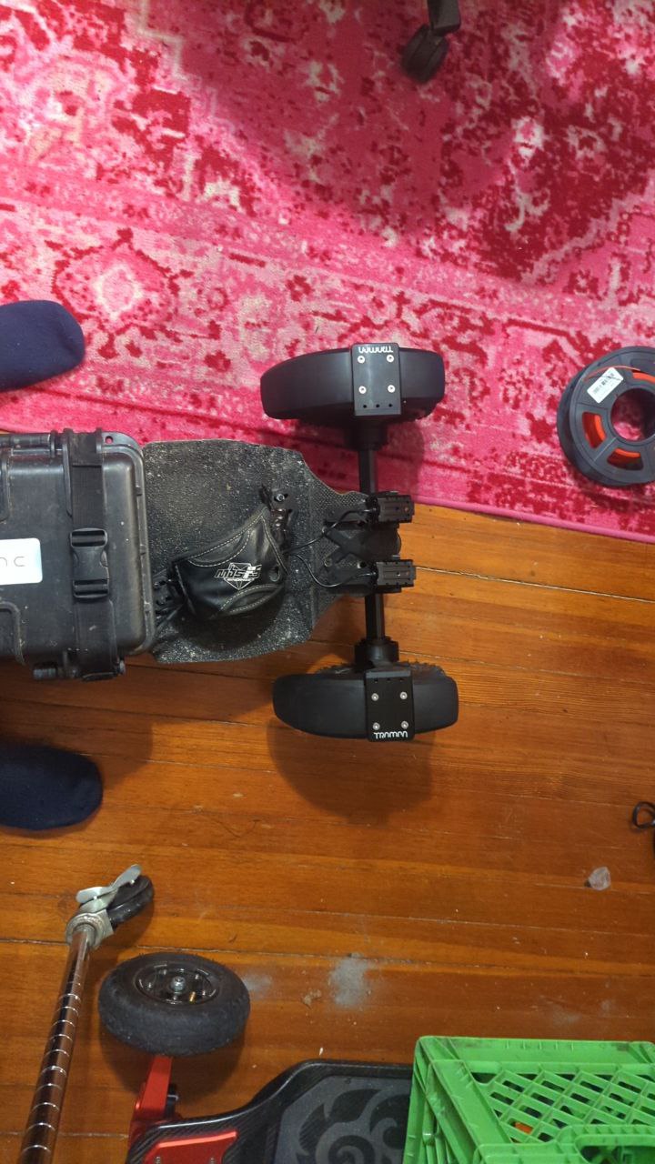

Bought trampa’s mud guards after being told they’d fit a 22mm^2 hanger. They did not. That was like a year ago or smthn, I finally got around to designing clamps for them and attaching them to my board
