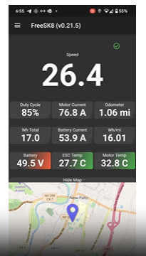

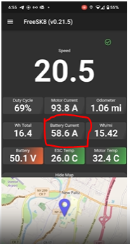

This is for a single motor/ESC side.

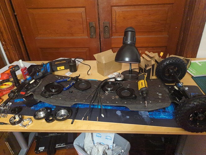

One carvepdx beach ride worth of sand destroying my bearings later…

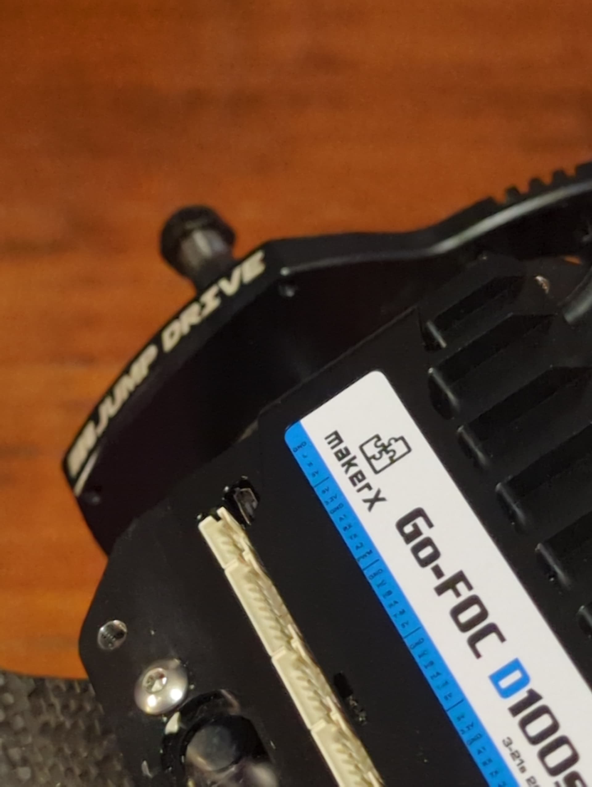

Bringing this back better than ever. More rpm, more volts, more amps, more better, now with jump drives!
59.5v to 49.5v . Holy voltage sag homie. How many peez you rocking on that torquey boiiii?
That was a 16s3p running 100 batt amps
“I paid for 30a discharge per cell I’m going to use it”
You Sure About That I Think You Should Leave With Tim Robinson Sticker - You Sure About That I Think You Should Leave With Tim Robinson Are You Sure Stickers
Freesk8 app doesn’t support can escs on fw6.0. Quite confident. It would be impressive getting acceleration like that with just 60 amps.
Also, you think I’m getting 15wh/mi?
Yeah my point was that one side is at 58a battery so it’s reasonable to assume 116a battery total, a bit over 100a. Is that wrong?
The battery limit isn’t a hard limit. It almost always overshoots on any board I build :man_shrugging: metroboard is limited to 160 motor/120 battery overall and routinely hits 170 phase and like 130 battery.
I think I’ve seen 120 reported on a freesk8 log for the mountainboard.
Ahh that’s interesting. I never knew that. Seems logical it would be a hard limit. :confused:
Only hard limit is ABSOC. the current settings are functionally targets.
Kinda the same reason we can trip abs overcurrent by suddenly having a spike in rpm. Lots of math required to control current.
Yeah mine always overshoot too lol
