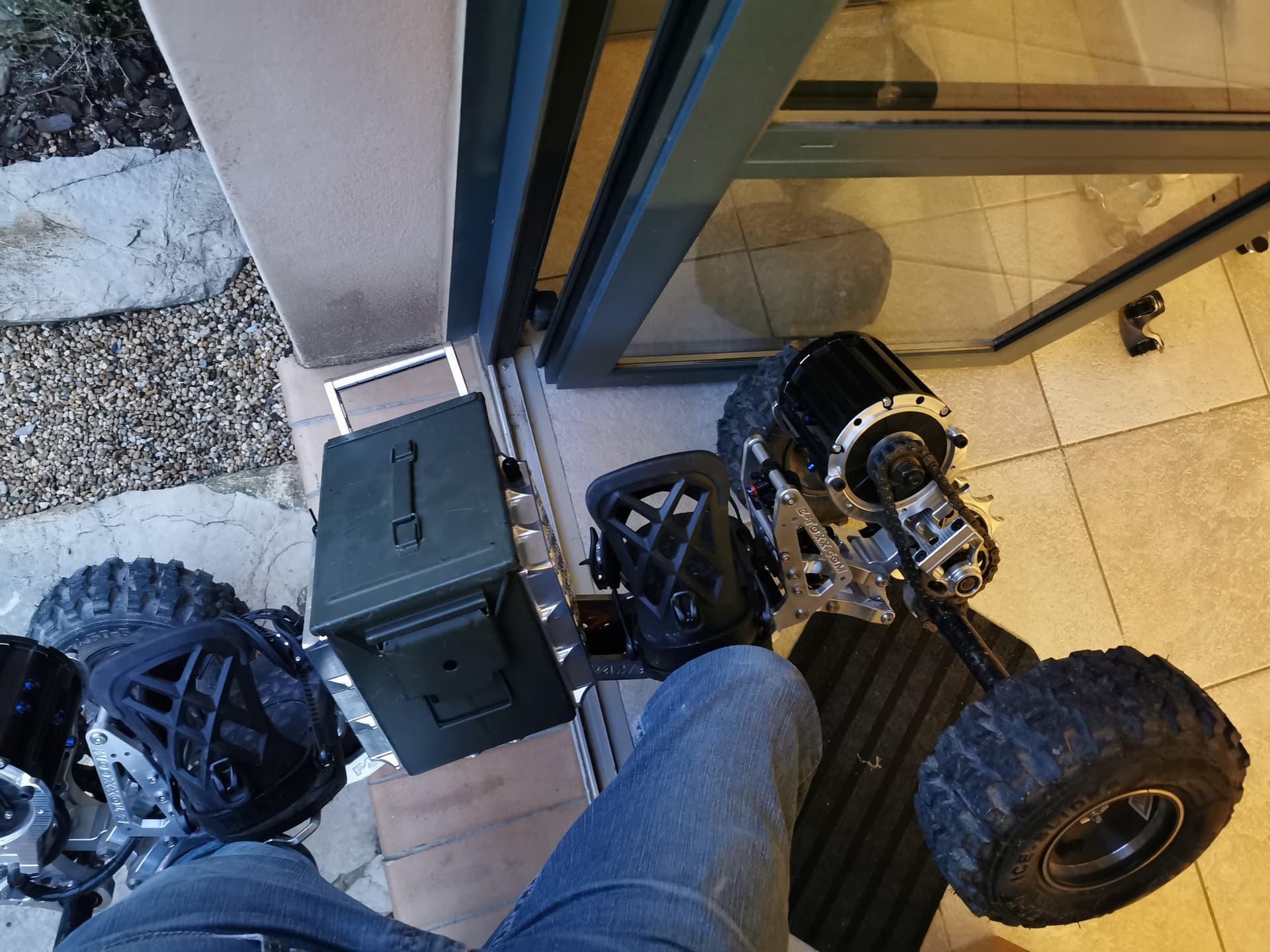

So I finished assembling the whole chassis. It is thought to be quite simple. I just had a few problems fitting the ROCKSHOX spacers into the shocks. Tolerance problems linked to these spacers from ROCKSHOX. I had to file one inside because it didn’t move freely around the rod. Jens had the same “concern” for one in four.
It’s really nice how the shocks feel, it’s very different from the flex of our wood or composite decks.
For the motors, I ordered them directly from QS MOTOR. You can no longer order for more than 150 EUR on Aliexpress when you do not have a VAT number, in Europe. I contacted Harry Zhou (sales@qsmotor.com). The price: 2000W Mid Drive Motor: USD190.00 / pc. Shipping to France: USD215.00 for the two motors.
Both motors were shipped at the same time by UPS, but so far I have only received one fairly quickly a week ago. The second remains “On the Way”. It worries me a bit, but not UPS …
I manage to carry the complete frame quite easily with the four wheels mounted. It’s not that heavy and the honeycomb platforms make it easy to grip. We will have to see if it remains “portable” with the two motors of 8 kg each, but two can do it. I think to separate the box of ammunition with the batteries and the VESCs for transport and storage.
I ordered 5 Lipos Tattu 4S 22000mAh 30C from GenAce.de to supply two VESC 100/250 from Trampa with 20S. I did not find a Lipo 6S 22000m1h in 30C, but I should perhaps have gone directly to 22S (the limit of these VESCs, counting the spikes). Jens already has motor sprockets available for this voltage. The motors are rated 72V and I am already a little beyond in 20S. But given the size of the machines it would surprise me that they could not take more.

Today is the day, first ride!
Getting the +60kg monster out of my living room was difficult because it’s larger than the door!
But it was worth the effort !
First impressions : it’s really great!! It’s not made for road obviously but locked diff is just what I need off-road. I didn’t expect turning would be so easy, even on road. You can go anywhere!
