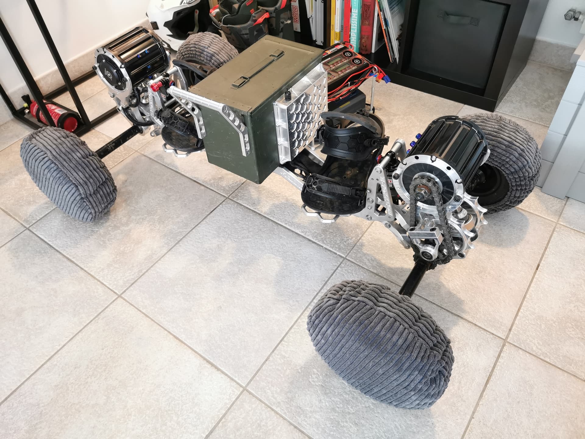

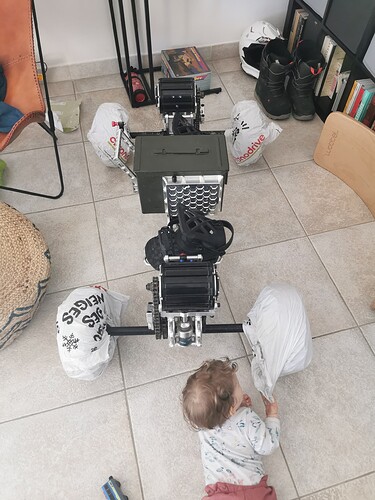

I needed wheel bags to allow the monster to slide on the floor (because of locked differential), and store it with dirty wheels in the living rooom.
I could not find 11 inches wheel bags, anywhere…
First version :
Second version :
30-30-10cm suits perfectly these 11x4,5-5 inches wheels!
:grin:
Nice, love your kid in the pic! Kids are the best ever, soon they are 13 & 15, taller than you and pick you up for fun.
Luckily for me it will take,3000,clones to ever beat the original Homer(or so I tell the clones,not sure why they are already bigger than the original Homer,disturbing!)
Im sure that slides fine, but you can add appliance slider feet thingys to make it slide better if needed . (Sorry if I got to Technical with terminology)

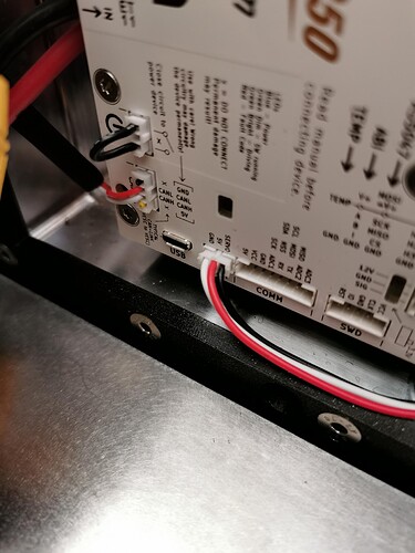

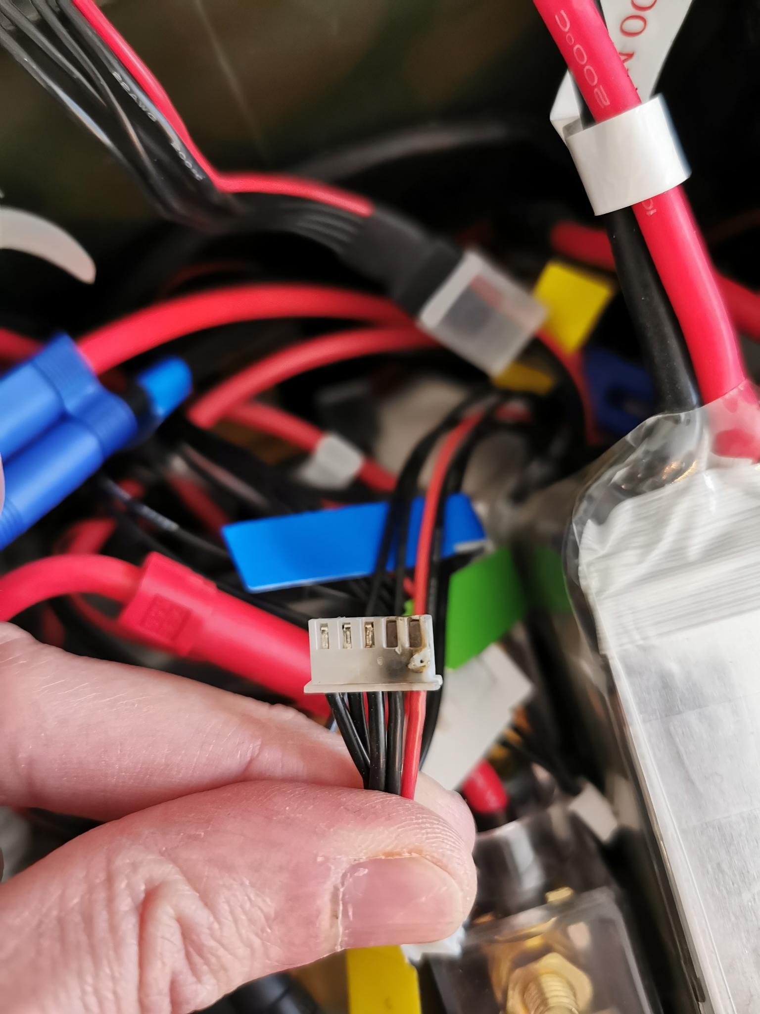

To help everybody to avoid that kind of issue!

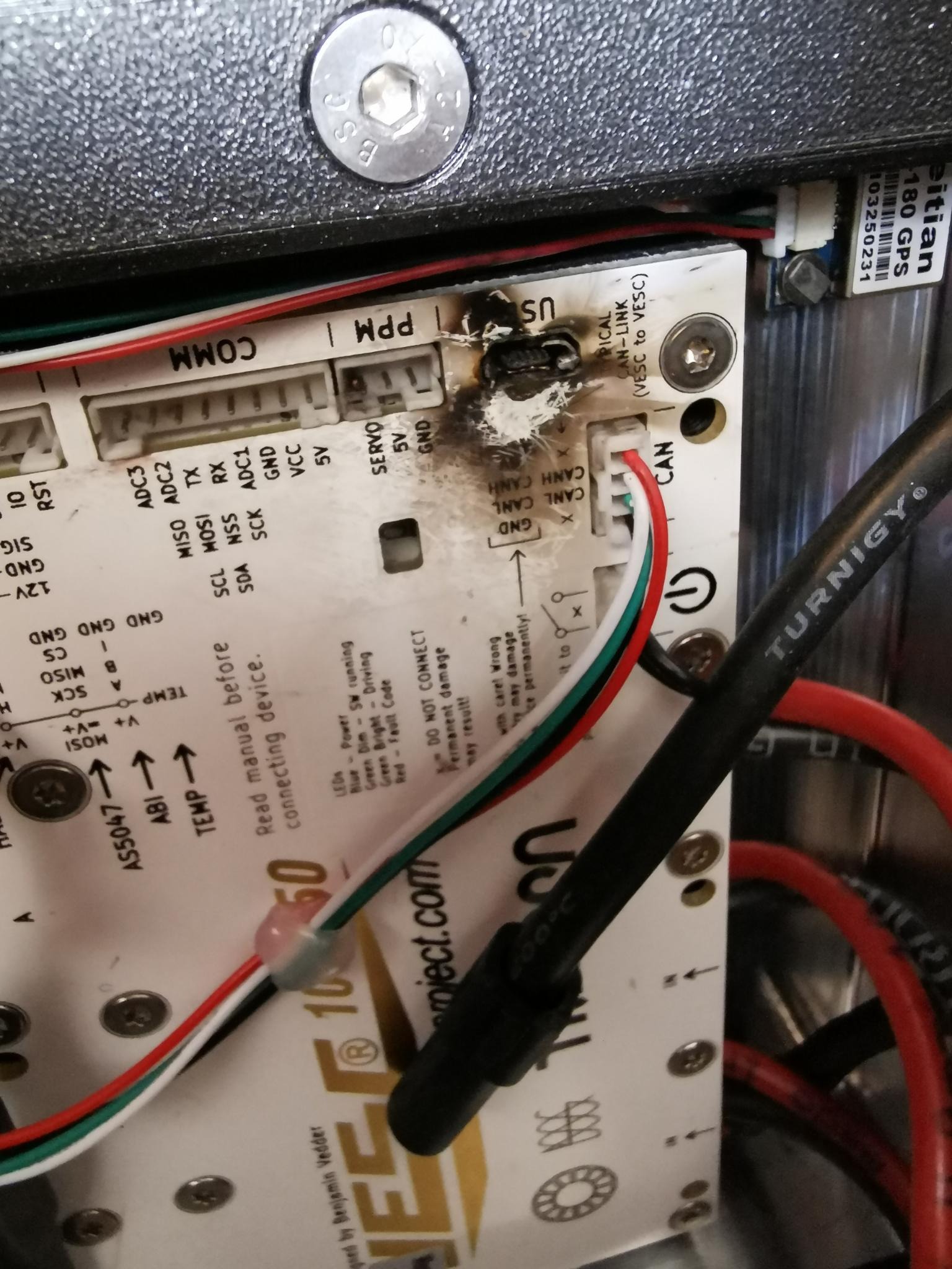

Something awful happened :
Two pins of a balance plug touched the metal part of a micro-USB port and shorted this way!
This is how a healthy micro-USB port looks :
USB port has been blown, and the balance pins have been blown too!! :face_with_open_eyes_and_hand_over_mouth:
I won’t be able to use this USB port obviously but both VESCs work! :money_mouth_face:
Il don’t know about the two lipo cells involved, I have to check. I hope the pins were good fuses…
I should have been more cautious about my cable management, but this was bad luck!

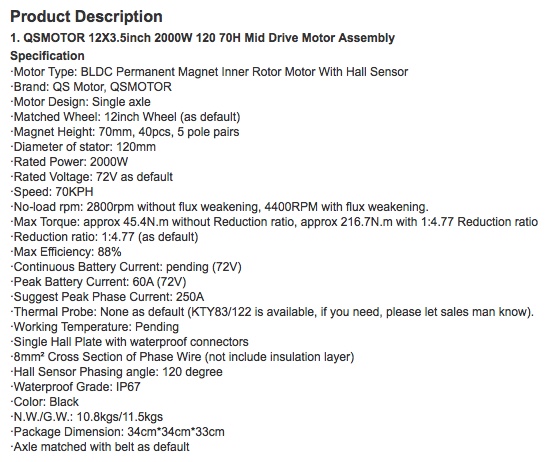

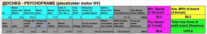

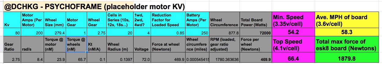

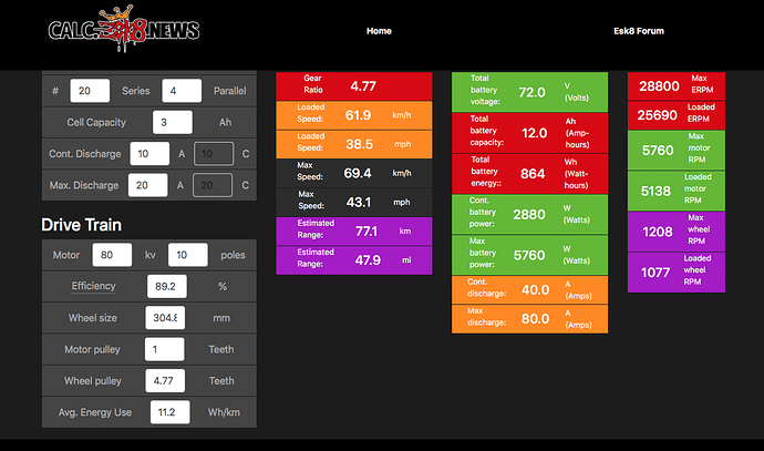

I wonder what is the KV of these QSMOTOR MID DRIVE 2000W.
According datasheet below :

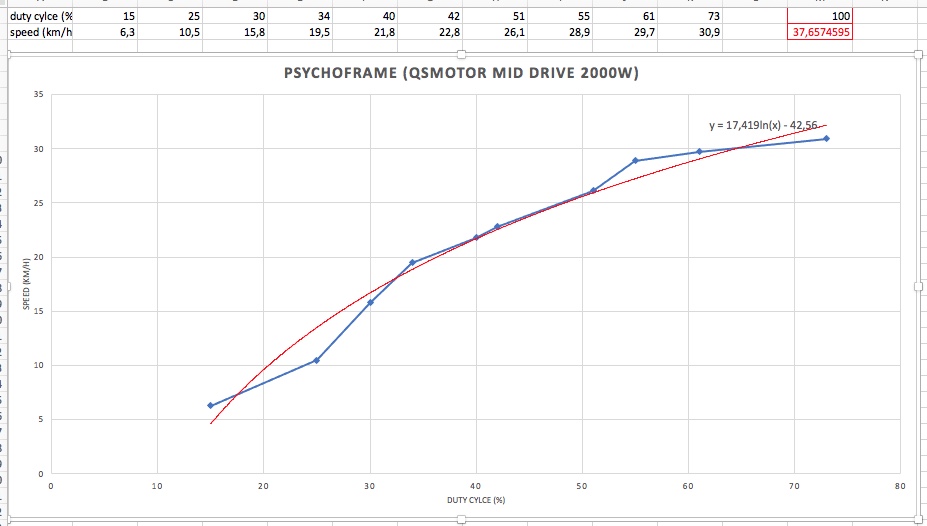

Then KV should be around 80 (to achieve 70 km/h at 72V with gear ratio 4.77 and 12 inches wheels) :
But with a KV of 80 my PSYCHOFRAME should go at max speed 66.4 miles/hour what is 106.9 km/h !? :
I checked my METR logs and at duty cycle 100% that I have never reached I don’t see the thing go at such speed…
I run a 20% throttle curve.
when i had a look at them when jens first used them it puzzled me too. i think there is a way in vesc tool to work it out.
or you could jack up your frame full throttle it and check top speed and use trial and error in the calc.
That thing is next level build. It’s like a compact Monster Truck.
Per their discription of 2800rpm/72v and 4400rpm/72v. The kv is 38kv without flux weakening and up to 61kv with flux weakening.
I think their discription is with 12 inch wheel but they are assuming a tire is included to get the speed they claim.Very strange how they describe their motors.
The motors are designed for flux weakening so thats some untapped potential, not sure how safe that is on vesc.
