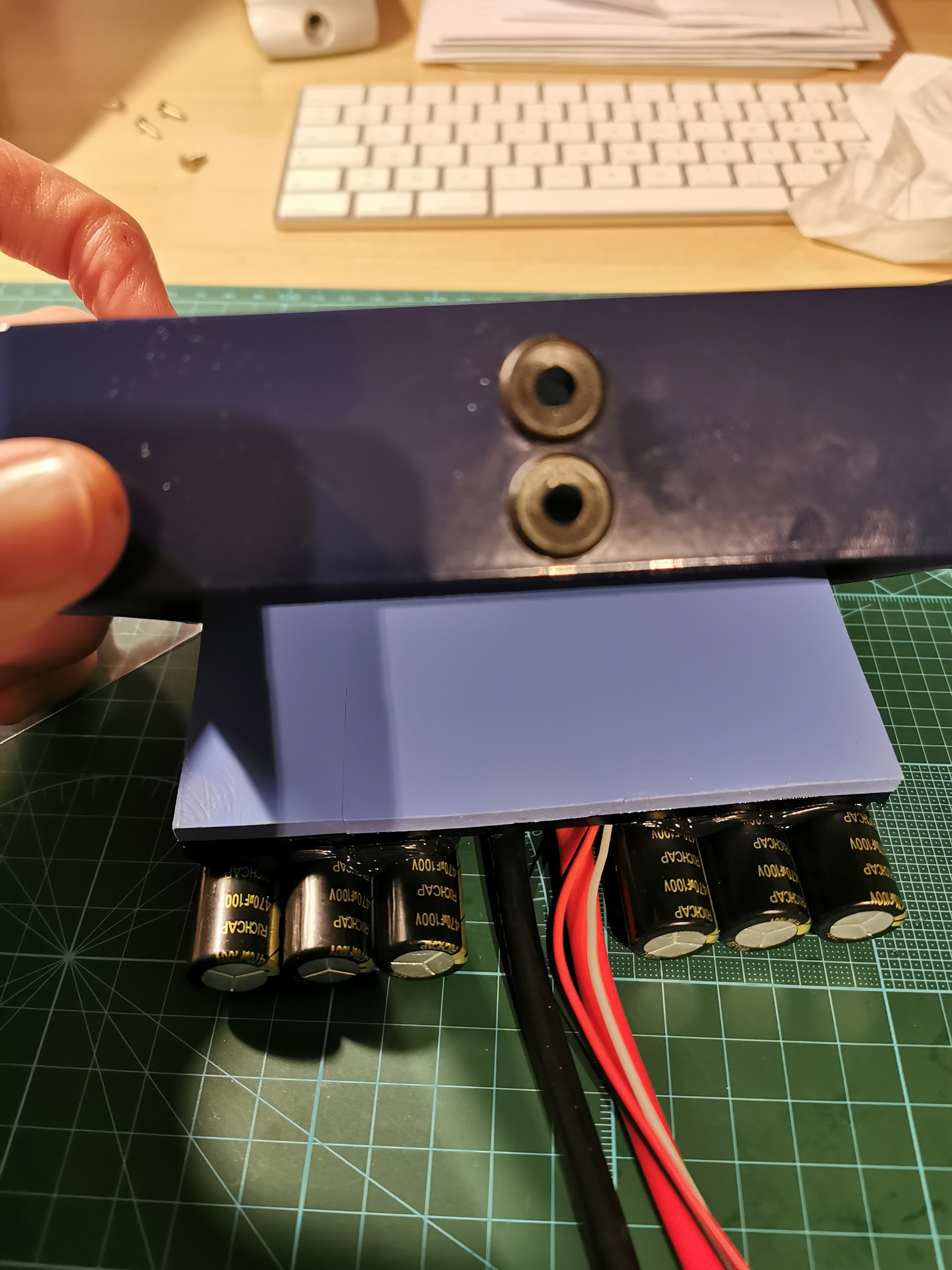

Classy build, man. Love that cabling work. Neat!
Appreciate the close-up on the enclosure mounting too. I’ve been deliberating on a good way to approach that on mine.
