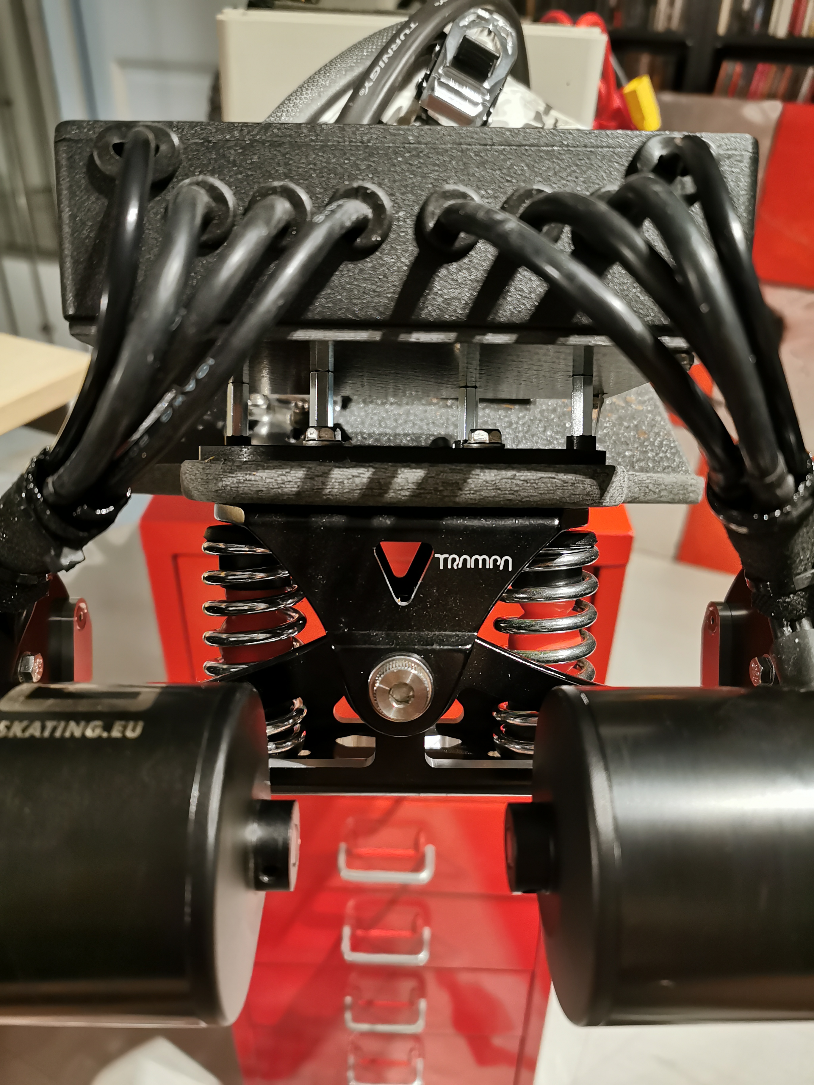

I killed those little “M3 Male Female Anti Vibration Rubber Mounts”. They are shit. I won’t use them anymore and have have replaced them.
Some bolts at the side of bindings scrapped ESC power cables. I repaired them with Sugru and made some improvement, so that HXT 8mm connectors won’t move.
I have to protect top of Lipos because it got scrapped by XT-90 connectors.

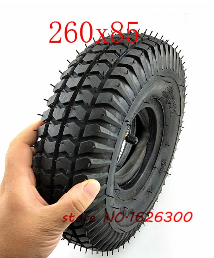

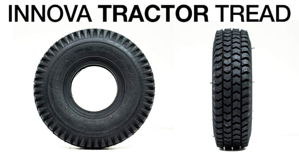

@Trampa (and others) : would you think that 10 inch tractor tyres would have better grip off riding?
Also, what differs with same looking aliexpress cheaper types?

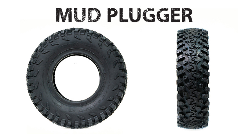

The 9" Mud Pluggers are indeed very nice and provide plenty of grip at a good weight/size ratio.
Cheaper tires may have different, cheaper material compound, have different casing material, TPI rating, Ply rating etc. For a sack barrow these things don’t matter, but at 50km/h they do matter.
Another thing could be compliance, use of nasties etc. In my experience the cheap tires often have a bad smell when you open the package. I ordered quite a few samples over the years and it was always the one thing that I noticed. Some tires smell like tires, others smell different/bad.
Some samples I received had very hard rubber, splitting up after some use (plastic mixed into the rubber).
I can’t tell you how good the Chinese tired hold up at 50km/h because I do not ride them that fast, but the ones you posted do smell good.
I got as well a set of the 10“ which didn’t fit for you and they didn’t smell good :sweat_smile: not horrible, but also not like good tires would smell.
If you don’t need the extra clearance I personally would go with the 9“ mud plugger.
Maybe @Trampa can give a bit more detailed answer, but I think the width between the 9“ and the 10“ mentioned above isn’t really of a big difference.

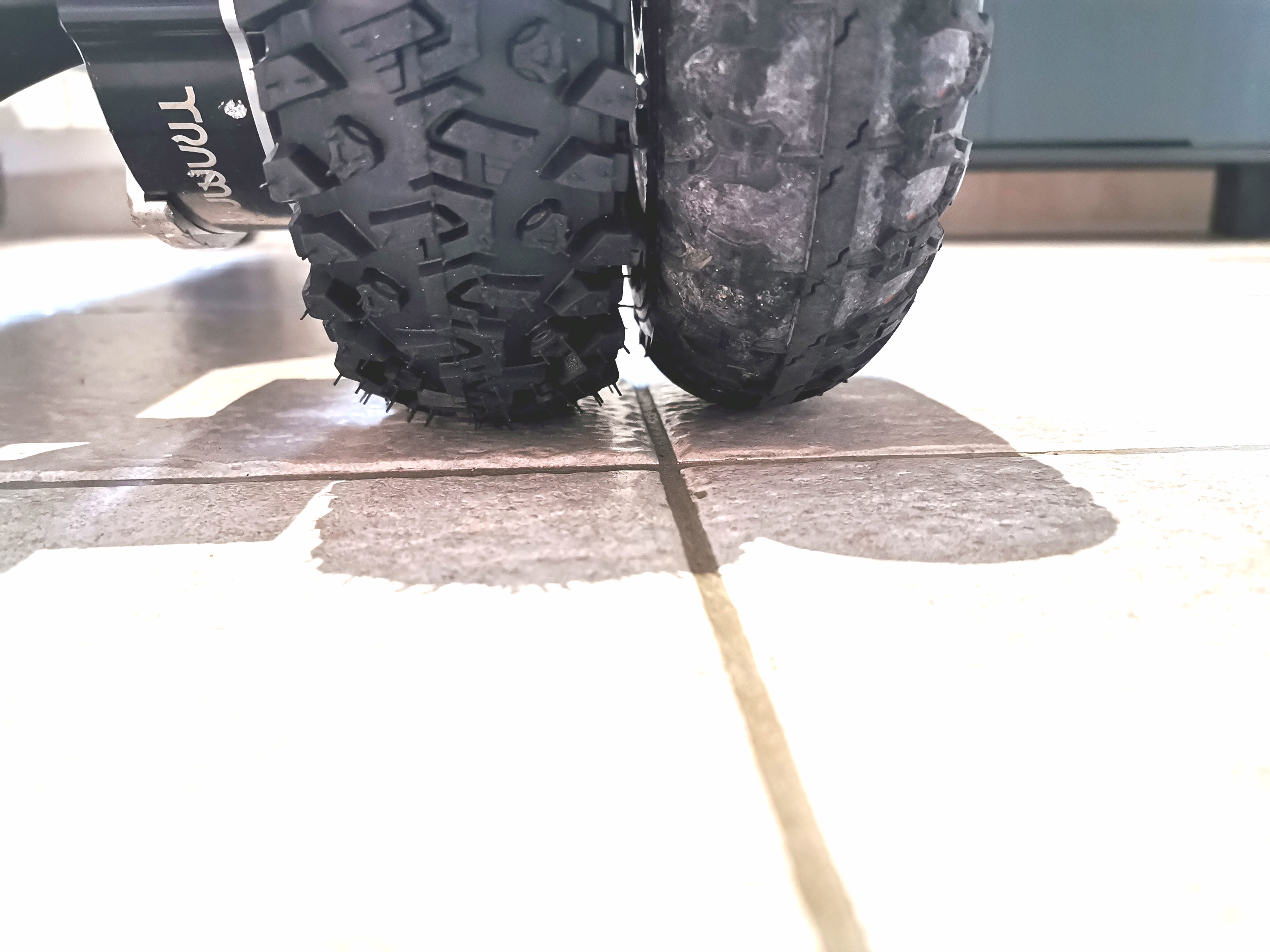

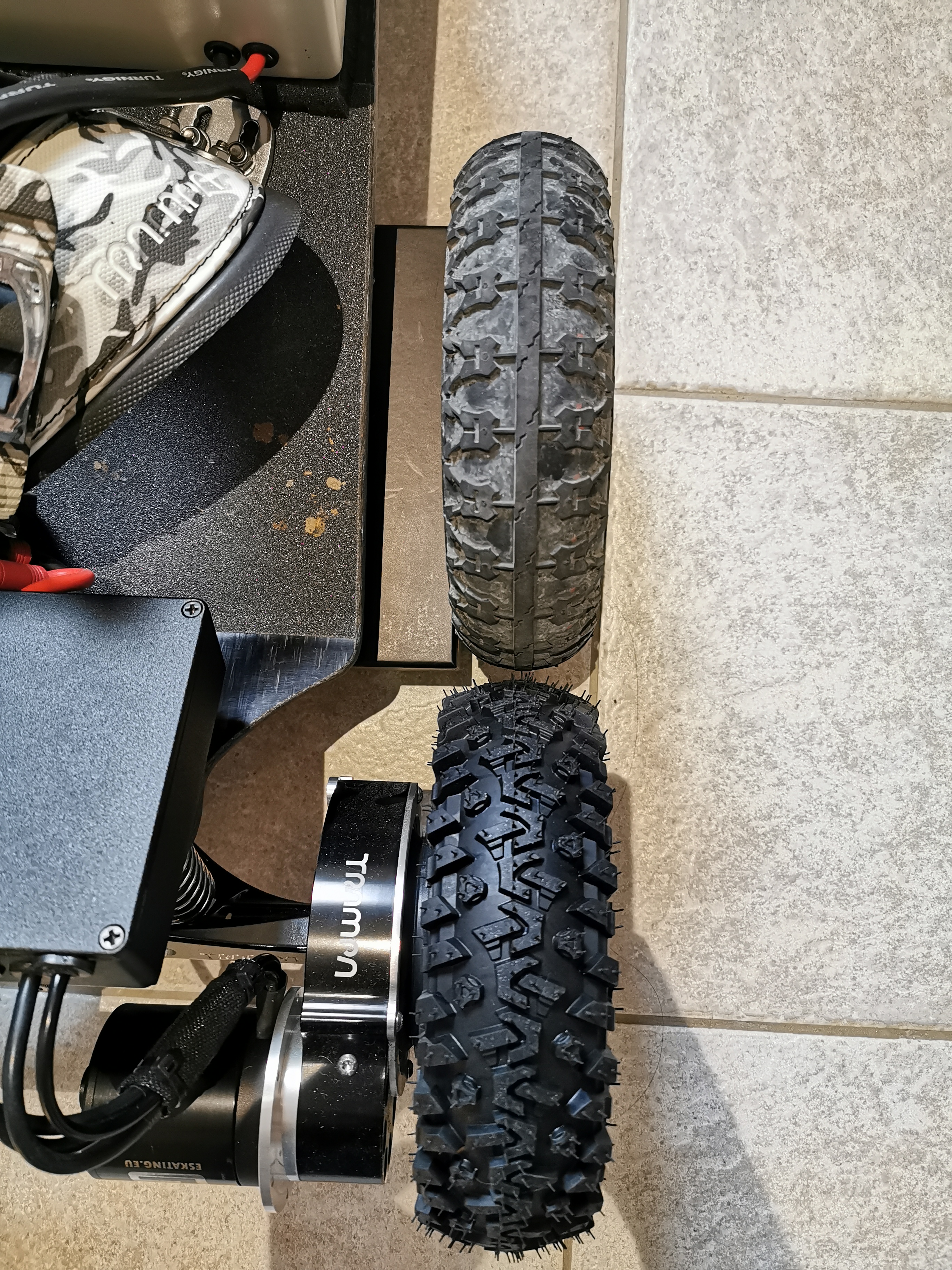

As comparison here the 9“ mbs vs 10“ Ali tires (ignore the blue 8“ :wink:)
My mom complained about the smell of my MBS Vines. And they do smell.:joy:
The Mud Plugger has a very grippy profile that does not clog up easily. I would need to look up the exact weight. The Mud Plugger is definitely a lot lighter.
True! I can not keep that tyres at home, or it smells everywhere
9’’ MBS types look wider than 10’’ Ali tyres?
The 10“ still wider but as you can see on the picture I hope it’s not really much
