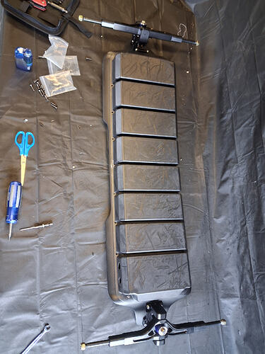

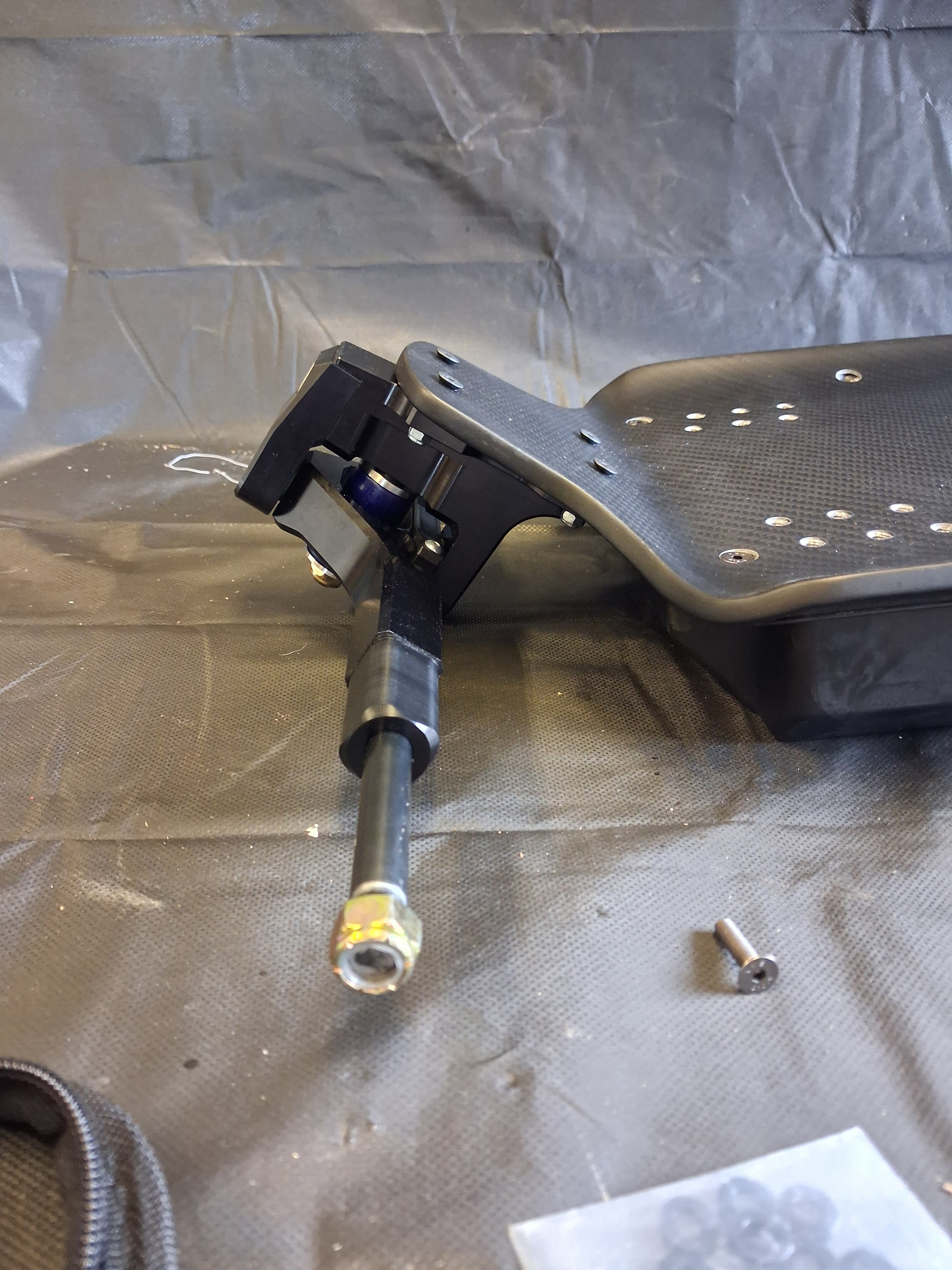

Assuming the deck is 30/30 and the baseplates are 5/15, the intention is for a 35 front/15 rear setup?
Has anyone ever done it backwards like i had it setup? 45 front / 25 rear?
Maybe you should go back to just buying boards…
@jack.luis didn’t you have some setup like that?
Lol fuck you Raf, give an old man a chance :rofl:
5 wedged at front
15 dewedged at rear
Everything fits!
I still think i’ll need to flip that front hanger, but i’ll wait for the wheels before fucking with that.
Thanks everyone for humoring my stupid ass :rofl:

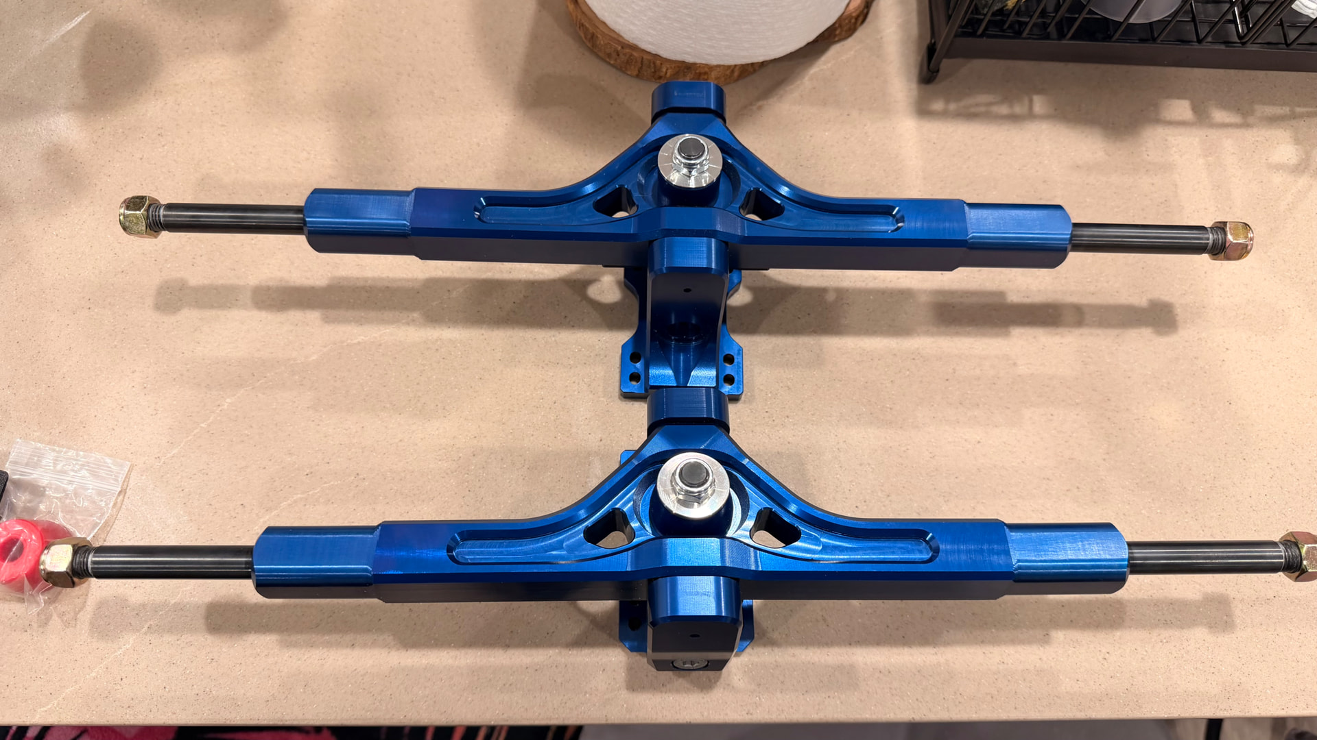

Yes I do I wanted the shortest wheelbase possible on rocinante
Don’t feel too bad. I had completed examples in the garage with me and still finished setting up the build without realizing his trucks were swapped.

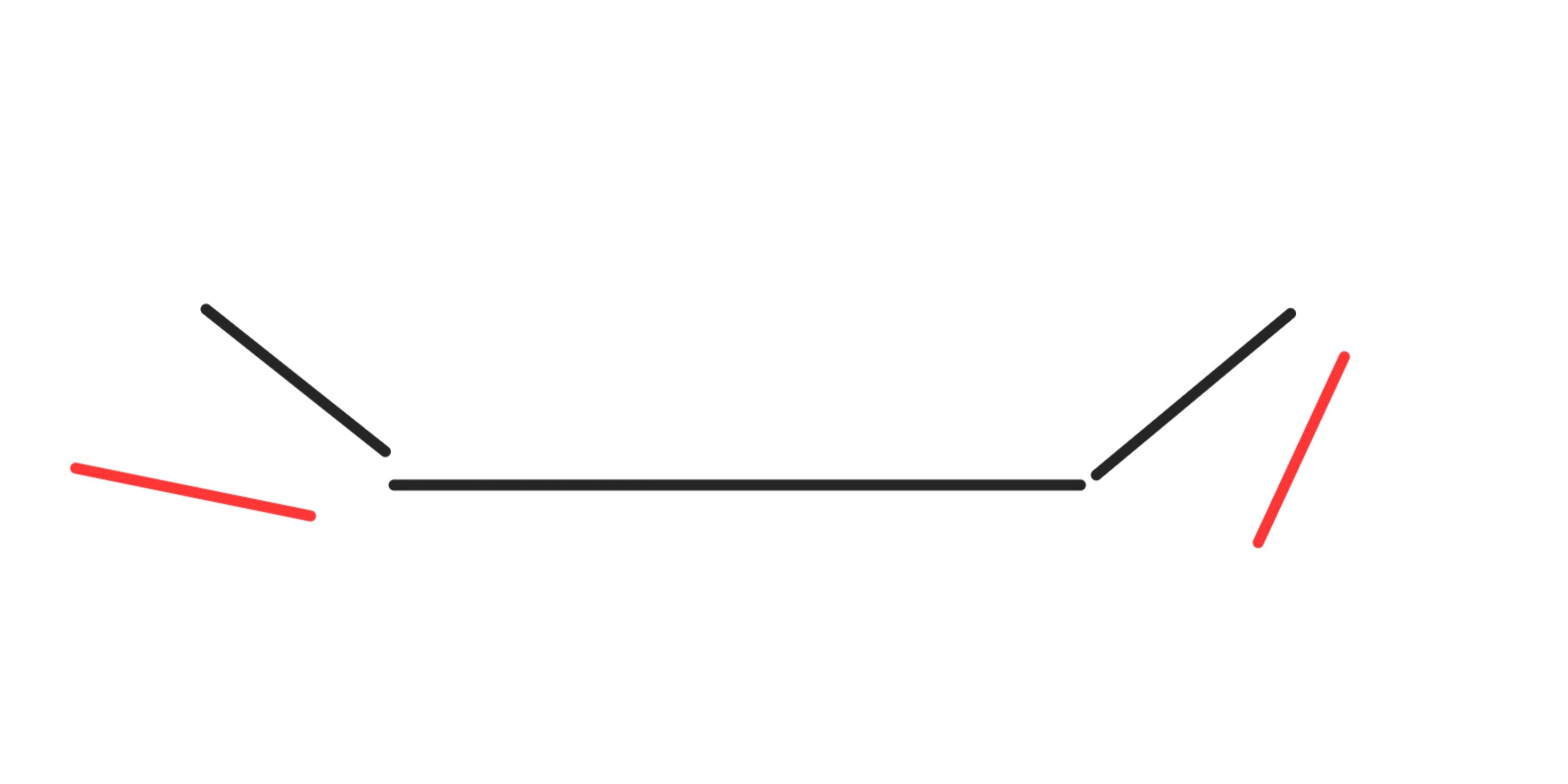

Here’s a shitty drawing, gonna exagerate it a bit.
Your rear hanger (left red) should be closer to being parallel to the ground. Your front hanger (right red) should be closer to being perpendicular to the ground. See if yours look like this from the side.

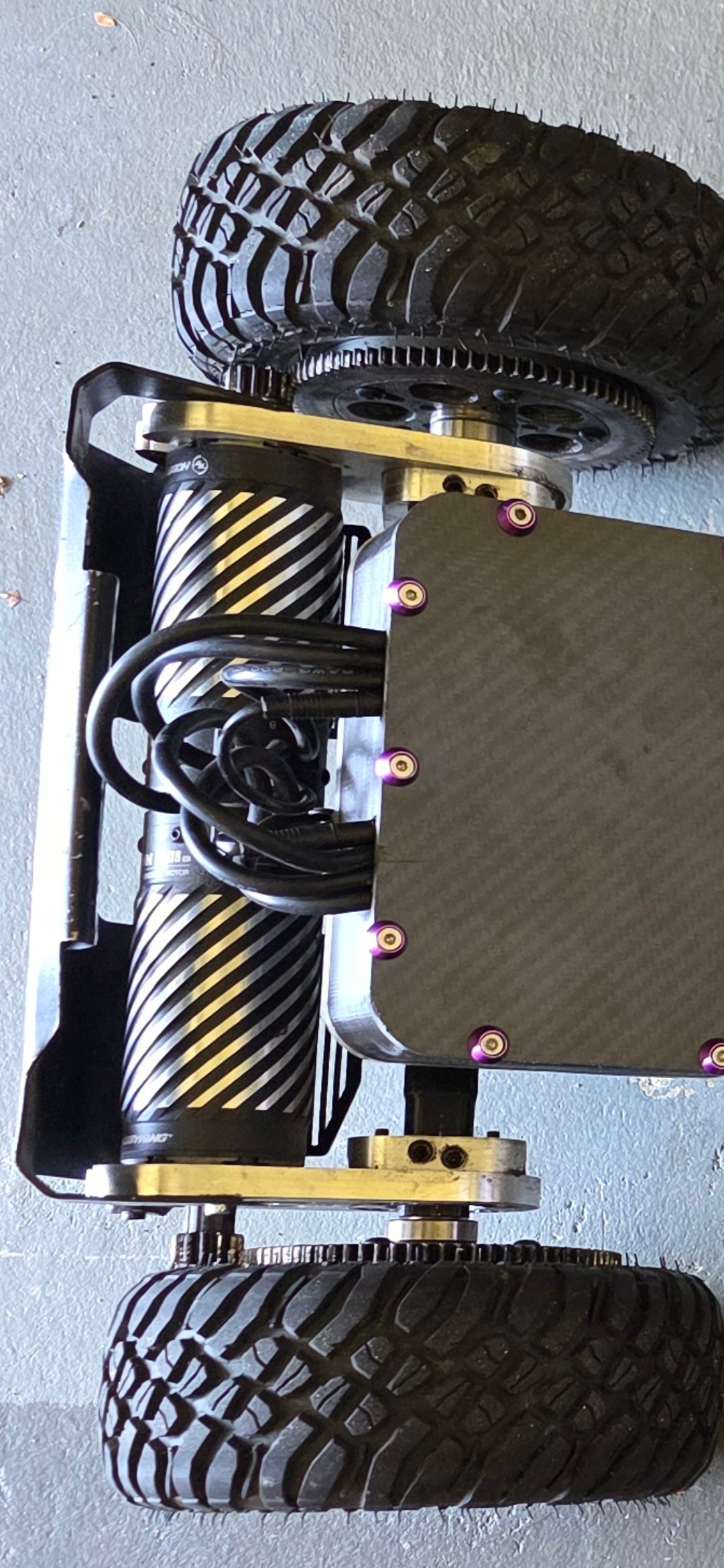

Dual 58118 motors on 240mm duality hanger.
If interested, i’ve messed around with the 3D-printed motor mount protective side guards and extended them inward to protect parts of the motor. If ur interested in putting that in place of the stocks
