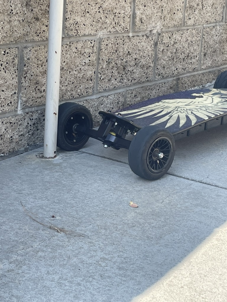

I’m getting a hellhound from @tomiboi with extended noses in order to get inline with the axles. I’m going to pair it with 210mm hangers. Longer and narrow is better than shorter and wider imo.
It will work with 6-8 inch tires. The edges are beveled to reduce scraping on 6 inch tires. It’s going to have slots for the queenpin for easier bushing swaps. It’s pretty similar to @Dinnye board. The layup is a little different, more details on that later. Should make for a good street and/or track board.

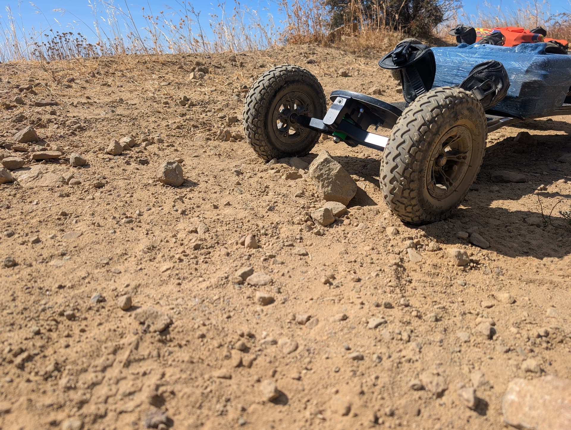

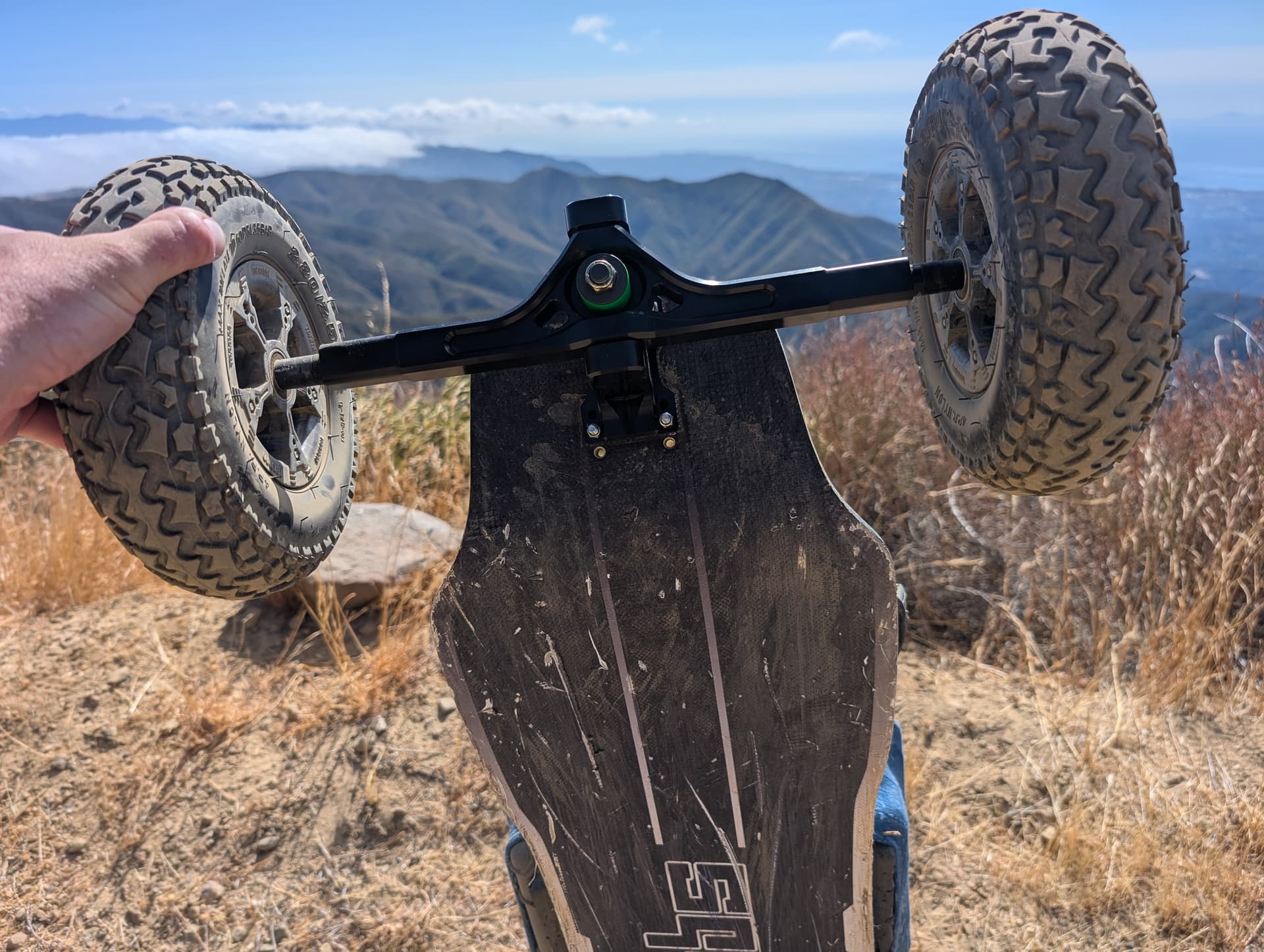

On flat deck trucks the offset hanger is 60mm axle height which is pretty much the same height as rkp trucks. (Technically you can flip the front offset hanger but it’s not recommended since it pushes axle forward a bunch). Centerset is 50mm axle height and also has 10mm less baseplate to ground clearance. For reference the lowest point on the standard offset hanger is ~28mm. So on something like 125mm wheels the offset hanger is pretty much a must for ground clearance. For 6-8 inch tires either would work.
It’s worth point out that the rear is 50mm axle height. So I include a 10mm riser if you choose the standard offset hanger up front. Centerset would match the rear height.
If you’re not riding on the track it would be hard to tell the difference between the two imo but the lower ride height is nice if you can spare the ground clearance.

I’m going to pair the custom hellhound with the new extended front baseplate for max ground clearance. 210mm offset hangers, front hanger axle end inward, rear hanger outward for motor clearance. 6384 rear and 6355 front. (If I was going any bigger up front I would need to switch to the non extended baseplate and have front hanger outward). Deck has custom cutouts to clear the narrower hangers.

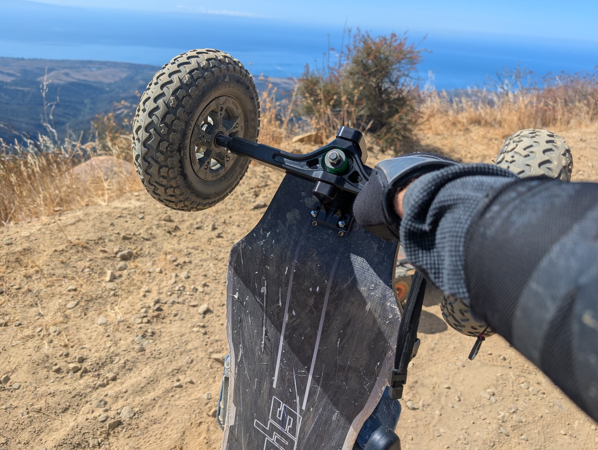

Flipping the front hanger inwards would give you 20mm additional ground clearance. So about 5mm less clearance with 6 inch tires than with 8 inch tires and the hanger outward. Flipping the hanger inward would reduce the wheelbase, that’s why I recently made the extended front baseplate to match the wheelbase and still have the additional ground clearance… Extenders long enough can probably accomplish similar.

This extended baseplate works great. I took it out to one of our rockier rides today and not a scratch on it. No noticeable difference in ride height or wheelbase. Nicely done @Titoxd1000 !
Cool man! I think the extended baseplate does become the new recommend setup due to the extra ground clearance with not much or any real downsides over the original 5 degree baseplate.
