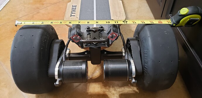

On BN310 channels using the lacroix bushings I had about 29 degrees max articulation, so channels can have a lot of articulation as well although it’s quite uncommon (I had to use risers so the hanger doesn’t touch the deck too early).
In comparison Dualities have 33 degree max articulation without lean stoppers and 25 with lean stoppers, however the bushings have a different type of compression which they like more.
Also on the BN channel truck the bushings are closer together than standard matrix ii geometry, which definitely plays part at allowing more articulation. The bushings certainly weren’t happy though, I had a good amount of preload on them and that plus the lot of deformation caused buckling which is obviously not ideal.
That alone probably explains my experience then.
That would explain a difference in “turnability” based on bushing duro/preload, but it doesn’t necessarily change the lean to turn ratio of dualities vs channels.
I guess a better way to ask my question would be “is the lean-turn ratio of dualities fundamentally different than channel trucks.” It sounds like the answer is no, and my experience on Jackson’s board was just a high-angle truck setup.
The lean to turn ratio in the case of any truck where the hanger pivots on a solid axle that doesn’t shift around is always just going to be dependent on the angle of the pivot (baseplate angle)
On something like an RKP or TKP, there might be some miniscule difference due to the deflection of the pivot axis with different bushing duros or rider weights, but even then - it’s still generally going to be dominated by the baseplate angle.
Any slop in a truck will change the lean to turn ratio. RKP trucks for example have a lot of slop. Therefore you need to run 5-10 degrees higher angles on them to compensate… Duality and channel trucks theoretically have the same lean to turn ratio. Although any slop will change that by a couple of degrees. I don’t know how slop free channels are but Dualitys are pretty good in those regards. That might explain this
This is only a small change, most likely what you felt though is having really high angles (with minimal slop) on Jackson’s board.
It’s even worse with enclosed BN drives lol
And urs is 4wd so… Yeah lol
