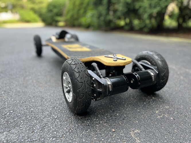

I have the 270mm hangers , jump drives and MBS XL Pro’s and they fit fine
:clap: :clap: :clap:
Loving them so far. Currently running Venom 93A HPF tall barrels in front, Riptide 93A Krank tall chubbies in rear. Nice combo for street riding. No wheelbite :ok_hand:t2:
Build looks clean. Good to hear about the no wheelbite… I’ve been impressed by the venoms so far, nice mix of carvability and stability.
@hatman Can you share some pictures of the drivetrain mounted. You didn’t have issues with axle nut thread engagement or bearing not seating correctly? I wonder if the regular rockstar hubs and the pros have different spacing needs since the pros need the multi hub wheel adapter.

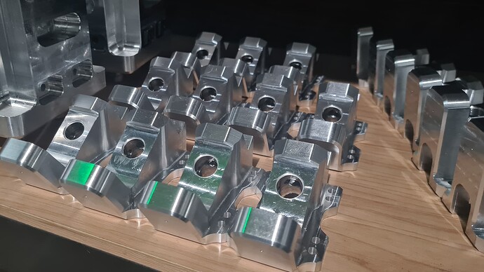

I originally intended to do the discounted price for the first ten orders, but I have extended that price for the complete first batch. I only have a handful of 300 hangers left from this batch that I will add to the website as I assemble them.
I just purchased a 1000 lbs of aluminum and I am working on restocking 240mm and 270mm hangers along with flat deck setup. I will have a 10mm axle option for this batch. Estimated time of availability is mid-September. Thanks everyone for your continued support.
