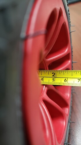

@Titoxd1000 do you know if the current axles long enough to fit the m1-at gear drive and hubba hubs or the linnpower slicks?
I think so. The axle is 65mm long. @Dinnye had enough room to run an additional 8mm spacer with the m1-at drive for 6395 motor clearance. Hubba hubs are like 3-4mm wider than mbs wheels. And @ShutterShock is running the linnpower slicks I believe.
(The jump drives and hubba hubs combo needs longer axle)
Yeah I’m running BN drives with the linn slicks on the Next rims from linn

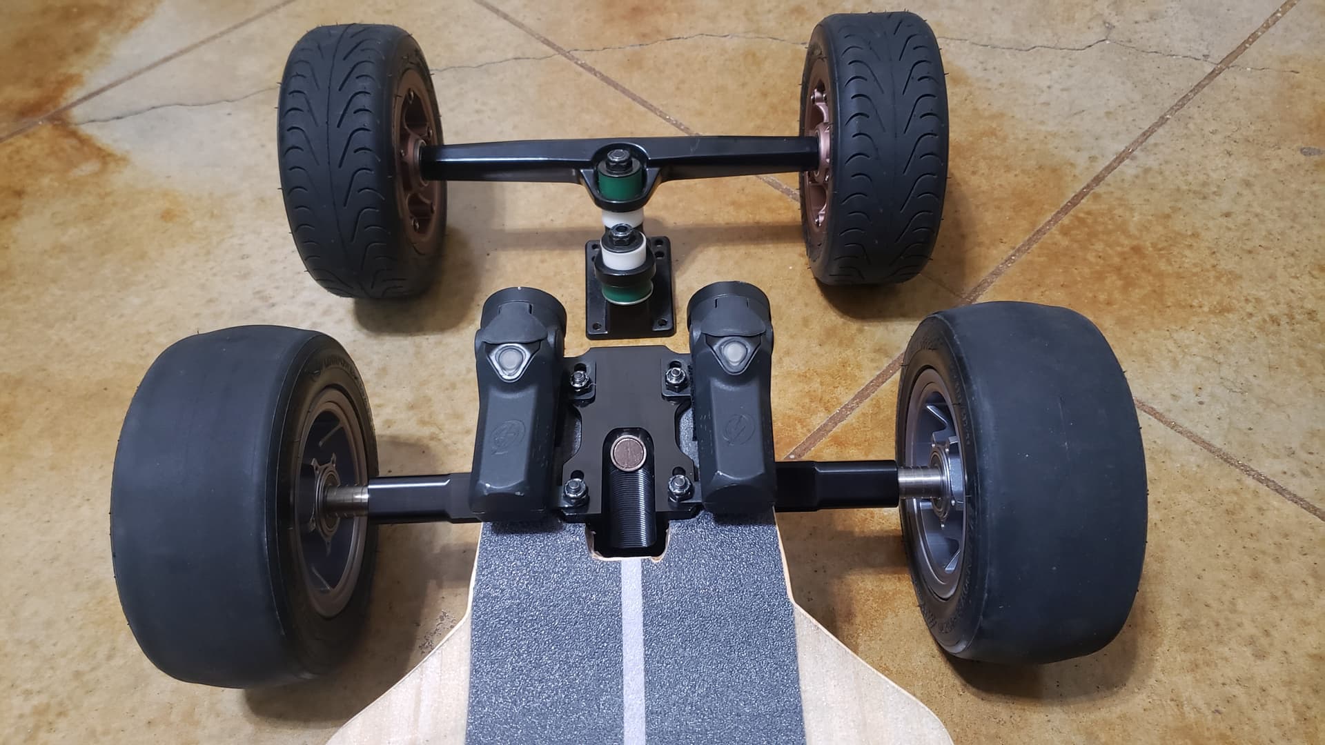

Thx for the pic Tuck!
is that blood?

No, it’s grease.
The blood sacrifice happened elsewhere

Looks like I need to start fitting my spacers now. I know that the silver Linnpower’s are 22mm, where as the black MBS spacers are 22.5mm wide.
