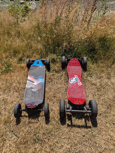

Believe the hype on these things. I just got my flat deck set up and running. I had to drill out a set of new school pattern holes on my Deathtoll deck so I could avoid wheelbite, but that wasn’t a big deal. FYI Voyage Megan baseplate accommodates new school pattern, so I didn’t have to shift it around or do anything else weird. Newbee 4GS drives mount up easily and have plenty of room with 6485 motors.
These things are incredibly robust. I have zero worry about ever breaking anything on these haha. I need to do some minor tweaking on bushing tightness etc, but my first impression is :open_mouth: :exploding_head: they just feel so good. The carve is dreamy and felt super stable up to whatever I hit on my test ride. Great work @Titoxd1000

Nice bro, good to hear. Cool photos btw.

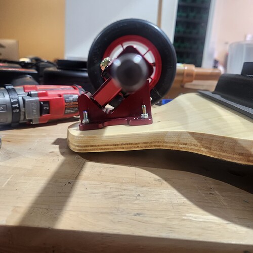

Front
Rear
Here are a few axle possition pics of the 40 degree base plates ln magnetic front is wedged 12.5 degrees and rear is dewedged 12.5 degrees
We have both 8 and 10mm axles
It’s hard to tell from the photos, it looks like the axle might be 20mm off center. Can you get a more accurate measurement base on this.
After looking more closely, on my current setup, the rear axle is 45 mm in front of the center of the deck mounting area and the front axle is 25 mm to the rear of the center of the deck mounting area. Distance between front and back deck mounting holes for each truck is 65 mm. Additionally, the distance from the bottom of the deck to the axle is 70 mm for both trucks.
