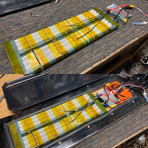

You can check out the exact layout & dimensions on the source files (just updated), but the cells are positioned in a way that the PCB extends underneath all of the cells, but doesn’t extend into the deadspace from the radius. Also important to note that this particular 12s4p 21700 flexPCB design was built specifically to fit inside the Kaly 2.0 enclosure, so the dimensions are specifically constrained.
Here’s pictures of a 12S4P 21700 using the Kaly 2.0 PCB (which is what the DRI version is versioned from)

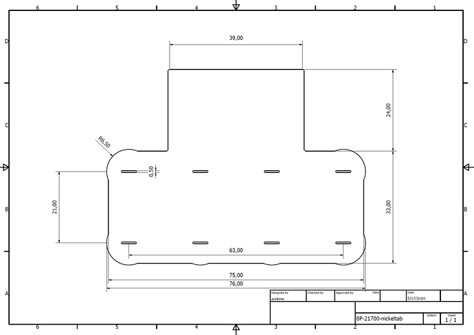

Will the 12SP4 21700 work as 12S8P, with the nickel from the bottom P4 overlapping the top P4?
Our PCB-Only kit is the only version of the 21700 FlexPCB that is available. We do not have the comprehensive kits in yet.
In theory you could do that, but we have both 4P & 8P 21700 Nickel tabs incoming for these kits.

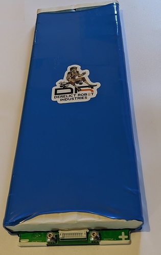

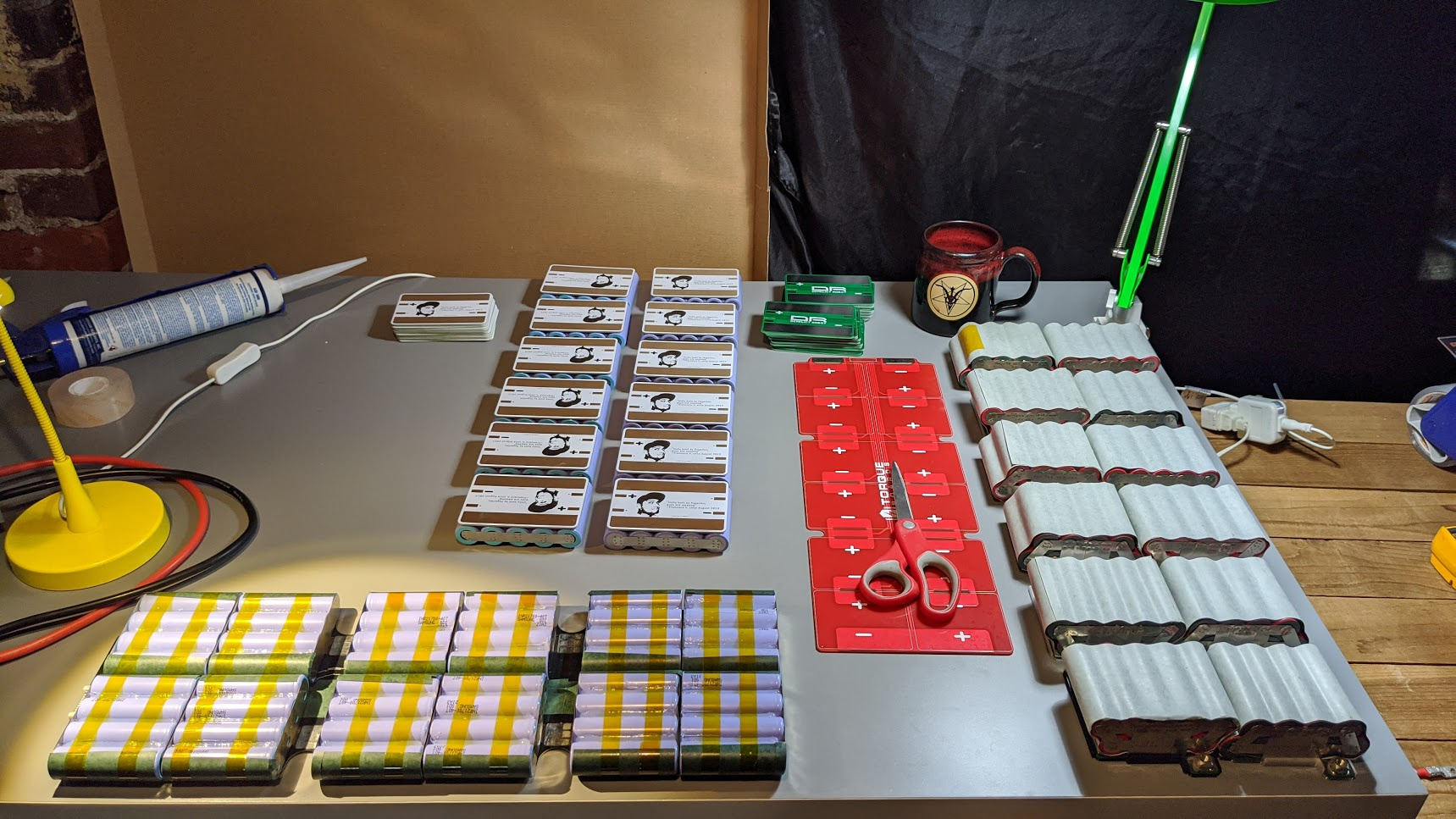

Batteries? In our shop? Blame @BenjaminF entirely, because that odd duck has been busy working away in the DRI dungeons to build up a small stash of prebuilt 12S4P 18650 packs based on our popular FlexPCB and CompactPCB kits!
Priced at $399.95 w/ 12S BMS or $379.95 without.
Running a special on the first 2 of the VTC5A packs sold, use Discount code: GETJUICED-20
Right now we’re only offering these for Domestic shipping until we get a few more things squared away for international shipping options.
Feel free to bother Benjamin relentlessly with any questions you might have!
All batteries made with love, both metaphorical and physical :smirk:
Organic, fair trade, free range, cruelty free, non-GMO, gluten free, parabin free, dairy free, low-calorie batteries. Get 'em while they’re hot, and then I’ll make some more. My plan is to keep these in stock, though no promises.
What would y’all like to see from these batteries moving forwards? The DRI workshop has a large stock of VTC5A’s earmarked for these packs, so those are likely to be built out first. But do y’all have a cell preference? BMS preference? If you have a suggestion for how I can make these into something youre more likely to buy, I want to hear from you!
