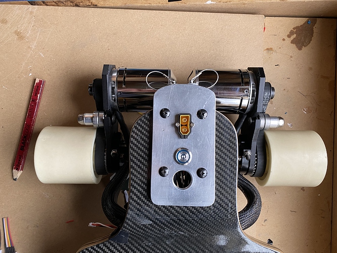

I did a bit of both. Clamped it loosely around the xt90, held in place and drilled the plate for it. Then tightened it all up. The little screws on mine didn’t bolt through onto a but but tapped into the plate (they are tiny).
I used one on each side and it isn’t going anywhere.
They do clamp tight tho, and if you overtighten they can bend the connector and make it even harder to plug in the xt90s. You can see the connector squeezed in this pic.

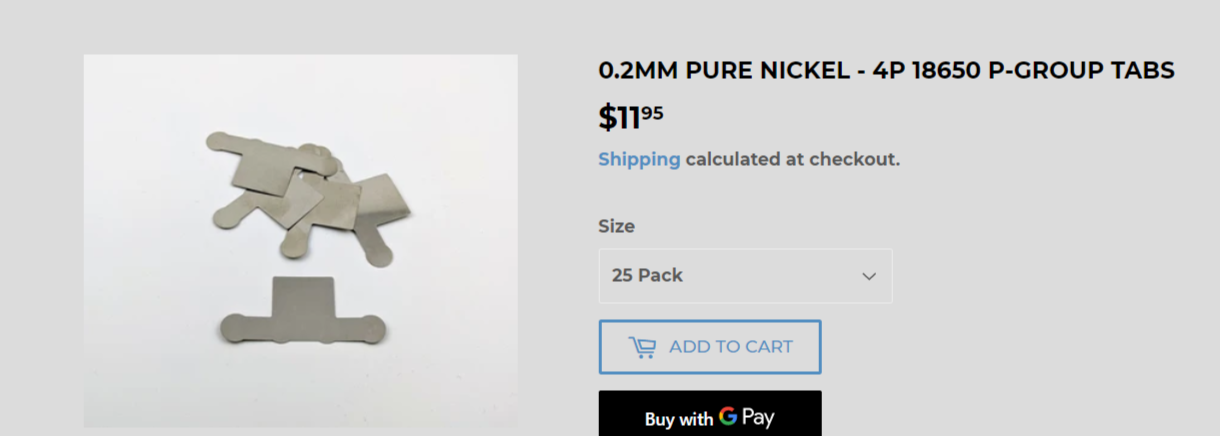

Pure nickel strip would be a great addition to the site. Especially the extra wide stuff. Would make using your p-group pcbs easier.
edit:
These but for 21700 cells

This week only: running a Buy One Get One 50% Off Sale on all 4p 18650 Nickel tabs & FlexPCB Kits.

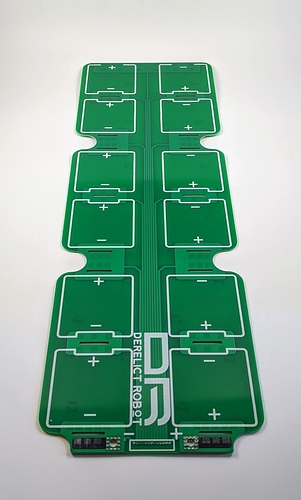

Mr. Robot dear sir… is there ever the possibility of having a scrunched version of the PCBs (especially the 21700 model) for those of us who are very space deficient?

Yes. There will be more options for the 21700 when the 4/8p 21700 nickel tabs arrive (ETA 3 weeks).

My hummie deck was a first batch model with a 140mm wide cutout, which was very inconsistent across its length (think +/-4mm at narrowest/widest points). At the point when i was test fitting, neither the FlexPCB nor the CompactPCB would fit in my 140mm cutout. I am going to stuff a 21700 pack in here, so I promptly grabbed my angle grinder and opened up the cutout by a lot.
My understanding is that newer hummie decks have a 145mm cutout that is better machined, but i have not had one in my hands to confirm. Perhaps @Hummieee can. If that is the case, then the CompactPCB should fit, as it is 144mm wide when assembled properly. Its going to be tight though.

The CompactPCB is exactly that, for 18650’s. My understanding is that it cant really get a whole lot more scrunched than that.
