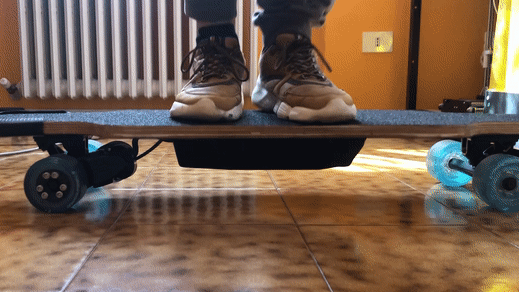

Few weeks ago I completed my first ever DIY build and here I would like to list my new doubts/problems:
Deck
I made the deck several years ago with birch sheets and a fiberglass kit (for longboarding).
I really like the aesthetic result but it’s extremely stiff which makes the rides quite uncomfortable also because of the roads of my Italian suburban town that aren’t great.
IMGs
GIF
stiffness
Solution (?) →
I was thinking about buying a deck from a company producing esk8 also replacing the enclosures according to the new deck. I checked the deck for the WowGo 3X and its enclosures where I’ll fit my electronics and my battery and they seem pretty good.
Do you think is it a good idea?

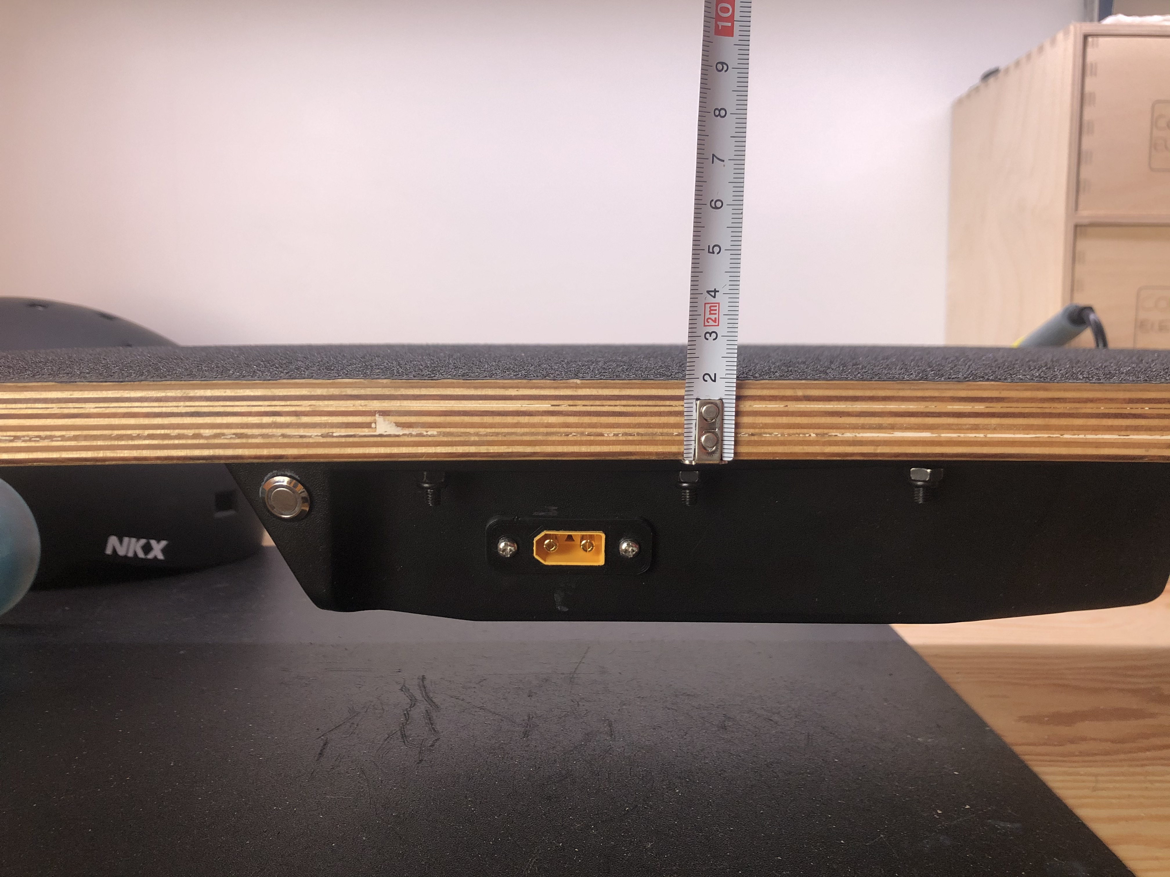

One question: how much space there’s in the Wowgo 3X ESC enclosure? I should put a Flipsky Mini FSESC4.20 , the anti-spark switch and the loop-key switch. There’s enough space?
Thank you, I’ll reach him out!
They are 2 separate enclosures. One for the battery and one for the esc. The connection between them is made with a cable that’s routed through a channel in the deck
about this much. (picture is before i put everything in)
With some slight modifications i was able to fit a unity, a metr pro CAN and the flipsky vx1 receiver with my own printed case
depends on the size of the esc. If it’s smaller than the unity, no problem.
Some of the depth of the enclosure is taken away by the integrated heatsink which is quite nice to have.

i should have one somewhere. Gimme a sec.
outside and inside
My foam vs the one that came with it
i removed the foam pieces inside except for one and fit a 10s2p 21700 pack
