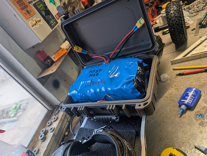

-Battery is DIY 18s4p of P45B cells with JBD smart BMS (charge only)

The battery is my first build that isn’t 12s. It’s kind of pussyfooting into higher voltage but the layout works perfect for the enclosure so that was the major deciding factor.

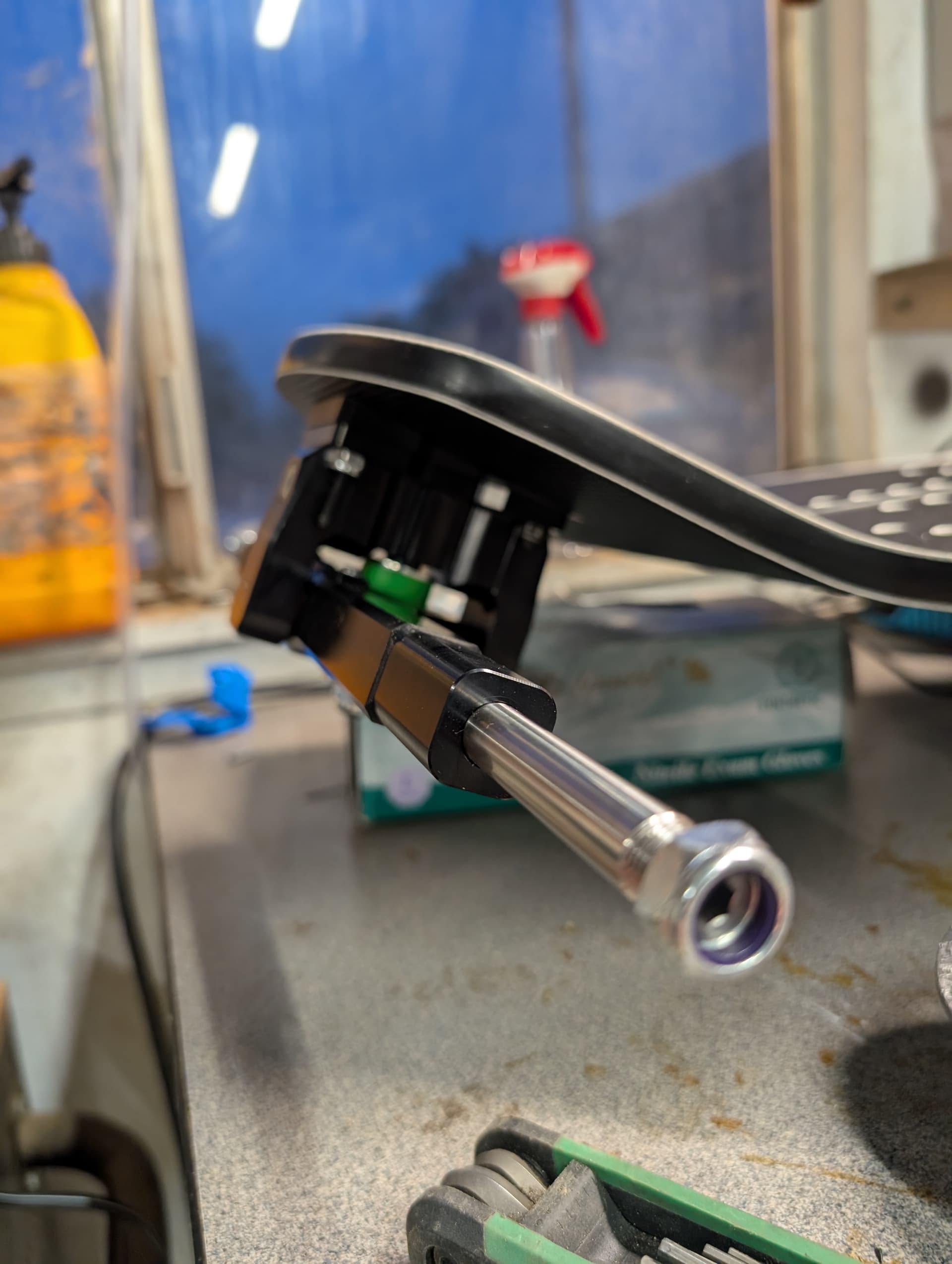

Mounting the Trucks
@Titoxd1000 suggested that I mount the front hanger in reverse to increase ground clearance. This is probably great advice, but I didn’t like the look with the front hanger not matching the back. If this causes me to break a truck and have to order a new one it will be my own dumbass fault for ignoring good advice.
I did want to do something to help with clearance a little so I de-wedged the front base plate and increased angle in the back with the included 5* wedges. This combined with 9" pneumatics should give me plenty of clearance for the trails in mind for this board.

Per advice from you guys, I decided to build an 18s pack. The 14s battery described below now lives in my chain drive.
Sooo, first 14s pack! Also the first time using the Malectrics spot welder at the advice of @Skyart. This was definitely a good buy. My brother and I were able to get two packs built in the time it normally would have taken to build one with the old Sunko. I didn’t get many pictures of the build, just the general layout and part way through welding the series jumpers on.
So now that the battery box is mounted, along with the trucks, grip pads and bindings, it’s going to be a waiting game for the Solo V2s, 6495 motors and my straight cut gears. I don’t want to mount the jump drives until everything else is in to make sure there aren’t any angle issues. For now this thing will sit on the bench taunting me, but all good things are worth waiting for! Happy to hear anyone’s thoughts or criticism.
Cool looking build and it’s set to perform fantastically with some of those parts, one thing though don’t we normally add angle in the front and de-wedge the back for stability, more turning in the front less in the back? I could have gotten something wrong thought
I think you’re right. My hope was that adding 5* in the back would compensate for the 5* removed from the front but I could be way off base. I haven’t even stood on this thing yet, but just applying pressure to the deck with my hand makes me thing it will still turn better than Airs would, even with the angle changes.

Ok, you guys talked me into it. Decided to build an 18s 4p using p45B cells. The 14s that I had originally planned to use for this now lives in my chain drive. This is the first pack I’ve built without making a bunch of copper jumpers and it was much easier to put together. Big thanks to @Pecos and @Skyart for the advice.
It went a little slower than it could have because my right elbow is immobilized in a splint, but with two fully functional arms and a helper the next one is going to be a breeze.
Would you trust a battery built by a one armed man?
It really wasn’t too bad using the Malectrics without moving my elbow. Tear test on some spare cells went well so decided to go for it.
I ordered an LLT BMS, wired everything in and was getting bad readings on the first two P groups. Checked voltage at the JST connector from each P group back to the first wire that lands on the pack negative. Everything was testing right so no clue what the deal was with the BMS.
Only ordered that thing because I had given up on the Daly I ordered ever actually showing up. Ironically it came in the mail right after trying to troubleshoot the LLT. Removed the LLT and installed the Daly, now everything is working as it should.
Pack is ready to go. Just need motors and Solos to show up and this thing will be ready to go.
